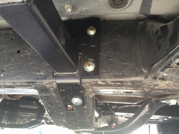

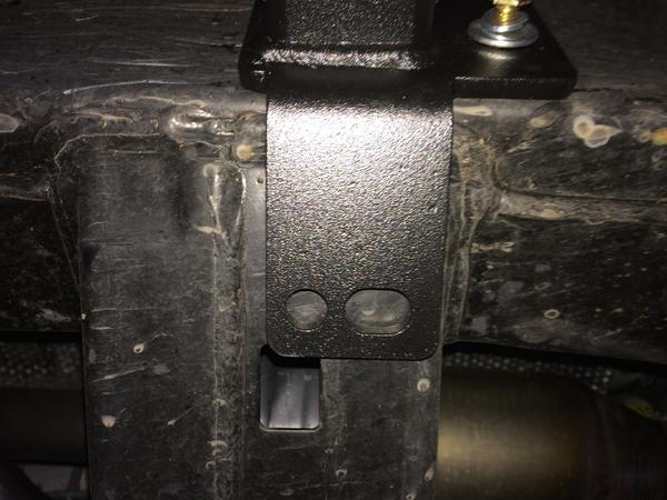

So I got my sliders in and they look great. Just need to install them now. So I am doing the passenger side first. I noticed there is no hole for either of the two holes on passenger side front where it connects to the cross member. Are these optional or do I need to drill them? There is one on the driver's side and the other hole is optional as per the instruction but there is nothing in the instructions that mention the passenger side except that there is not a "threaded hole" and a extra 3/8 bolt and stick nut are provided. Is that assuming there should be a hole there, just not a threaded one? I checked behind it and it doesn't seem like there is enough room to drill a hole and put a bolt through there.

No hole on that side. You'll need to drill one and there should be an access plug close enough to run a stick nut. I still need to do the same for that one.

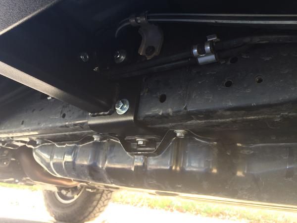

All done! Not too difficult. Pulling the lines away from the frame was super easy. Just unbolt the two bolts that hold the lines in place and rails go right underneath it! I highly recommend making sure your gas tank is empty. I had half a tank and was like, "eh" and paid the price for it. It made it a lot harder to bolt the strap back in place. Only had to drill one hole on the front passenger side, did not drill the optional holes. At least not yet. They look great!
Front passenger.

I just installed my sliders today, used a lot of your thread as reference so thanks! However, when I unbolted the KDSS lines to slide the slider behind them, they shifted in a way that I can't get the bolt to line back up with the original threaded opening. Did you have a similar problem? I'm considering leaving it as is because of the gusset plate holding everything together
