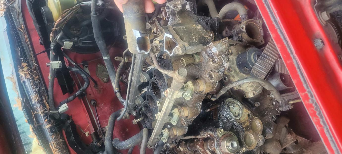

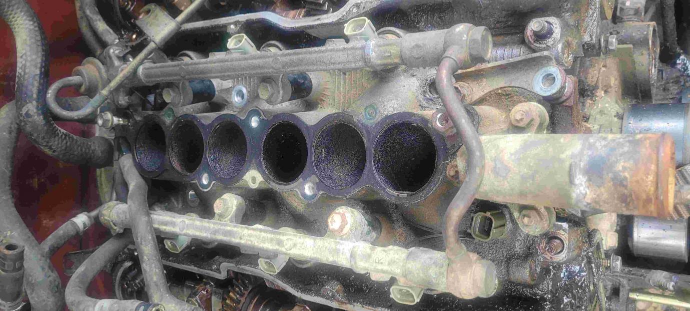

So I'm doing head gaskets on a 5VZE and have the 4 nuts on the corners and all 8 bolts out and everything that needs to be disconnected, Trying to rock the intake side to side and this this is not moving double and tripled check that i have all bolts out and this thing is on there , Any suggestions on what i can do to get this loose , Thanks John

I may have worded it wrong the 2 upper plenum pieces are off the intake with the fuel rails is what I'm having trouble breaking loose

Ah.. Ok.. Good impact wrench with the proper socket. Those are 6 point sockets and will provide the torque required to break those fuel rail loose so you can remove it. :-)
Been a while. But I had a issue as my oem gasket rusted out (coolant ports) and caused the studs to rusr/have a build up. It was a pain to remove. I used a dead blow to tap the coolant hose neck up (towards the hood) and it finally moved.
what sucks there's nothing there to really get a pry bar under either​
i soak the hell out of the 4 studs with some penetrating oil so ill let that sit till i get home from work and see how that pans out. LOL was watching Timmy and a few others and all their intakes came right off I'm like i had to miss a bolt cuz this thing is on their SOLLLIID , NOPE all bolts are out now I'm like SHIT. LOL
Oh no... The rust belt chrome got you. Another thought is if you can induction heat the studs several times. What type of penetrating oil are you using? Worst case use wood and the bump it all around to try to break the seal. Wood block to the radiator inlet to slightly pry may get it loose. Granted, it may snap that neck off too.. I thought you were trying to remove your fuel rail at first...
I use Kroil and pb blaster...
soak and heat is how I get the rusted things. To really heat though you may have to pull the fuel rail and injectors out for safety and it make take a few days of this to get it off. You have any of it loose at all?
