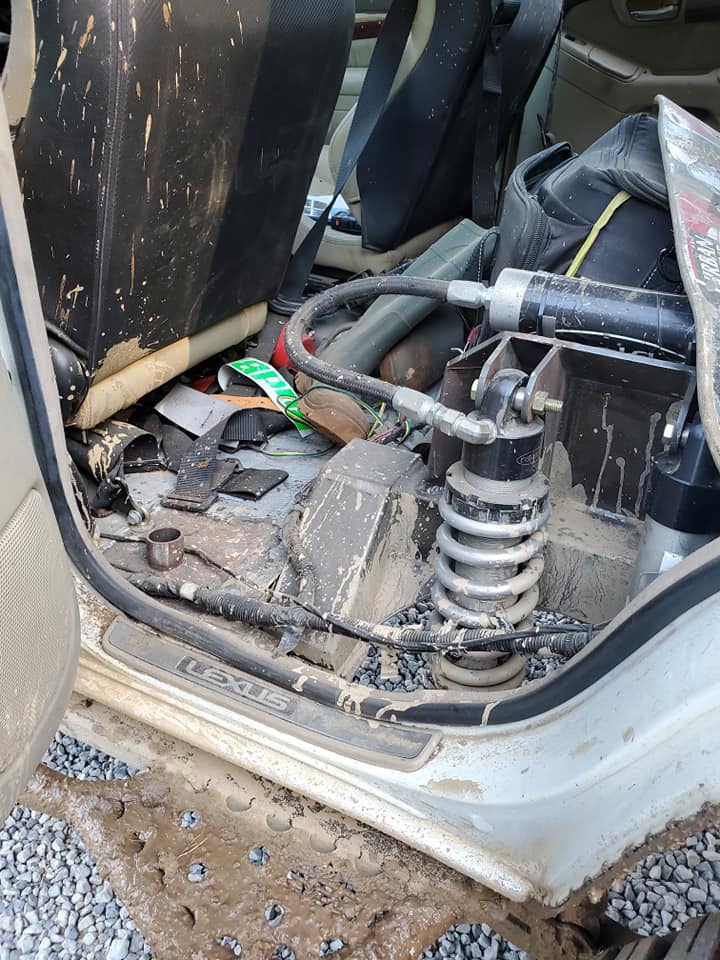

This is going to require a lot of work some day.
Tall enough to fit 14" coilovers flush with the axle tube once I chop into the body a little. Won't interfere with the rear seats if I weld them behind the axle and cut into the rear of the wheel well. Anyone want to donate me some coilovers?
You could start a Go Fund Me account.
I thought about starting a - Brett needs a Trophy Truck - account.
But then I figured I wouldn't have enough money to tow it any where, or the money to fill it up with fuel, so I gave up on that one.
I know Kevin Berthelot's Mega Lex has the rear seats removed for his rig with COs and Bypasses, but it's not a daily like yours. Curious how your gonna do your geometry. The Sherpa Motorsports crew welded support hoops inside the wheel well which I'm curious about as well. Love my truck the way it is, but you know, you always want more travel.

It'll be fun, I'll need to chop into the body a little and re-plate the wheel wells around the towers to re-seal everything. 14" of shock travel will be nice, but I'm betting the main benefit will be from raising the lower mounts to flush with the axle tube. I swear I hit those things on every rock.
The Sherpa truck has an identical rear setup to my brother's FJ which is pretty nice too. :eyebrows:
Which coil springs is your brother using? Does he have a thread somewhere? Curiouser and Curiouser...

I'm already itching to go +3.5" in the front and go full insanity in the rear lol. Actually I have close to the same wheel travel front and rear. My rear smoothies are custom length at 28.25" but the standard lower mount only gives it 9" stroke. Looking at moving the upper mounts up higher and adding some bump cans. I want more up travel for my speed addiction. No real rock crawling here in swamp land, so droop is not as crucial.
