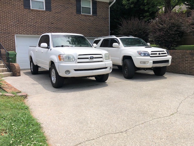

Dude, Sweet! Actually I bought a white 06 DC 4wd in June. I will be digging into the cluster soon for LED work! I'll hit you up, I may bring the business back and start making some more side $.
Hopefully yours are still going strong!

Tundra Twins.
This is the only picture I have with both of them.
