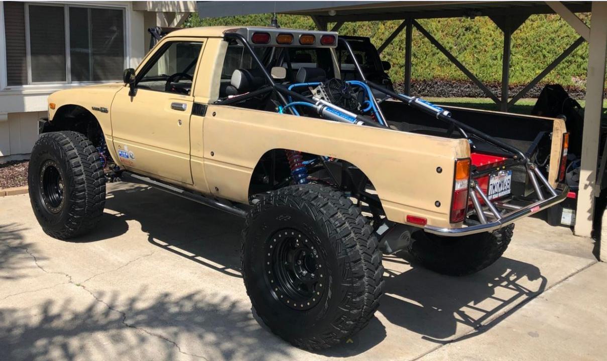

All I can see when I look at that truck is a prerunner bumper, front to back cage w some LT goodies and a bunch of COs and Bypasses. All of it about 3ft in the air at full droop. I got the whoop-itis bad....
Like this truck? It would make for a pretty easy pre-runner build.
But I still want to throw another solid axle under it and run 40-42s.
