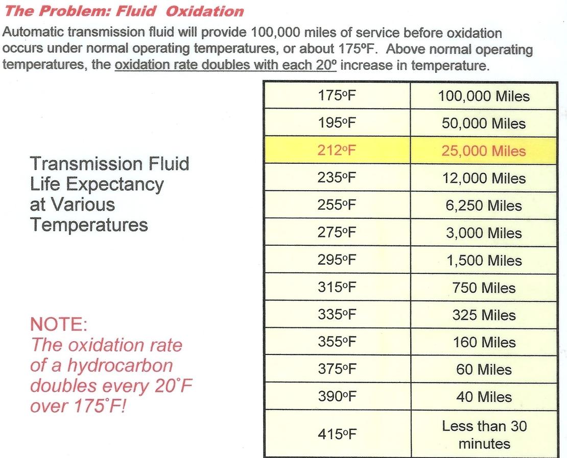

Any thoughts on what is too hot for the transmission in our rigs?
:thumb3:
Yes.
I was able to make it work by changing the Module/Header from ECM to ALL.
I was getting temps of ~154 F or so on the freeway, and ~192 going up a hill. This is in 32 F weather.
:thumb3:
Sooo, the sensor in our rigs is in a spot that apparently reads the hottest fluid. Not the pan. Seeing your transmission spike into the 210-220 is normal(depending on what you’re doing). I see a spike when i get off the freeway and come to a stop, the temp spikes then quickly drops. If it’s running consistently up there you have problems.
