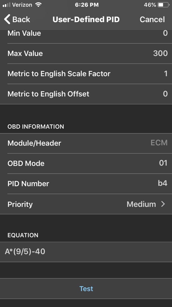

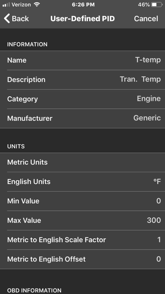

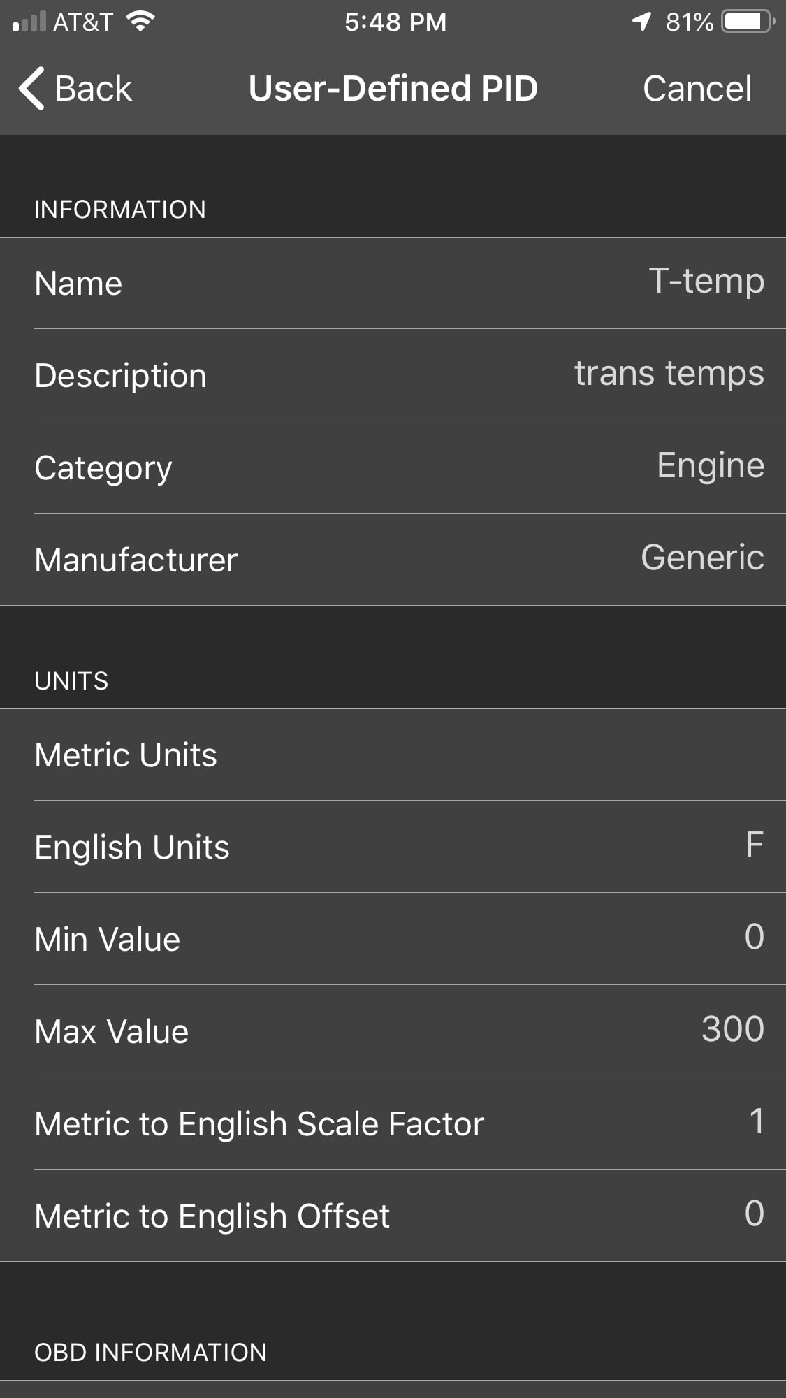

Are you absolutely sure you did a user defined PID and filled out ALL the info correctly?
100% sure
Yes, I'm 100% sure I filled it out correctly. Did it about 2-3 times now from start to finish without luck. The regular gauges for speed, fuel eco, rpm's all works, but not the user defined PID.

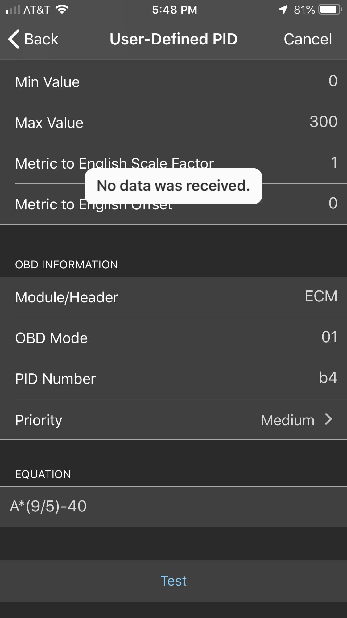

I also get the "No data was received" error message. I have a BAFX wifi unit with OBD Fusion on iOS 12.1.3. Other displays appear to be fine.

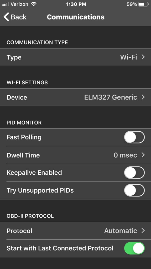

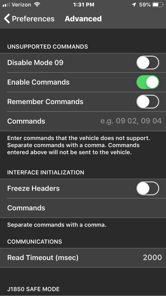

weird that some people get this to work and some do not. I can not think of anything else I did to get it to work other than changing the formula for accuracy. Make sure enable commands is on. There might be an issue cause it’s an unsupported PID. that’s all I can think of.
Tried it again today for good measure with no luck.
Enable commands is turned on as well.

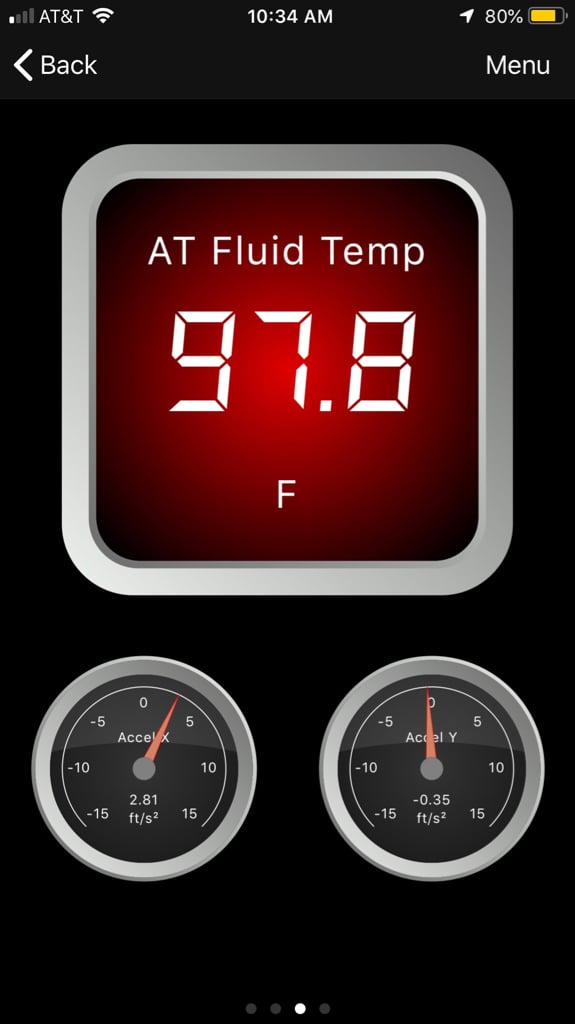

So I got mine working by doing exactly that. Once I logged into Network A I found the AT Temp setting under the Toyota/Lexus,Scion PID section, loaded it up and configured the Gauge. I then logged back out of Network A and logged into the Default connection and it all worked!

So I setup the AT Temp while on the Network A, disconnect, then reconnect under the Generic OBD2 and everything worked. That's it, I wasn't expecting it to work at all but it does
So , after trying over and over , I went ahead and bought the Toyota/Scion pack through the app. Kinda stupid that it’s extra but I really wanted to get this working.
After buying the pack , it scans the PID’s and finds everything.
So boom!!!! Got it working to get trans temps and so much more too.
