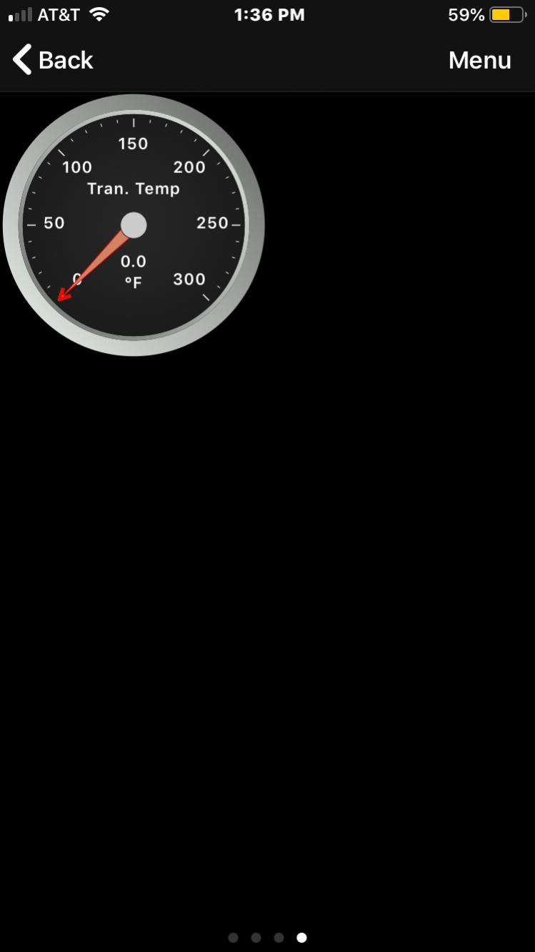

Here is a far as I got. I'm using OBD Fusion with the Veepeak Mini OBD II scanner. The Trans temp gauge is there but I don't get a reading except for 0deg. All the other Dasboard gauges work. I have a 2014 4Runner . Any suggestions anyone?
I think you and I are at the same point. Did you ever get your gauge working? My reply is the previous one to this. Thanks
