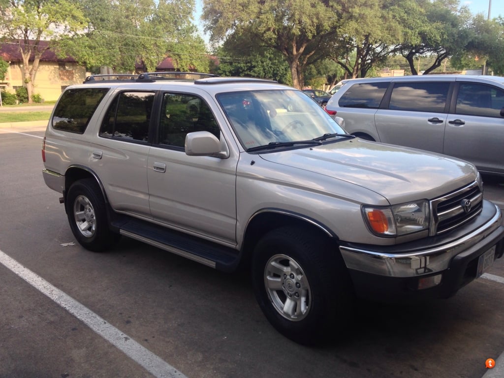

I recently purchased a 2000 4Runner SR5 with the V6 3.4L and are very satisfied. I pick up is awesome for this car and more than I was expecting. However on my last vehicle I put a CAI system and felt the improvement. So I was wondering if anyone knows about the benefits or if it's even worth getting one for this car. Thanks
