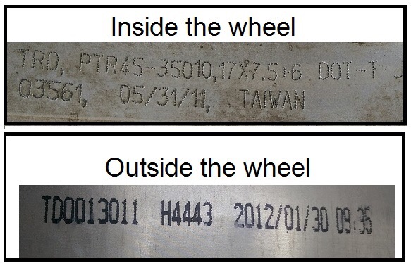

This is what was on the vehicle:
TRD 17x7.5 wheels with the stupid "bling rings"*
4Runner3_zpse61f2411.jpg~original
I still have all 4 of them. Did some cleaning and measuring today:
Back%20Space_zps8ox13wbf.jpg~original
Wheel%20Labels_zps3ddl44jw.jpg~original
Wheel%20Overview_zpsea1d3brm.jpg~original
I would be just fine with painting these myself, plugging the bling ring holes, and putting my new BFG TA KO2's on them (285 70R17). Acording to 1engineer's 5th Gen Tire Fitment Guide sticky, these wheels are on the narrow side for that tire though. The back space is certainly good but I'm not sure if this is the preferred solution.
