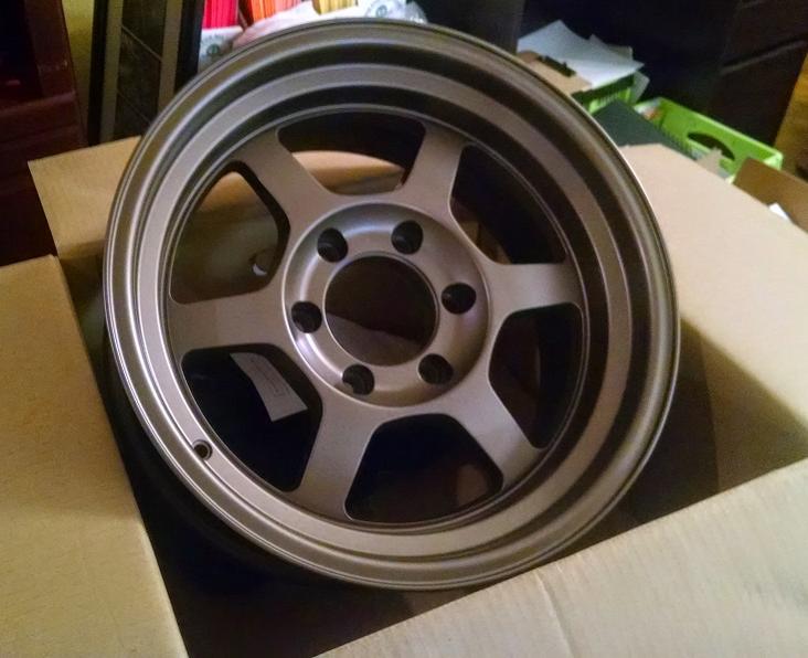

So Christmas was good to me - got some stuff for my bike, LEDs for the interior, brakes, and fog lights for the the 4R, and finally a new set of Konig Countersteer X's.
So now the dilemma I face is what shoes to put on the new wheels - SO, right now I'm heavily leaning towards the nitto trail grapplers m/t. My biggest question is whether anyone has had experience with these tires in snow AND ice (up in Anchorage, AK). Right now I have 267/70-17 LTX M/S2s - I'm looking to go with 285/70-17s on whatever tire I end up getting. Any feedback would be greatly appreciated. My 4R is my DD in the winter months, and my weekend warrior rig in the summer while I ride the shadow for everything else.
Thanks again for your feedback!
