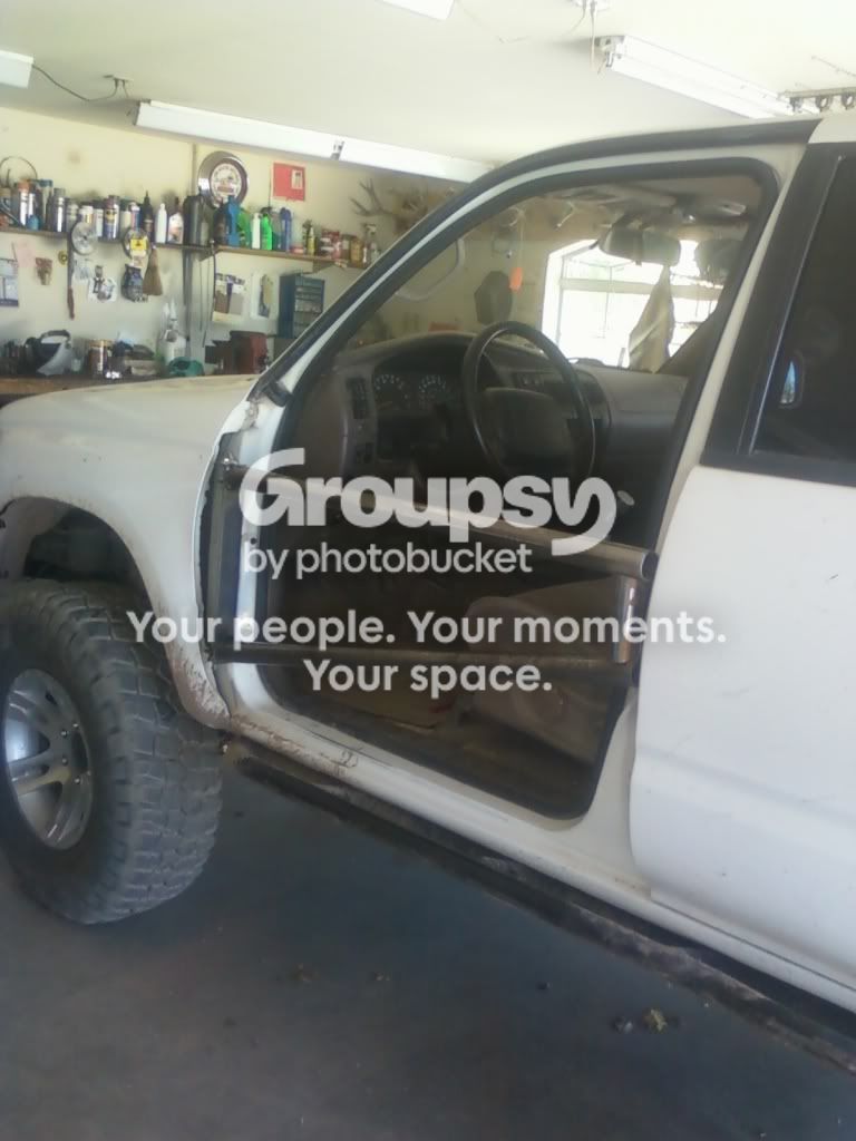

Doors off

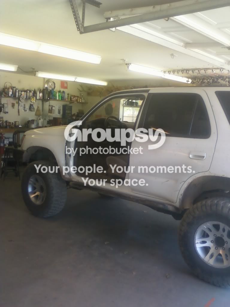

Statring the doors

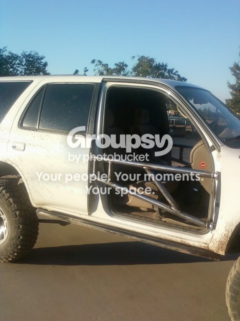

Finished product. :) I may add some expanded metal to the inside of the door, and I want to add some marine speakers.

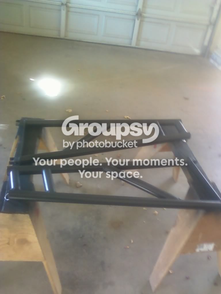

All painted up
0629111724.jpg~original

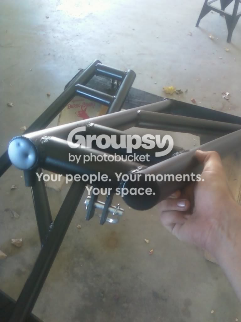

tube caps which already have dents, I plan on weld on versions, but this was good enough for now. and a close up of the latch. I super glued that rubber stopper to the door. they fit super tight and dont rattle at all. The pin latch is not the most convenient but it was super cheap and stout

it would be awesome to see you market these.. I think quite a few people would pay for something like this (including me). And since you made them on the cheaper side, it would be afforadable for everyone.
As for the actualy end product, it looks great! I suggest a few gussets.
Anyways, great work.. truck is becoming a very functional rig!

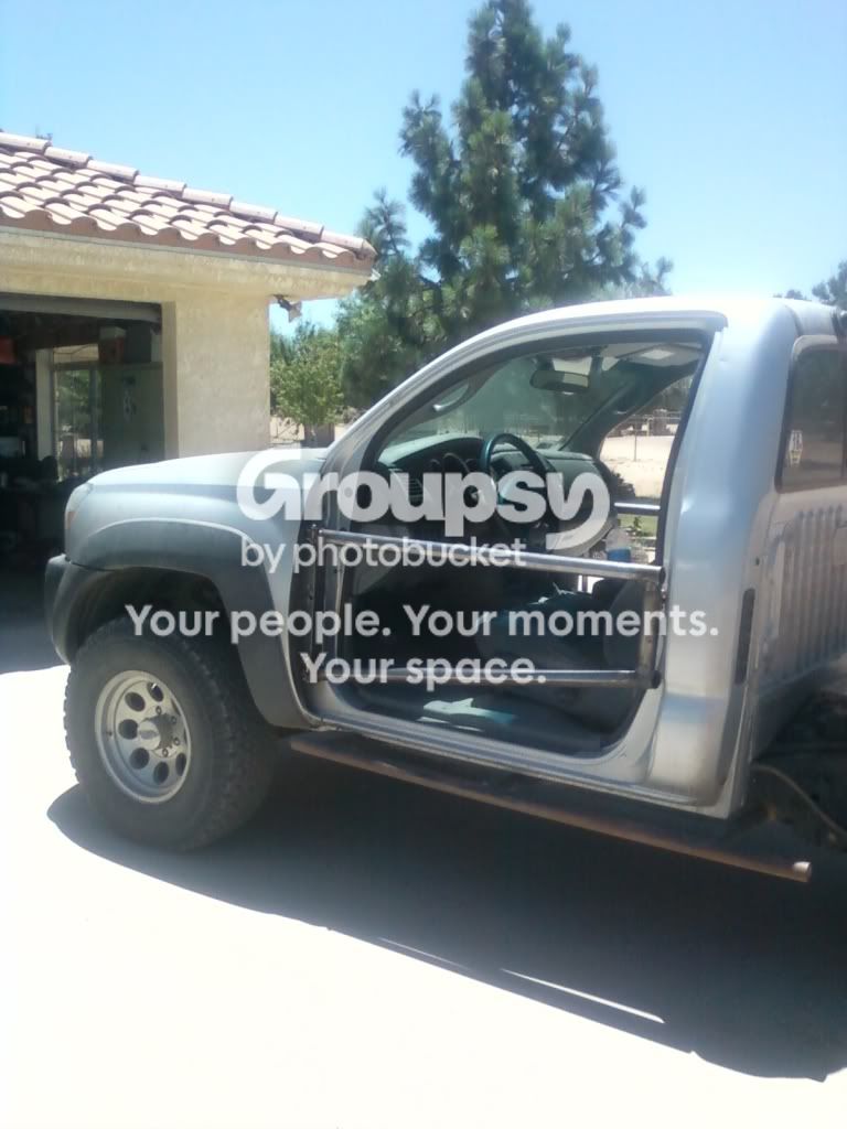

Well this is not really part of my trucks build up, but I fabbed up a simple set of tube doors this morning for my buddy's 09 taco. As far as i know it may be one of the newest tacos with tube doors. I will add one more tube iin the middle of these doors eventually, but the progress was not bad for a 3 hour job. Got bot sides on, latches made up, door stops on and all tubes fully welded. My rears are next. I am also hoping to get to installing my new clutch next week

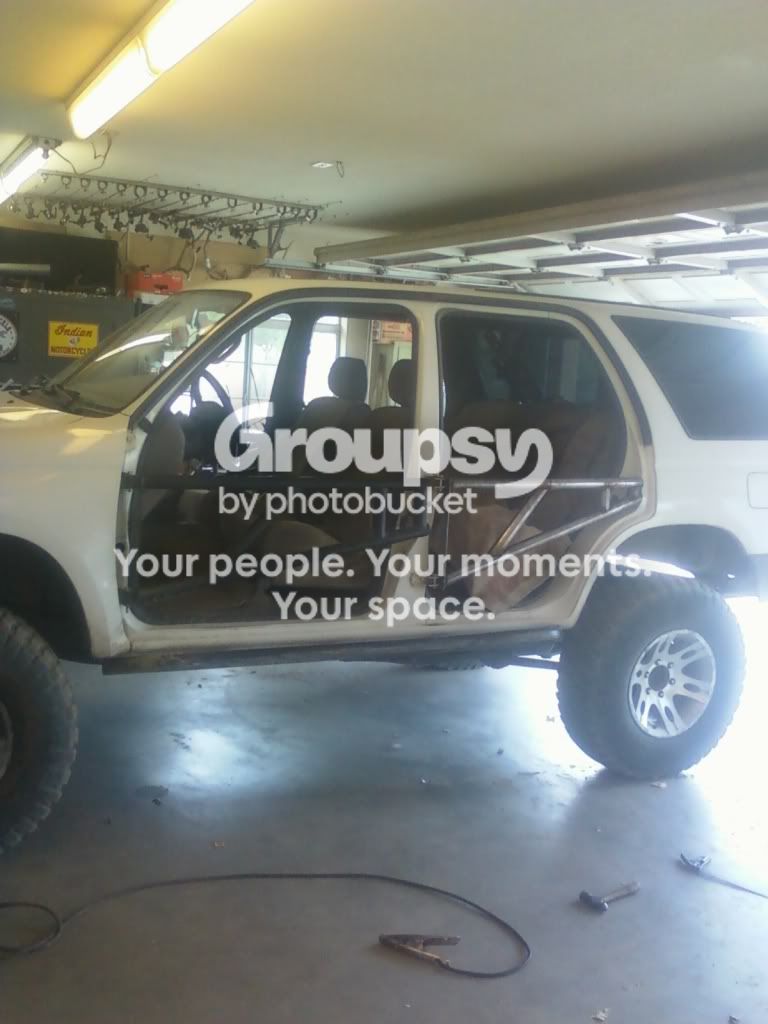

got a little work done today. I think it looks great with the rear tube doors. All i have left is to finish my welds and add a drivers mirror to the front drivers door. Then paint. I think the rears look pretty similar to the fronts I tried to keep the same look going.

Looks bada$$!! I think the rears look like a great match to the fronts!! What are you doing for a mirror? Catalog?
