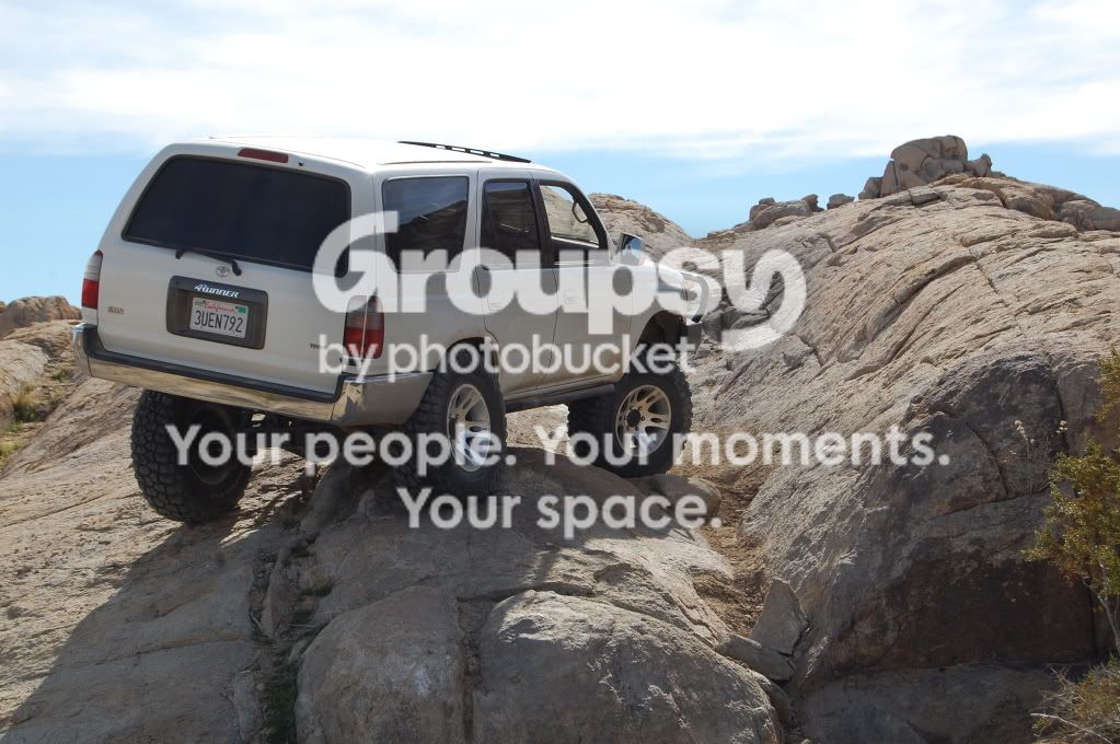

Well my Hard drive on my computer broke a few weeks ago. I lost all of my stuff because I dont have a back-up. Anyways i was looking on photobucket and found some cool wheeling pics from this last year.
Generally I dont take pictures when I go wheeling, but on a few trips someone had a camera.
here are my favs.
DSCN1735.jpg~original
DSCN1736.jpg~original
DSC_3145.jpg~original
DSC_3116.jpg~original
DSC_3040.jpg~original
2C3T0064.jpg~original
0417001809.jpg~original
Thanks. That red sas second gen is top heavy. It would have flipped, but the slider stopped him. I have some good wheeling coming up this weekend, maybe I'll come home with a new dent or two :)

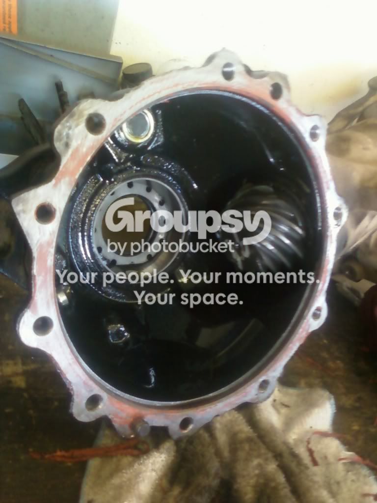

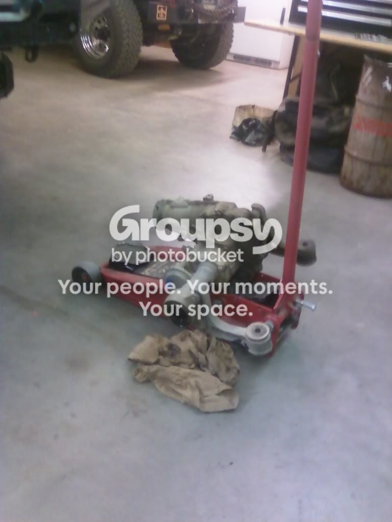

Front diff out. Took about an hour and a half. not too bad at all

Pic of the pinion gear. Funky housing

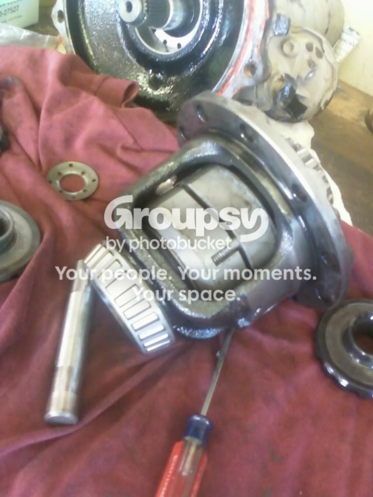

Locker in spider gears out :) Notice that the ring gear had to be removed for this install. No worries on re setting the backlash this diff has no adjusters like the v6 Its done with spacers

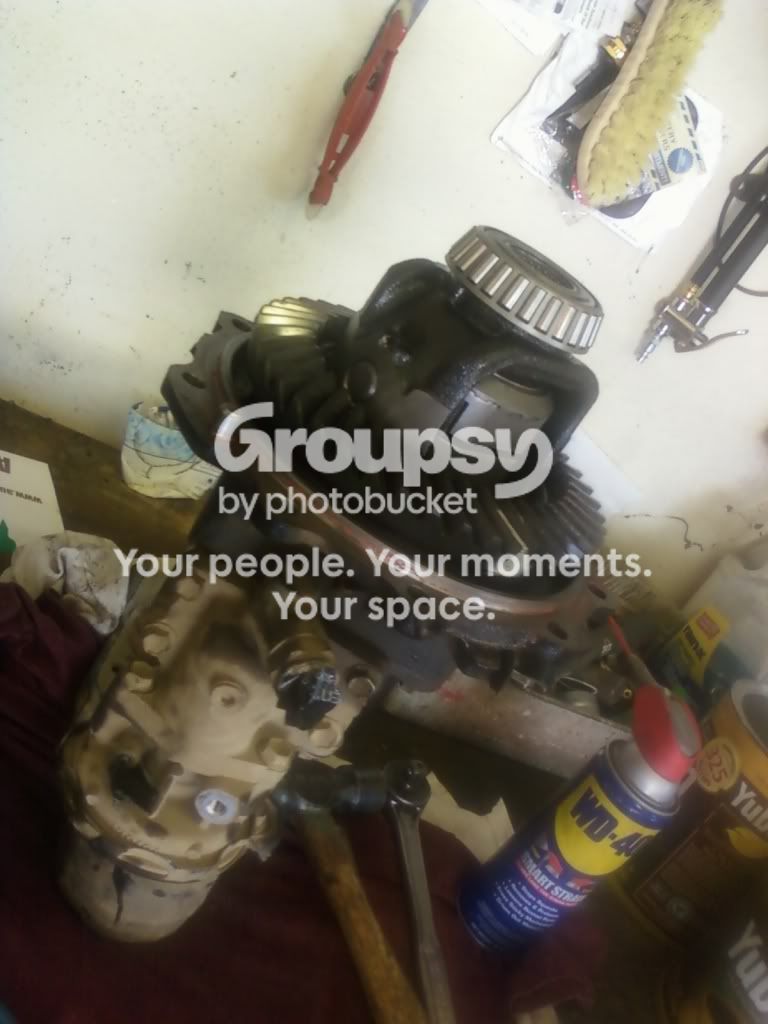

Ring gear back on and carrier back on the stub shaft

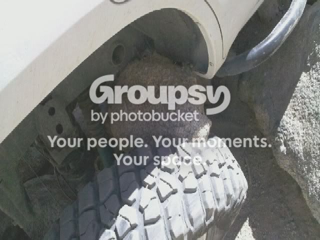

and the rock that got jammed between the frame and tire in Bullfrog ended up slightly BENDING MY LOWER LINK. its bowed slightly downwards. I didnt think a rock could bend 1.5" .250 wall dom that easily :) Its not a big deal to me Im just going to leave it. If I had to do it again I guess I would have to use 2" .250 wall dom or use the 1.5 .250 wall and sleeve it with some 1.75" .120 wall. I think 3/8ths wall dom would be almost unbendable.
