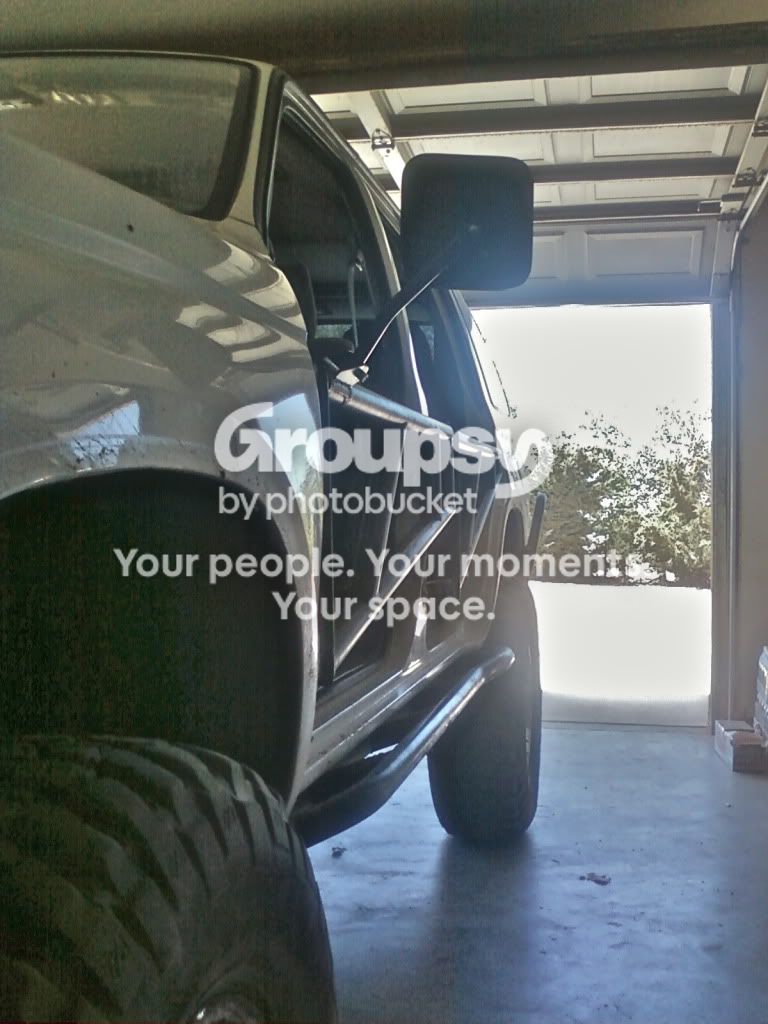

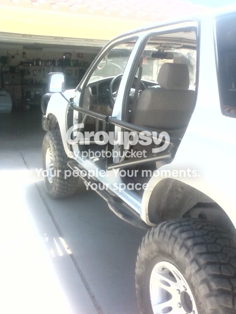

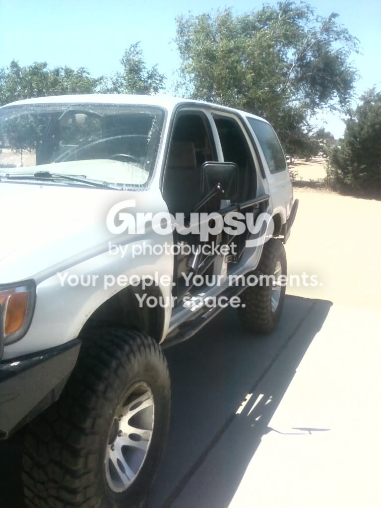

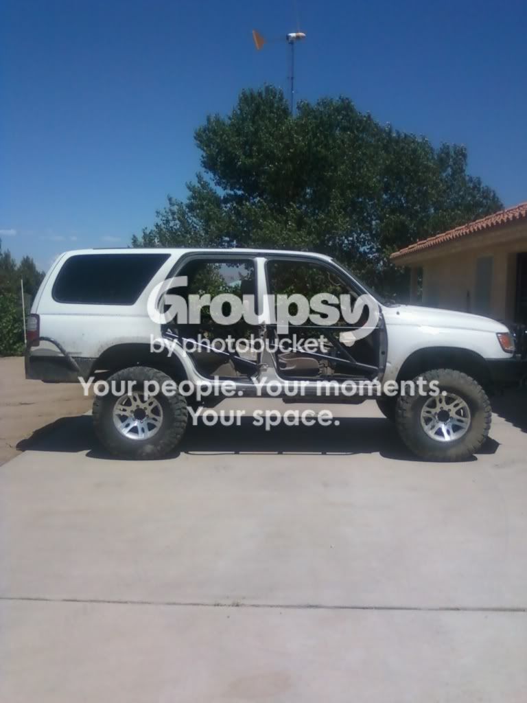

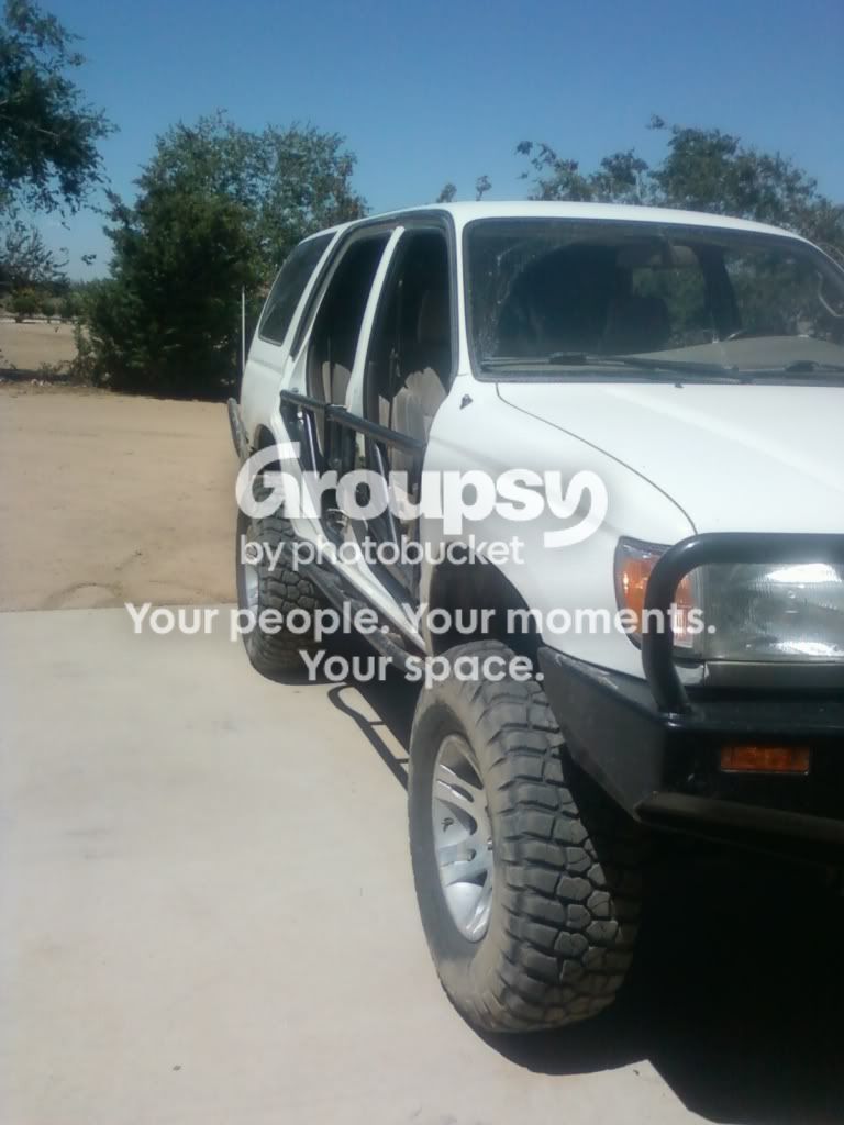

Finished the tube doors. Got a drivers mirror made up too. All in all im stoked on them I think all 4 looks better than just the two front although im about to go put my regular doors back on. These are really just for those nice weather local wheeling trips. I took a few pics.
0710111424.jpg~original
They match pretty nicely!

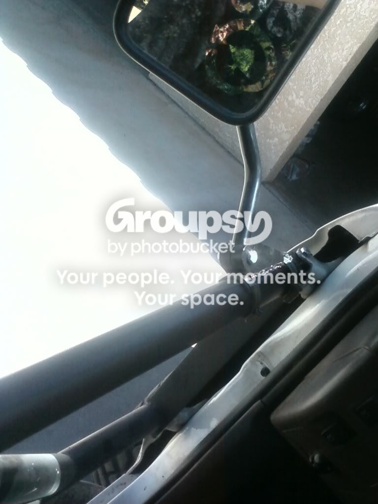

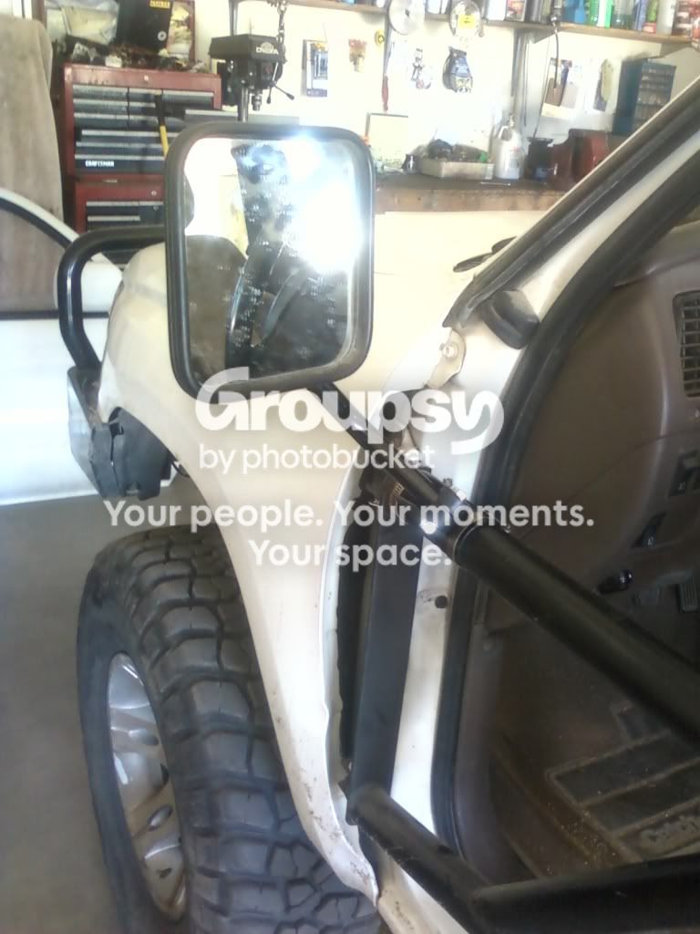

Removable mirror mount. and Cj 5 mirror Totally free!

They were really fun to make. I have under $100 into them, that included the hardware to make the quick pins for my doors. I know its not the most creative design, but it is sturdy, and they do not rattle at all. If anyone ever wants to make a set hit me up if you need some ideas.

I like it. How long does the door switch take? How did you deal with the door electronics?
I can get all 4 off and all the tube doors on in about 15 minutes. Putting the regular doors back on takes a little longer because you have to get the pins in while holding the heavy awkward doors.
As far as the electronics go, each door wiring harness has plugs in the truck that are easy to get to. There are two plugs for each front door. located in the kick panel. The drivers side front plugs are blue and the other is white. the passenger front plugs are blue and the other is black. Each rear door has a plug right behind the panel that covers the seatbelt. Pop that off and unplug it. And there is a door sensor for each door, I unplugged all of them and leave them unplugged since i can tell when a door is open.
Its really easy. I have pins in each door that hold them on. I know other people have made tube doors where you unbolt the stock door from the hinge and bolt on the tube door. I like the pins

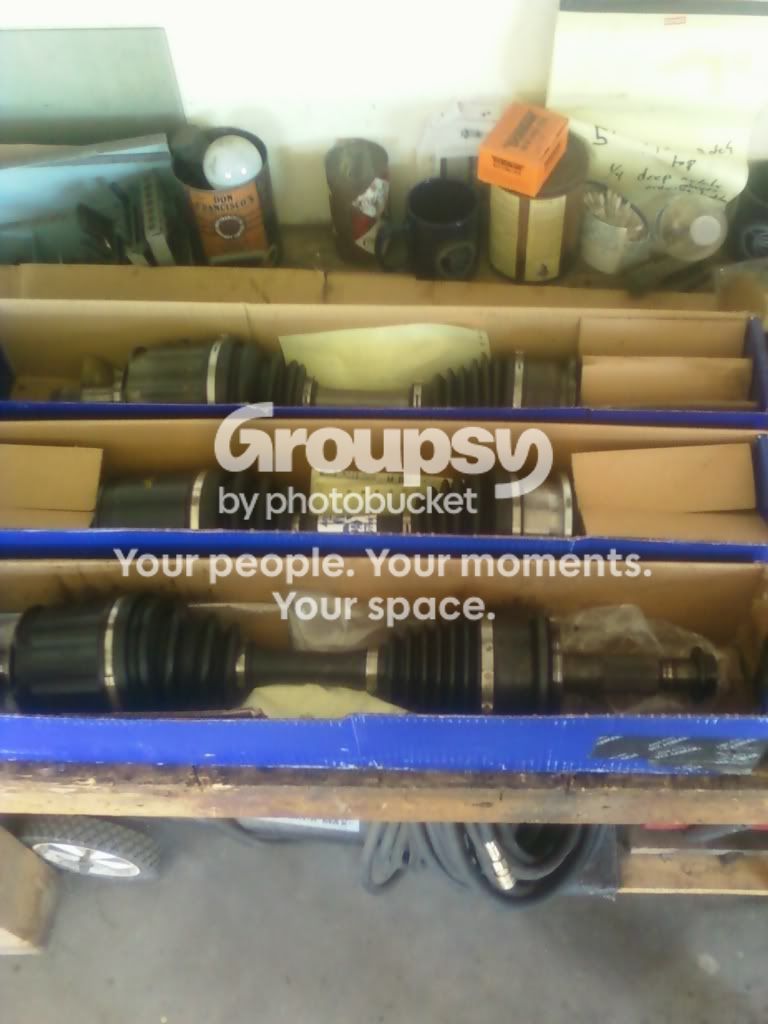

Little update. I broke my 3rd cv in 6 weeks :) Gotta love changing it out on a night run too. Napa replaced it for free. I have 3 napa cv's and have broke all 3 and have received 3 free ones. I go to a different napa each time.

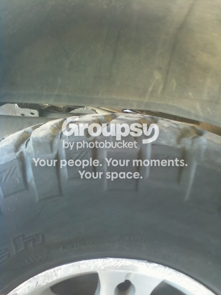

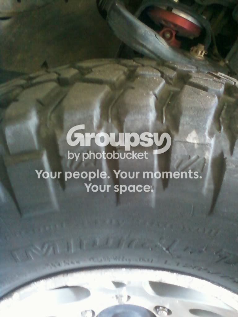

On to the next topic. Bfg Km2's... Not the best tire. I have had them for about a year and I think they have about 5-7K on them. and i dont know how many wheeling trips. but i generally wheel at least once a week. and i dont drive my truck for anything but wheeling. Check out this strange line that shows up on all 4 tires ( i only took pics of 3) You can clearly see where the tread meets the sidewall. Im not concerned about it, but I am almost positive i will be running 315 treadwrights next. After seeing a 4 normal tires start to de-lam, I would feel better if they were re-treads. I thought it was rock cuts untill each tire has it and you can feel a hardness difference between the 2 tires

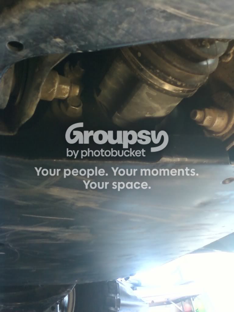

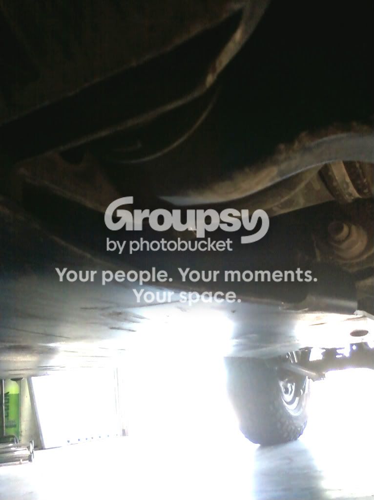

I aslo got tired of having to pull my budbuilt off to change a cv on the trail. It sucks and last time at 11pm i was pissed and decided to chop most of the sides off. Im sure it will now bend easier, but its already pretty mangled. It is spring loaded....It probably doesnt look like much unless you own a bud and know what it looks like on the sides

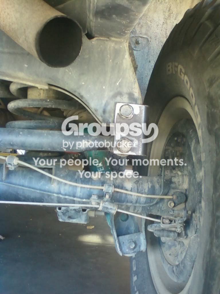

And finally Check this self-made PH drop bracket. Its made out of .250 receiver tubing. I made this for a member on this forum. It fit great and it beefy. Its mocked up on my 4runner to make sure it fit before I shipped it.

damn, those doors came out awesome! If you plan on putting them to the test, which I kinda doubt, I would consider gusseting them.
What good are they unless you smash them on rocks! I have came really close to them, and my friend hit his on the same line. Of course I'm going to use them. I built them to remove as much sheet metal as possible for those days at the hammers. Your not the first to mention gusets. I think they will be okay, my sliders are made from the same stuff and have only dented. The only gussets on those are at the frame. Maybe I'll try and add a couple in the larger open area. I think some1/8th plate on the b pillar would be really nice
It might very well be de-laming but I had similar cuts like that on my tires and it was from rubbing the inside of my fender like when I was flexed and would cut on the sharp edge in the fender.
I can see where that could be an issue, but my tires dont rub anything but the plastic gas fill tube cover. they are just de-lamining. Its visible on all 4 tires, and its worse after each trip.

And a pm will be sent about the panhard drop shorttly
Jason I think its just a split between two rubber compounds. your putting more milage on those side lugs in a day then most will in the life of the tire. Ill look on mine but i think i have lines too. my treadwrights wore funny in that spot as well. nothing to worry about though.
Im not worried, they have just been a disappointment. the are a year and a month old. have about 7k on them, are about 50% worn. Treadwrights are my next tire. i chew tires up anyways.
