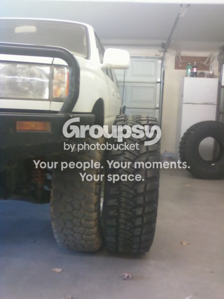

Yeaah buddy. These mtr's run true to size. way bigger than these km2 285's. I have some cutting to do. THe front diff will be here mid next week. got the rear gears ill probably install that stuff on the weekend. then drop the front, put the aussie locker in the new front and slap it in in the middle of the following week. then time for some tubbing :) and chopping.
Threw the old sway bar back on the front to hopefully help these new tires wear evenly. my km2s wore out on the inside/outside and i think its from all the body roll in the corners
