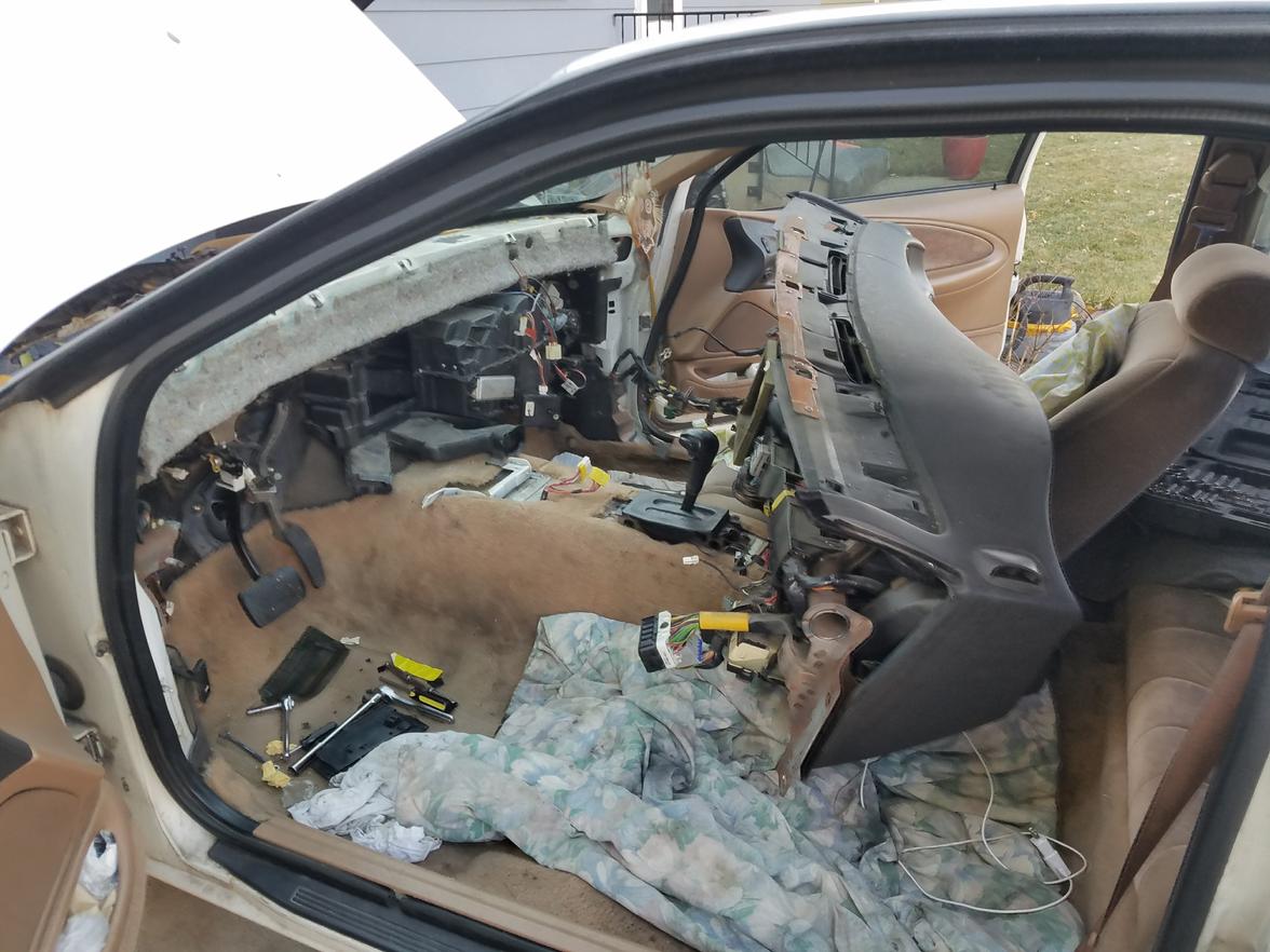

Well I had to post this here. Did a buddies wifes heater core. 1996 v8 4.6L Thunderbird. It was the hardest job Ive ever done on a car I believe. Thats doing motor swaps, turbo work, head gaskets, timing belts, suspension work. Took me most of 2 days.

Damn. That does not look like fun. Fortunately, here on island, its always summer and the heater core are bypassed and the thermostats are removed.

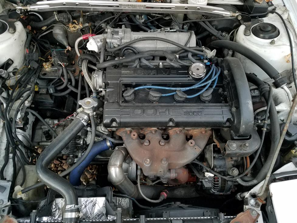

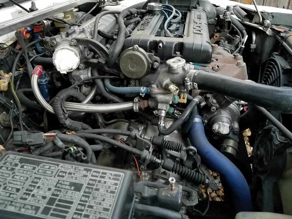

Did some tear down on the Talon. Just removed some motor parts and cleaned up the engine bay a bit. Getting ready to pull the trans to see why it does not want to move.

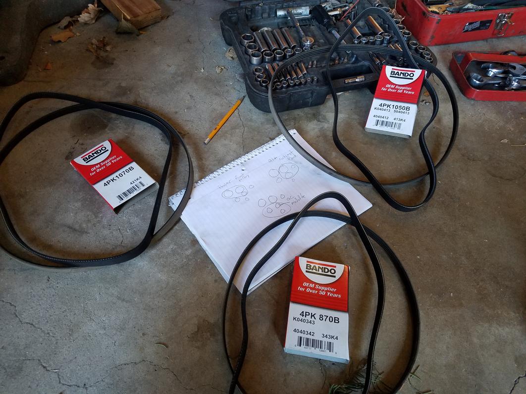

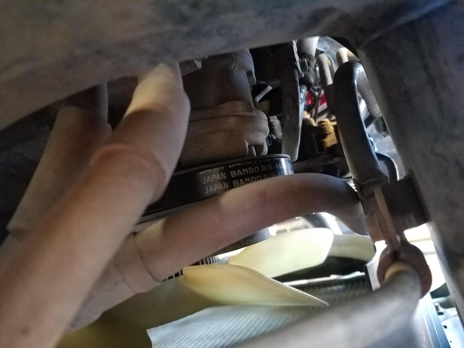

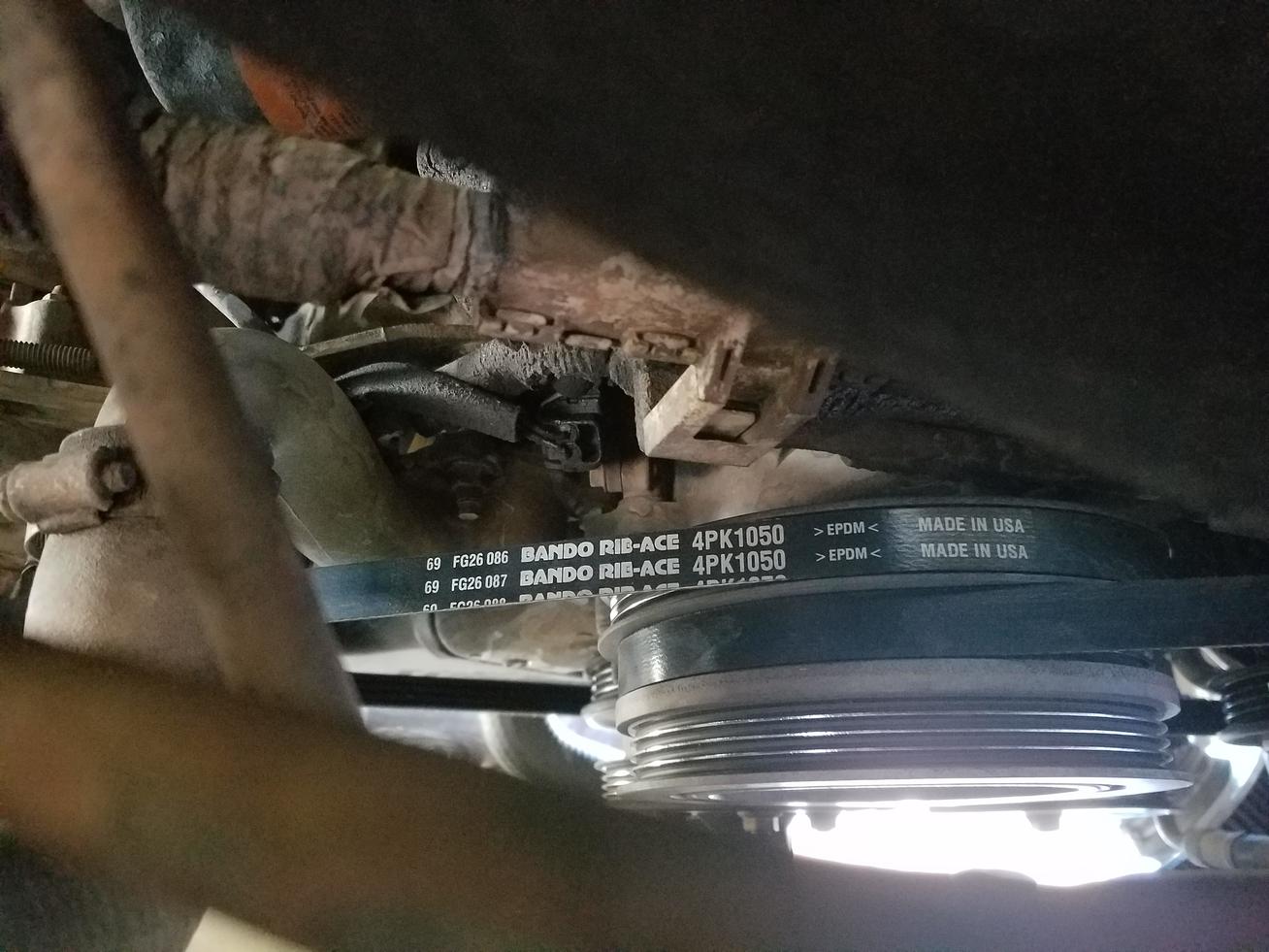

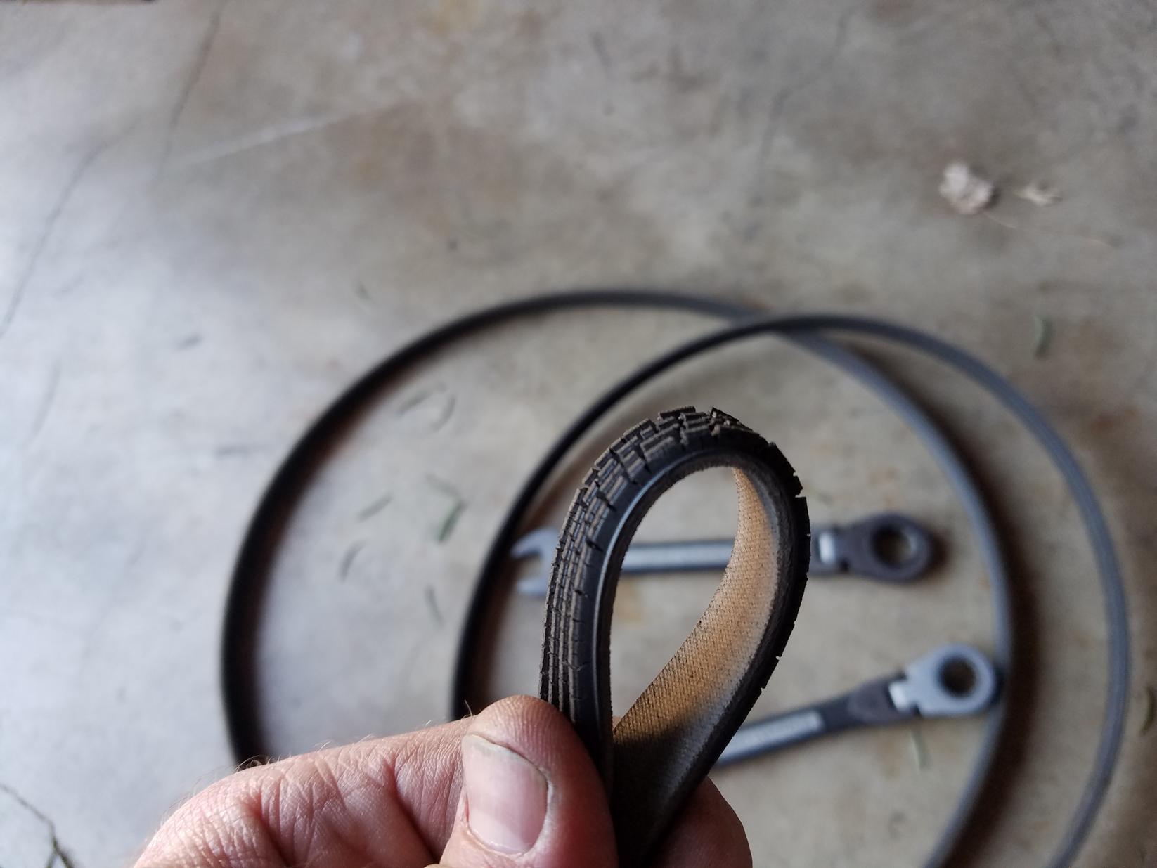

For a little while I noticed slow window motors and dining lights at idle. Odb showed 13.5-13.8v. Thought maybe firing alt. The few weeks ago belts started squealing at startup and alt belt felt loose. Ordered some bando replacement belts.
All the accessories pulleys sound so much better and solid 14.5v at idle. No more slow window motors and dimming lights at idle.
Funny one belt said usa made and others where Japan. Never knew bando had U.S. plant.

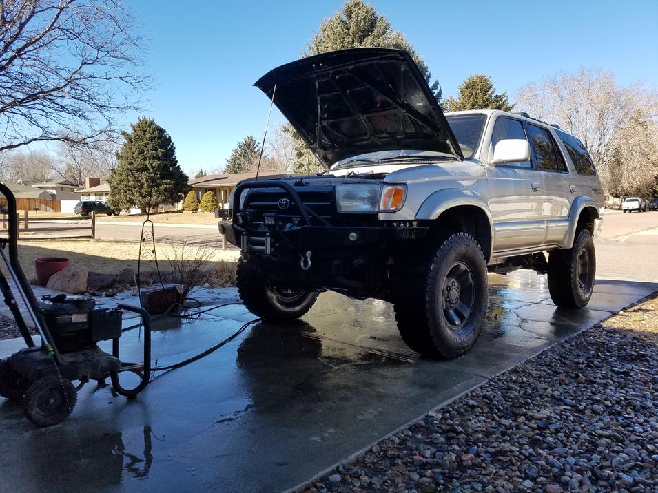

She also deserved a wash. Cleans up good for 20+ year old and nearing 300k miles.

Retightened my belts since I was getting a squeal since replacing them. Should be good now.

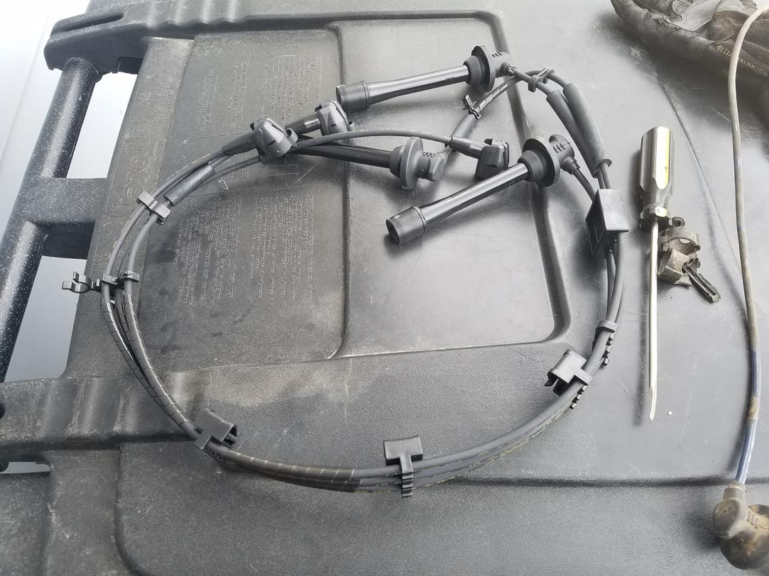

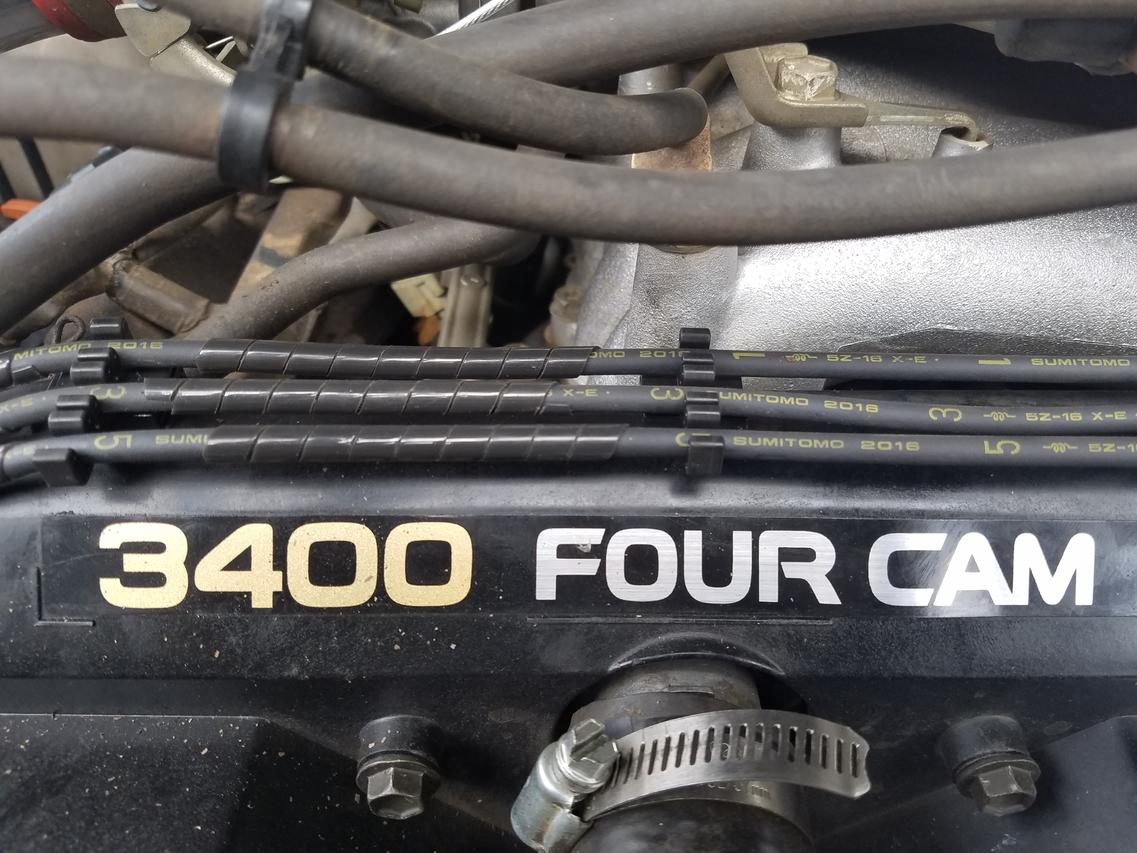

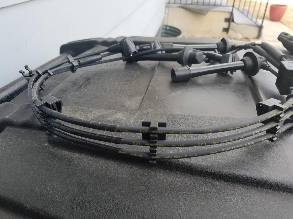

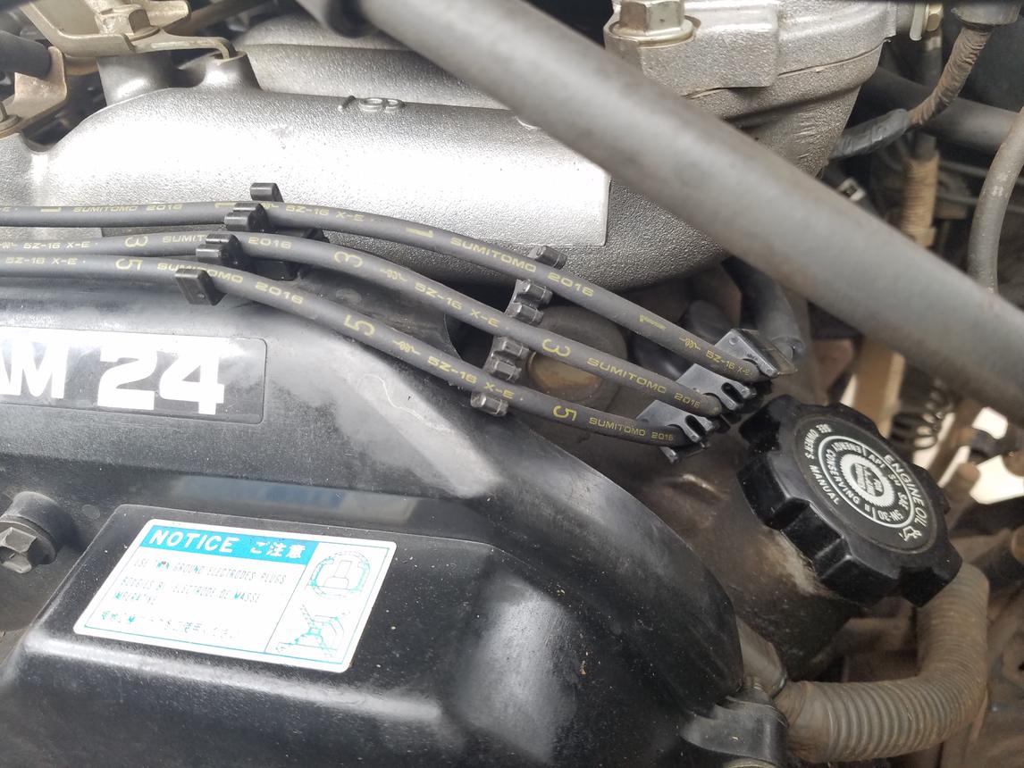

Ordered up OEM wires and denso plugs. Plugs didn't show up did just through the wires on for now. The OEM wires are very high quality. They came with all the new wire management clips and shielding. Worth going OEM over ngk and black is a lot more clean.

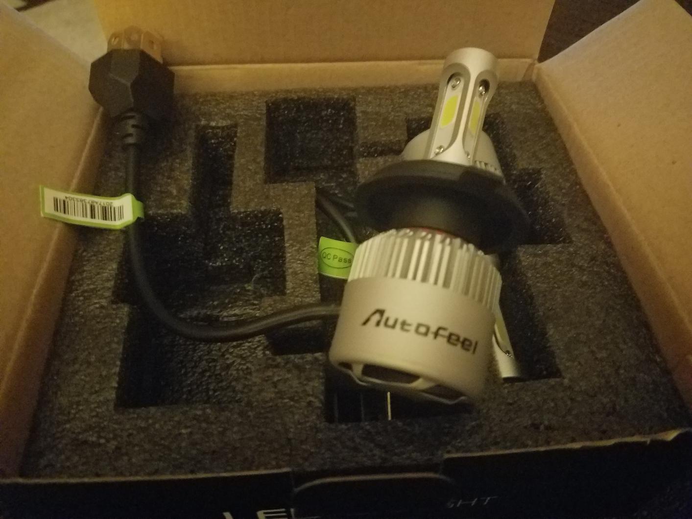

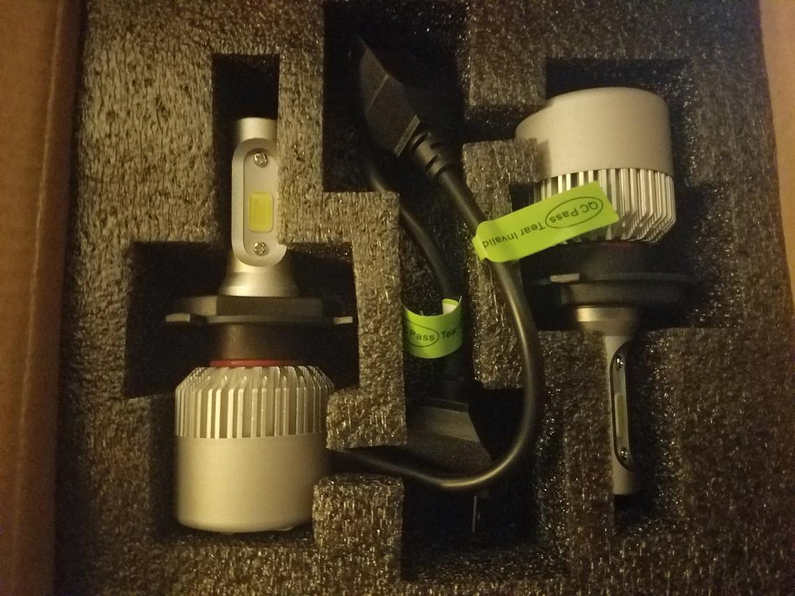

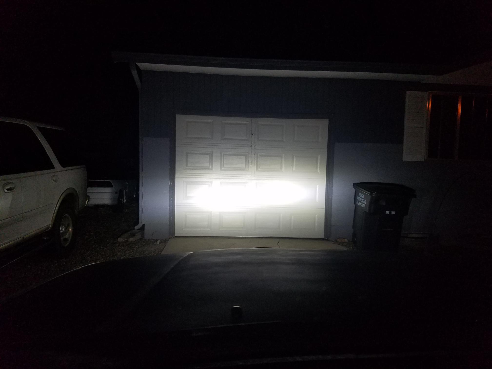

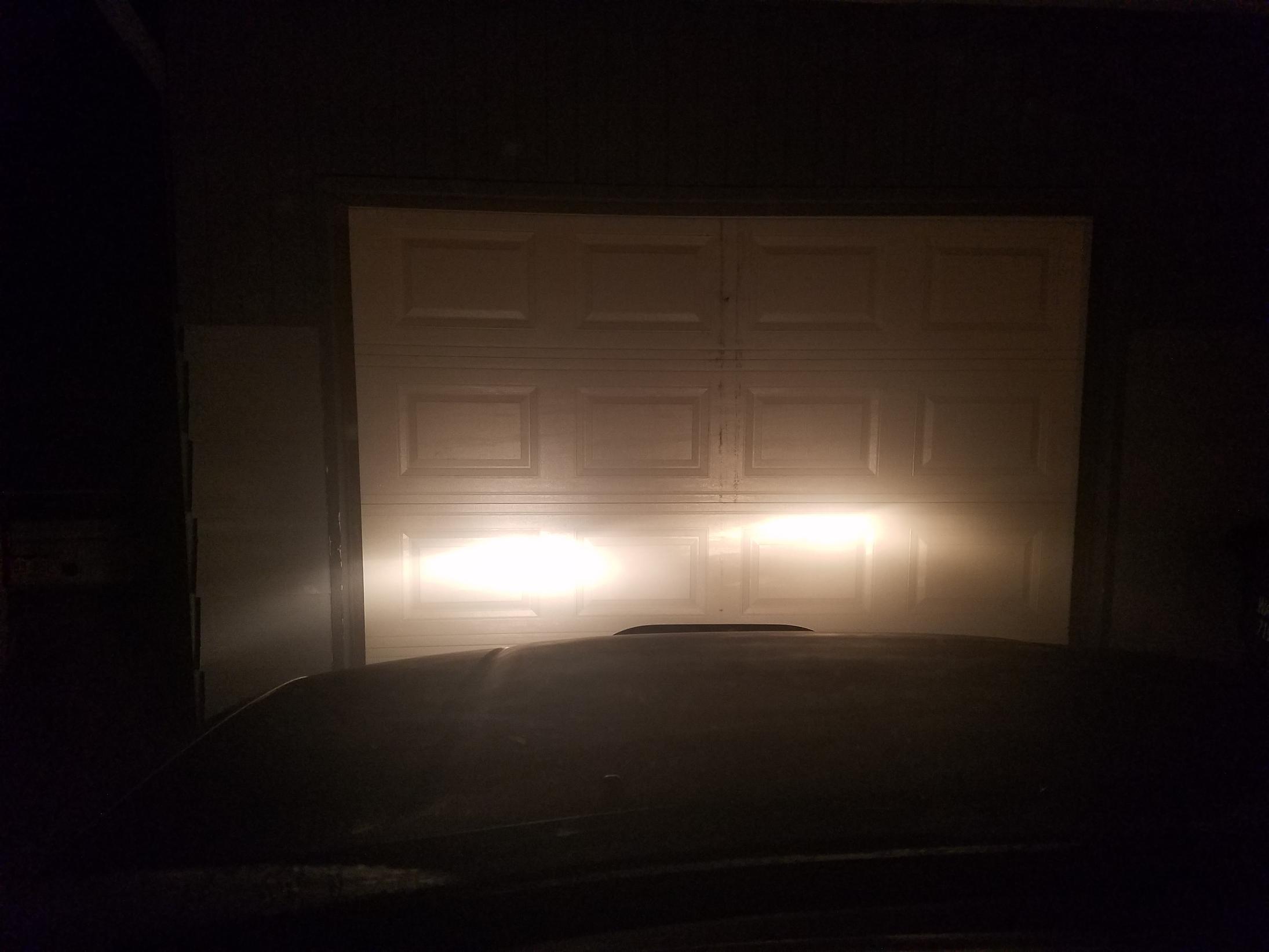

Cheap eBay led headlights. 120W 12000LM FAN CREE LED 6000K WHITE bulbs. $25.99. 5 year warranty.
100 times better than my stock halogens. Hi beam not the best but low beam is great. Little bright up close but throw is good. Cutoff is horrible but hoping not an issue. So far no one has flashed me.
