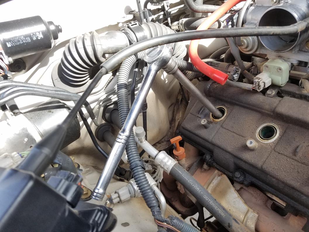

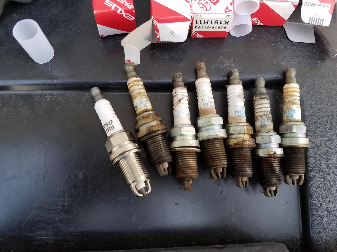

Did my plugs. They been in there for at least 6 years and 100k+ miles. I developed a mid to wide open throttle hesitation/misfire.
One thing you always want to clean out the plug valleys before removing plugs due to debris falling into cylinder which can cause spark plug blowout.
The one white/ clean plug was wet and smelled like gas. Guessing that was my bad plug and hesitation. Rear plug on passenger side was a pain. It seized up and required BP blaster and lots of work. I had to get out the 1/2" wrench and pray out came out. And it did without destroying the threads.
Also cleaned air filter while it was out. After all said and done the misfire is completely gone. Car starts up a lot easier and feels super smooth.

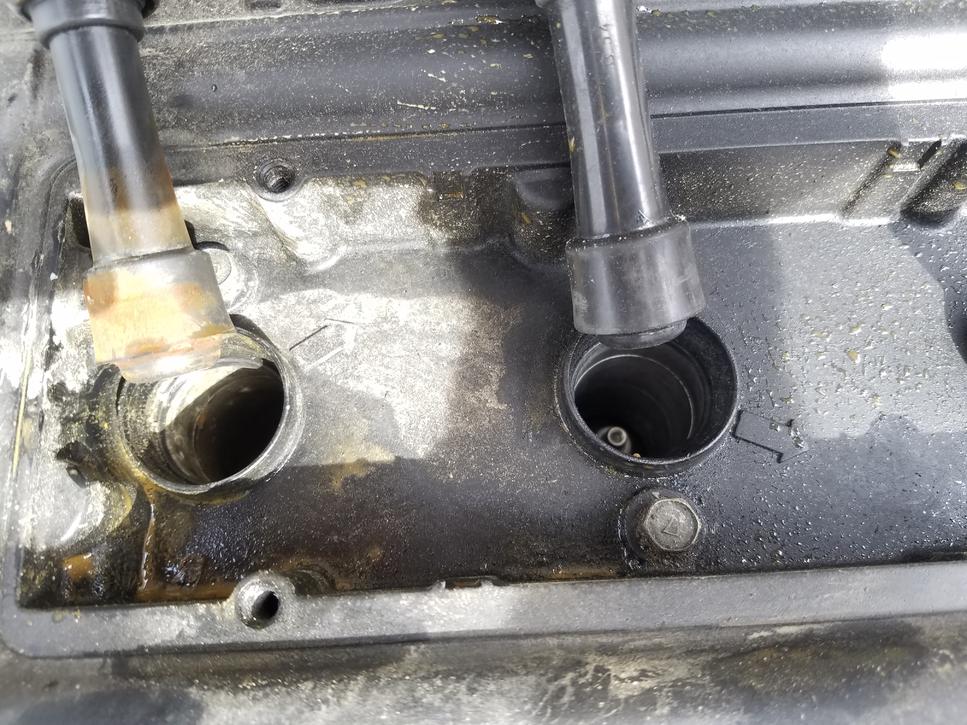

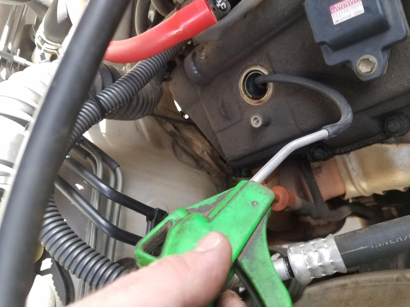

Also when spraying down my talon I noticed one spark plug wire was loose. Pulled it out and valley was full of water and was deep red. Pure rust. Used compressor to clean it out. That sucks. Lol.
