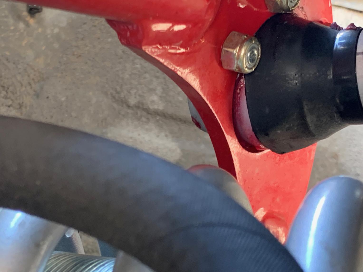

After the install I noticed that the ball joint boot is not seating properly allowing grease to come out. This is happening on both sides. Anyone seem anything like this before?
I texted Marlin at JBA today and sent him some pics of the boot. He said he may need to send out some extra boot washers to push the boot up more to the bottom of the UCA.
Hats off to Marlin for answering texts on a Saturday!
Got my alignment today. Was able to achieve a caster of 4.4 and 4.7.
I had mine for 2 years and the boot is the same as yours. Do we have to contact him to get the boot washers?
Yeh, call or msg him on his site (the chat feature) and ask him about the washers. After I got an alignment it doesn't look AS bad but will still add in another washer. I just don't want to have to take off my wheel and knuckle again. :(
I was searching for a washer that is in two pieces that i could squeeze in and that is held together by some sort of "clip". That way I don't have to take apart the knuckle :T
wow yeh?
Can you pretty much stick your finger under the boot and into the slot where the ball joint moves?

yeh it looks like u can pull down the boot easily and expose the ball joint.

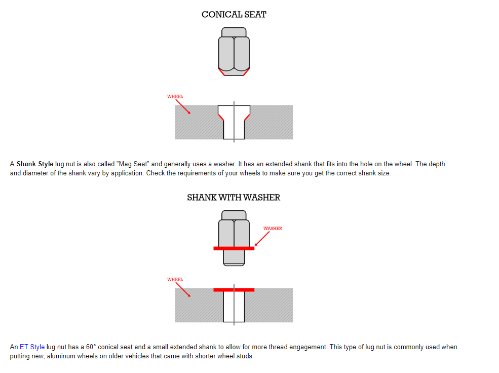

So my 18" Limited wheels have the lugs with the captive washer, is that the mag seat? Never mind I found it.
