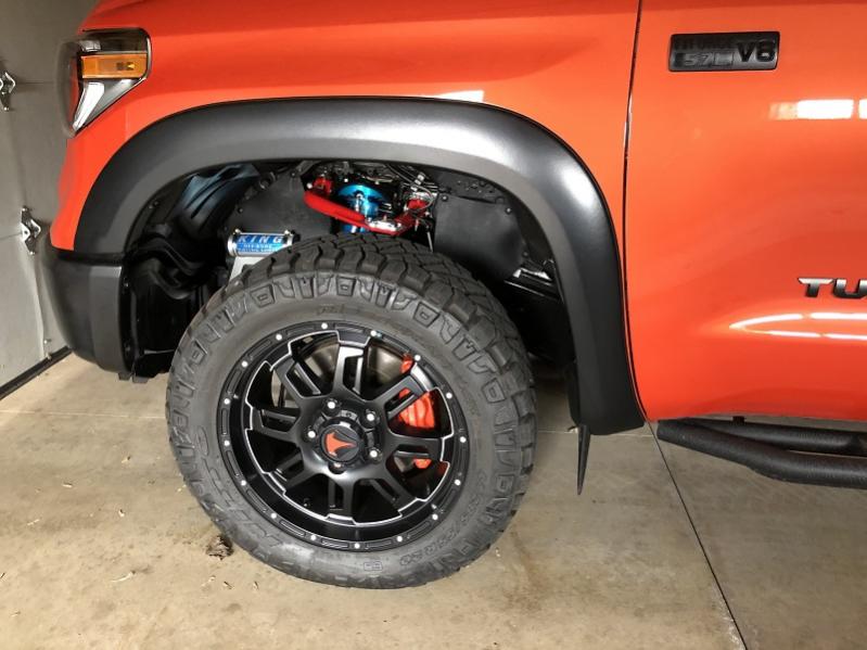

Just recently installed these on my Tundra after reading this thread, so I made sure to seat them first before bolting it up, didn't work as it popped off after I let the suspension fully drop. Definitely needs a redesigned boot with an tapered base, but it should still hold the grease where it needs to be.
These are well made uppers with quality ball joints, so I am hoping they offer an improved boot soon.
