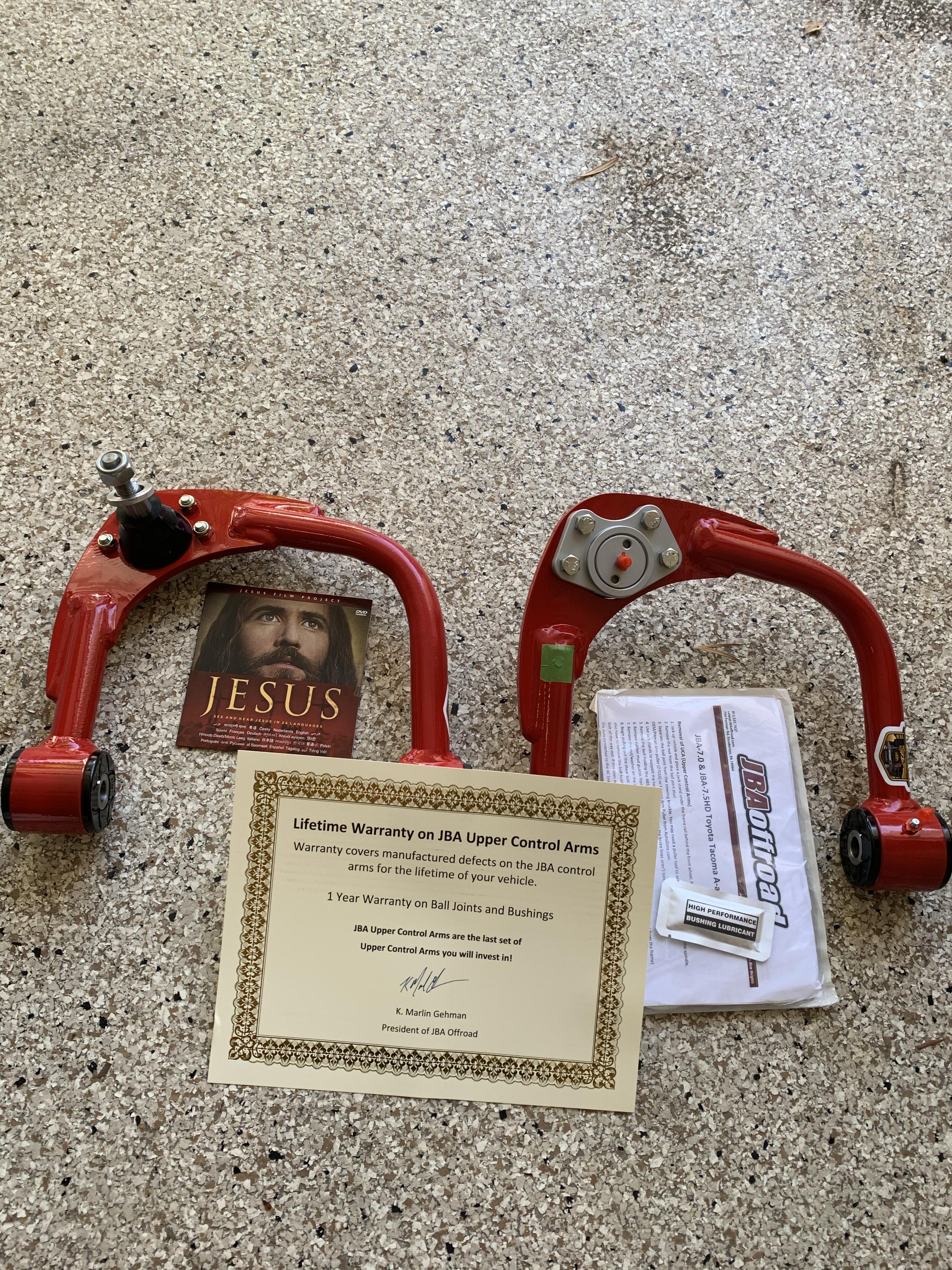

I literally just received my UCA’s today. Seems like it is a known issue, why don’t they just include more washers ? Let me email them now. I’d rather get this done right the first time. I only have one washer per side :-(
I literally just received my UCA’s today. Seems like is is a known issue, why don’t they just include more washers ? Let me email them now. I’d rather get this done right the first time. I only have one washer per side :-(
I'm honestly surprised they don't ship with 2 washers by now. Then again, without OP i probably wouldn't have checked...
Same here. Received my UCAs last week, still sitting in the garage. Glad I saw this thread, contacted JBA last night and got notification this afternoon that additional washers will be dispatched. Good customer service.
I agreed that added washers should be included going forward. Or revise the boot design.
While they react quickly and said they would send out extra washers, I really don't see that as good customer service when they obviously know that the extra washers are needed because of poor design, IMHO good customer service would be to include the extra washers with every order, at least until they do some kind of redesign to solve the issue!
I'm wondering why even one washer should be needed much less two, IMHO this make it more obvious that they know there's a design issue?
