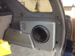

That's very similar to the sub I used to swap out my blown jbl. I'm heading home here in a few and I'll pull the box out to confirm.
I seem to remember you will have to do some minor modification to the stock wire ends and you will likely have to make a trim ring to mount the sub to.
I believe you need an 8 ohm sub for the stock system

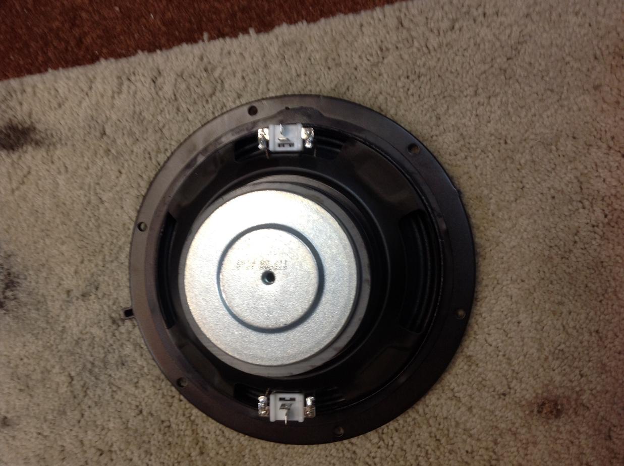

Also the sub has a dual voice coil as you can see on the picture

Yes, it's definitely dvc, and if you have an aftermarket hu, I would suggest adding an amp, but it should work without one, it still may sound a bit distorted unless you tune your hu correctly to work with it.
The stock system is 2ohm. You will need a 2 ohm dual voice coil. Your best options are kicker or I believe jl audio. I searched high and low on this and this is the sub I used: Kicker 40CWD82
You WILL have to do a little trimming to the fins that are in the box and on the stock sub cover if you use this sub. I'm almost positive there is a shallow version if this sub made by kicker but at the time I ordered it was not available.
i used a Fosgate P3 slim 8" and didnt have to trim anything. Fits great. Sounds great. Very happy.
