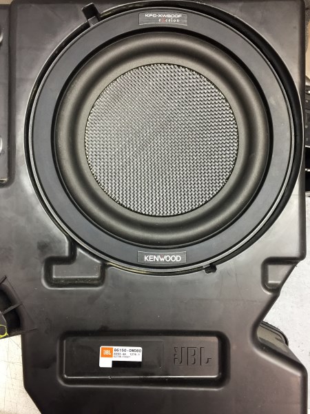

I've just installed this Kenwood.
Just drops right in. Plug 'n' play.
No modification of any kind. Rubber surround and fibre cone.
Sounds great and hits pretty good for an 8"

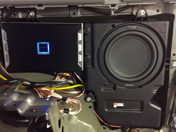

Looks like you replaced your amp, how did that go?
Did you do it for the sound quality or because your sub was blown? How does it sound compared to the JBL system? I assume is sounds better but how much? Do you notice the center channel missing?
I am obviously debating this mod. My main reason is to get rid of the Metra TYTO.
My sub as well as all the speakers are fine.
I'm like my audio and the factory system, well, sucks. Crossover point on the sub is way too high and very muddy. For an oem system of the time, I suppose it was okay.
I have much more control now. Crossover points as well as slope.
Parametric eq, time delay, HD & Satellite radio. Night & day.
The center channel speaker never made sense as your sitting off axis anyway. Time alignment fixes that part so it's actually better than before.
The factory amp just isn't enough power. Not because you can't turn it up, but there just isn't enough umph. No headroom.

Did you have to do alot of wiring changes to install the aftermarket amp? I'm all for improving on the system and your install looks really clean. I'd just want it to be totally OEM like and clean install you know. I've never done audio stuff, but I'm willing to learn.
I ran all new speaker wires to the doors. My choice. You can utilize the existing wire if you wish.
My install is totally stealth. The only thing you will see is the different screen in the dash.
Everything else is behind the normal panels.
