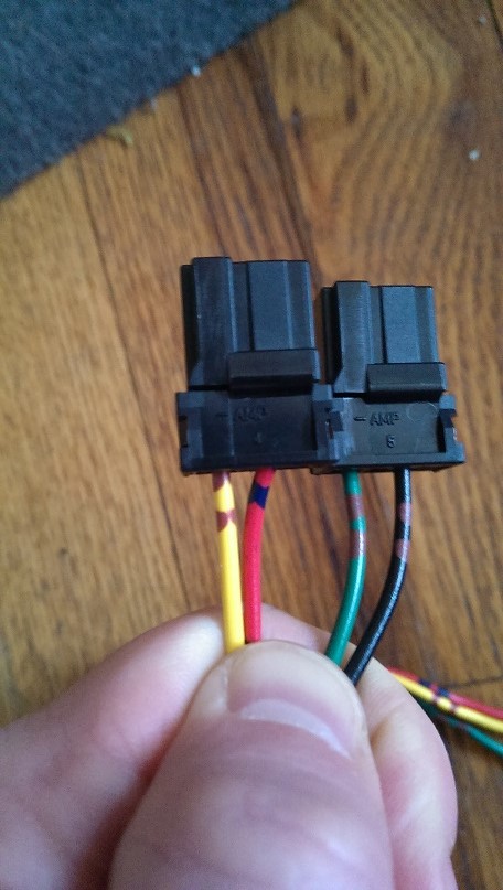

Can you comment or show what wires are + and - for reference.?

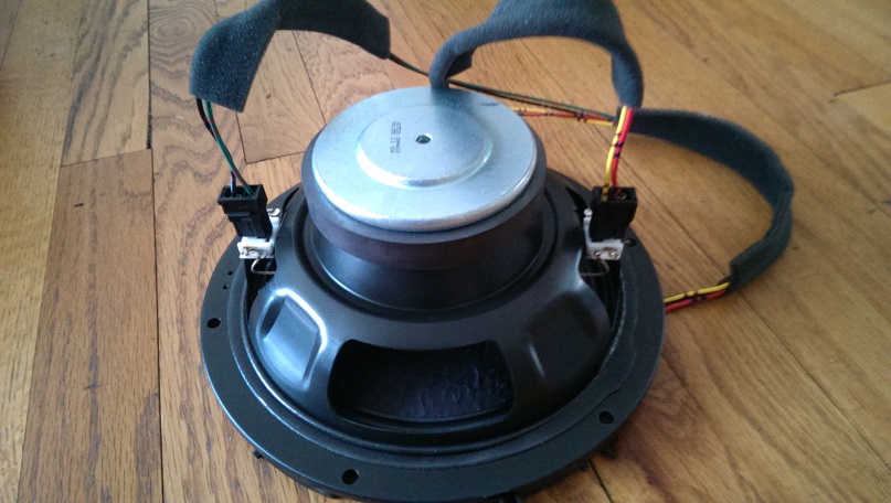

Here are pics of the two proprietary(?) connections you will find inside the sub box. The Yellow and Green wires appear to be labeled as Negative.
