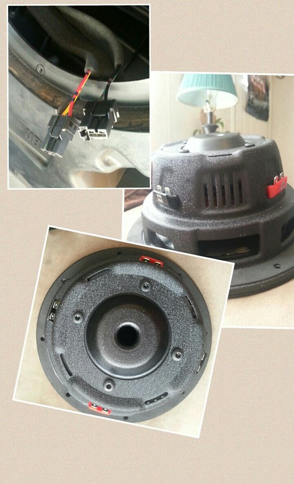

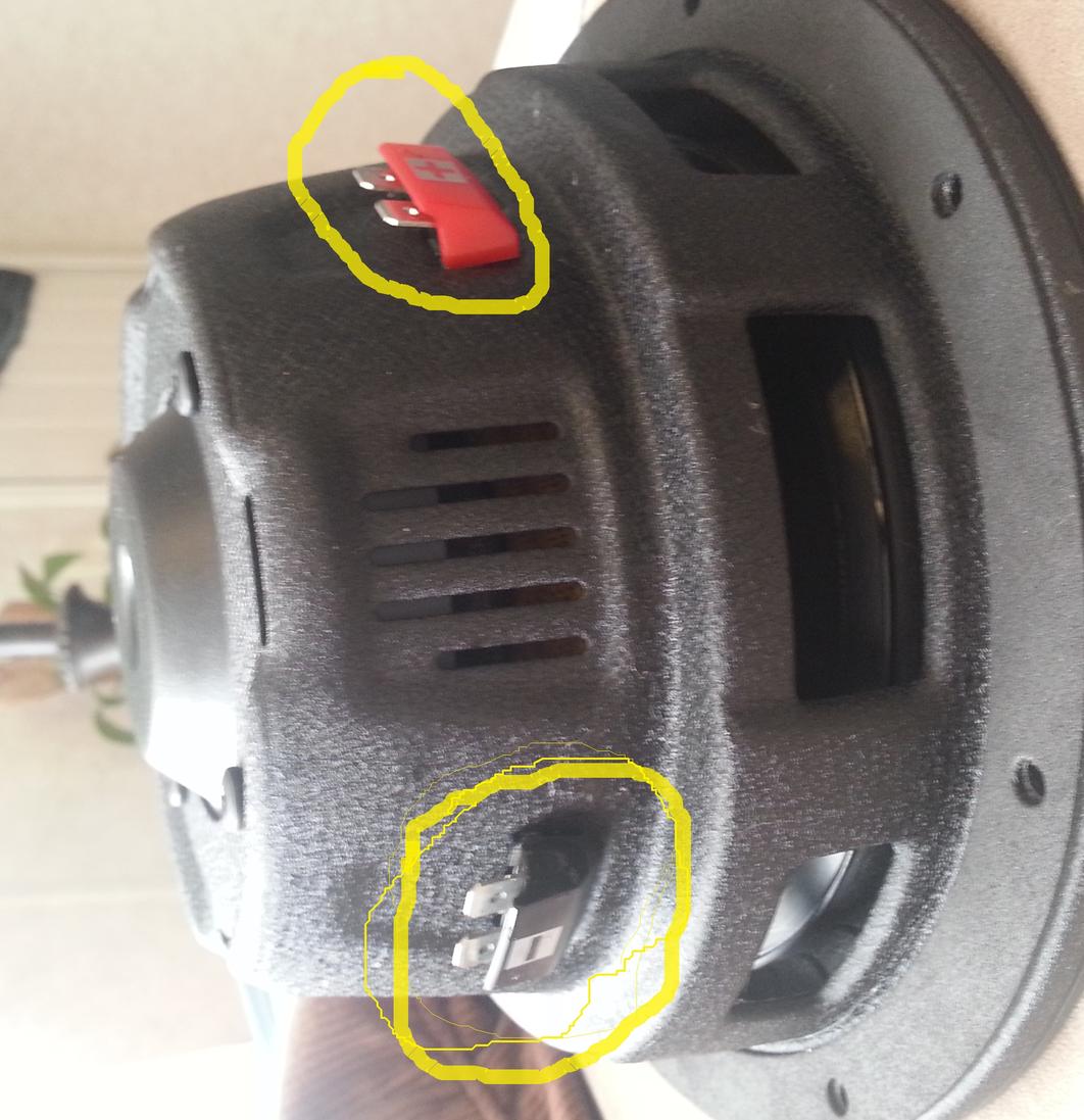

This is what I mean when I say 8- there are 2 black and 2 red connectors --> ea with 2 terminals --> thus 8 remember....FEMALE....

The pairs of terminals are probably just to make it easier if your going to run your voice coils in parallel. Your not so you only need to use one terminal per pair.
Right, there should only be 2 sets of voice coils, you shouldn't have to use all 8 connections, just 4, 2 pos and 2 negative, which is what is coming out of those 2 stock connectors
The posts here are encouraging and helpful. My original JBL subwoofer had disintegrated and provided fuzzy, scratchy bass. So I swapped in the Rockford Fosgate P3SD2-8 P|3 Shallow Punch Dual Voice Coil subwoofer. I am still using the original OEM amplifier. The new Fosgate 8" subwoofer was shallower than the OEM JBL 8" subwoofer that it replaced, so no cutting or shaving inside of the black plastic subwoofer enclosure was necessary. I placed the new Fosgate speaker into the hole left by the old JBL speaker and then used self-tapping screws (from Home Depot) to screw the new Fosgate subwoofer onto the black plastic housing that previously held the the old JBL speaker. The installed results look exactly like the Fosgate P|3 subwoofer pictures posted here. It sounds great! I'm very happy with the sound and even more thrilled with the help and guidance offered from this thread.
