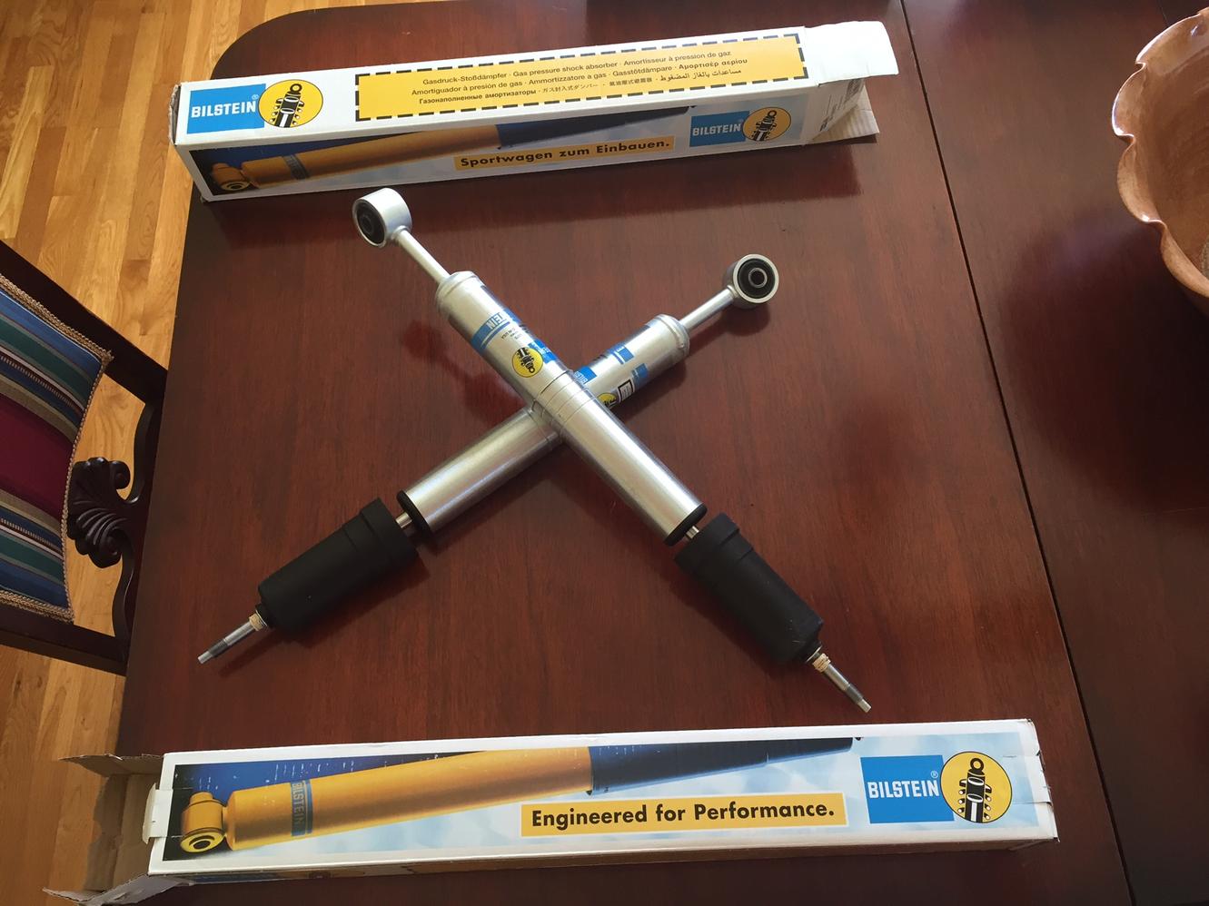

MODS Completed So Far:

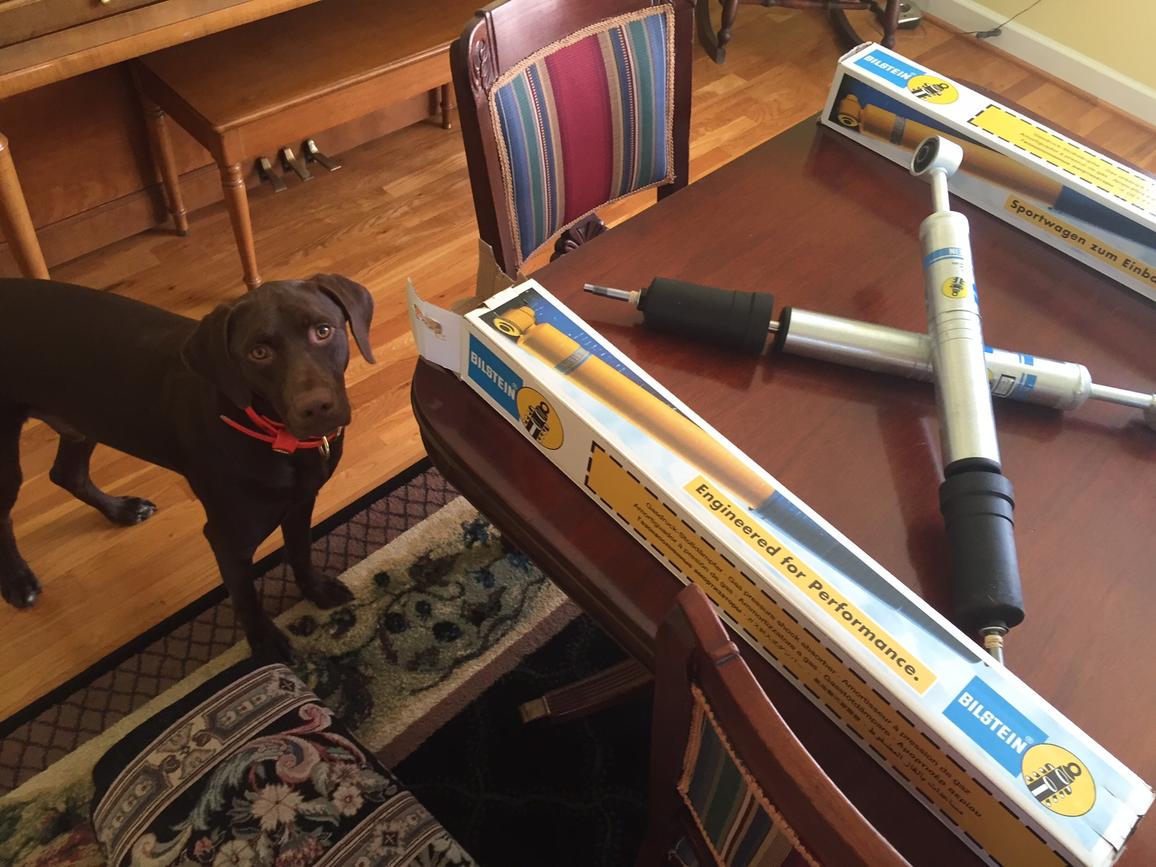

-Bilstein 5100's All Around
-Front OME 886 Coils
-Rear FJ Coils ($40 Shipped from forum member)
-Rear Toytec Spacer ($20 off Craigslist)
-2016 4Runner SR5 Wheels w/ Bridgestone Duelers ($300 off Craigslist)
-Yakima Railgrabs, Crossbars and Fairing ($75 off of craigslist)
-White LED interior light swap ($13 total with a few left over from Amazon)

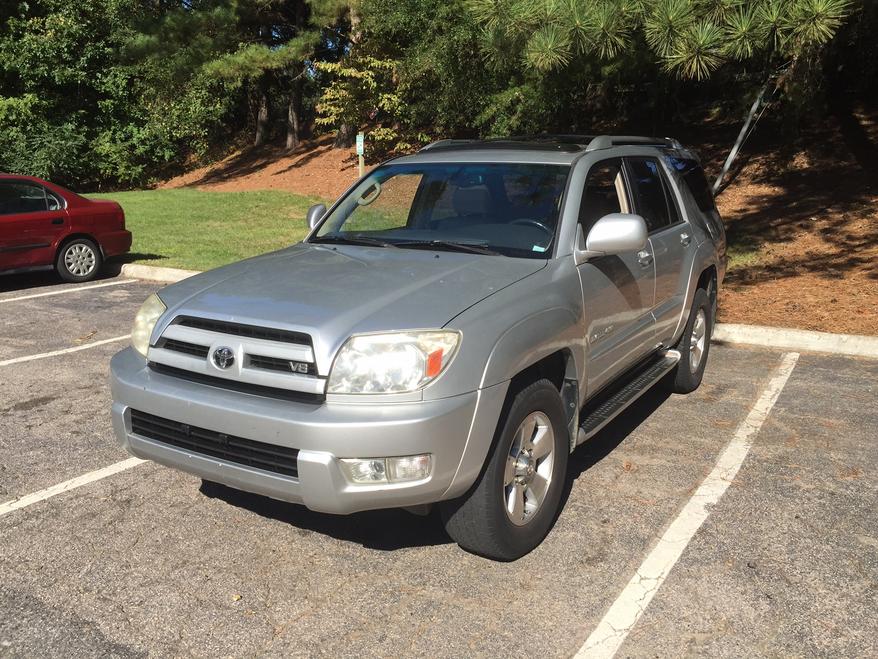

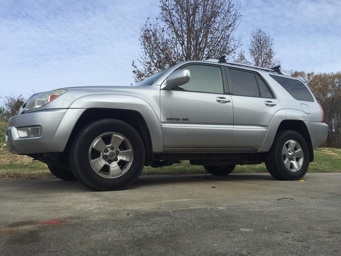

This was my 4Runner the day I got her, it was love at first sight!
Got some goodies in! (of course my pup had to make it in the picture)

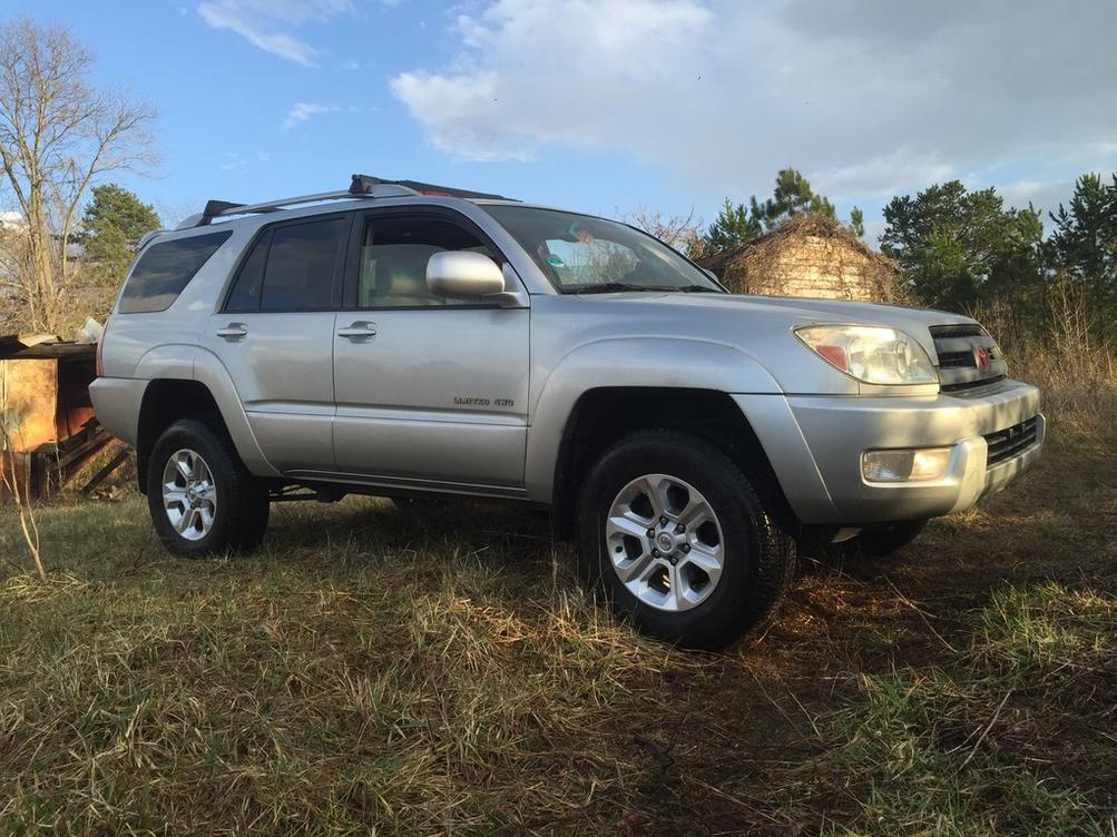

This was after I got my Yakima roof rack (fairing & 2 Crossbars). I stripped the actual Yakima lettering off and put my red T4R.org sticker in place of it. I also took the running boards and sunroof visor off but forgot to mention that.

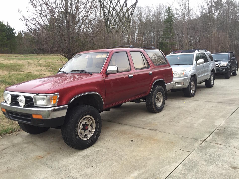

The red 2nd Gen is my old 4Runner, the middle one is mine and the last is a buddy of mine's.

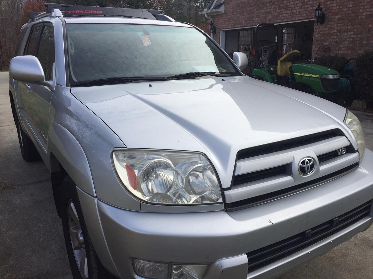

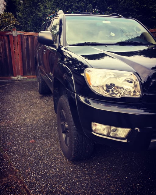

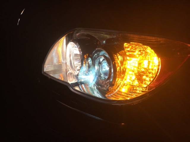

I just finished adding '06 headlights in preparation for my '06 satoshi grille. I was able to find an used '06 grille for ~$50. One of those fun projects that never happens thus far.
The new headlights are amazing, and the light performance is so much better than the '04. Despite the expense I think it is almost justifiable for my college budget
Best mod is owning it free and clear. I need to do that to mine :yo:
Those look great! Did you just pick up a used pair of OEM headlights and plug-n-play? I know a guy that has a cheap pair of the '06 headlights but I didnt know how those projectors would be. Did you put HID's in?
Pretty much plug and play. Marker lights require splicing a new harness onto the old one. If wiring like I did, would require LEDs prob. as well to keep the wattage lower. '06 headlights have both a marker light and a turn signal in the housing, I wired both as marker lights
Yes, HIDs. 5k lows, 3k fogs
I tried LED's originally but wasn't satisfied. The LED bulbs I selected only put the light out on two sides which resulted in an inadequate beam pattern.
If you had the time, I would retrofit a spare set of '03-05 headlights with projectors. The output is spectacular and far superior over the original ones but other projectors (lexus, acura) are higher quality and have a sharper/better beam pattern. It would require a bit more work.

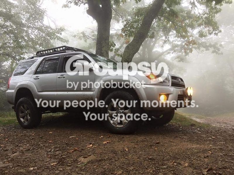

as far as finding cheap coils you can also add tacoma trd off road or sport fronts to that list. they add just over an inch alone or added to 5100's
if you can find them there are also fj trail teams springs
im running 5100's on .85 with trd off road coils and fj rears.

I was actually not satisfied with the LED output, it didn't feel like the down-road output was as high as halogen. SOCAL LEDs has a bulb that looks to be better designed as it has 360° output. The SOCAL ones were highly recommended by other forum user, haven't personally tried them. The OPT7 ones felt like quality, I just wasn't personally satisfied. Part of that may have been I didn't have it correctly aligned maybe? Can't comment on the conversion to 9011/2.
As far as worth ~$300-400, for me it was. Post-lift with stock housing, I felt that the light output was inadequate as compared to before. By the time I aimed my headlights low enough where I wasn't blinding other drivers, I was no longer lighting down the road. Switching to a projector housing let me line up the lights where they should be as the sharper cutoff was designed for that. I know have light on the road where it needs to be, and no angry drivers. Increased both my safety and those around me by using better headlights. Granted, there are better designed projectors. But the stock '06 is better than reflector. I used OPT7 HIDs for the lows and am satisfied.
As far as the bumper pieces, as seen in the write-up there is one screw and than they (gently) slide off. The install is super easy overall, one of the screws is a pain to get to, but not terrible. I ended up leaving it off for now, I'll reinstall it later. Again, super easy and you don't need to be mechanically inclined. Most difficult part was prob. wiring the parking lights because the stock wiring is so thin and I didn't have a good wire stripper. Still pretty easy.

I ended up putting in some TRS LED bulbs. I had heard that the LEDs don't throw enough light or aren't bright enough, but honestly, I have had zero complaints. Sure it could be brighter, but that would likely require HIDs. I am happy with the LEDs and super happy with the performance of the projectors.
