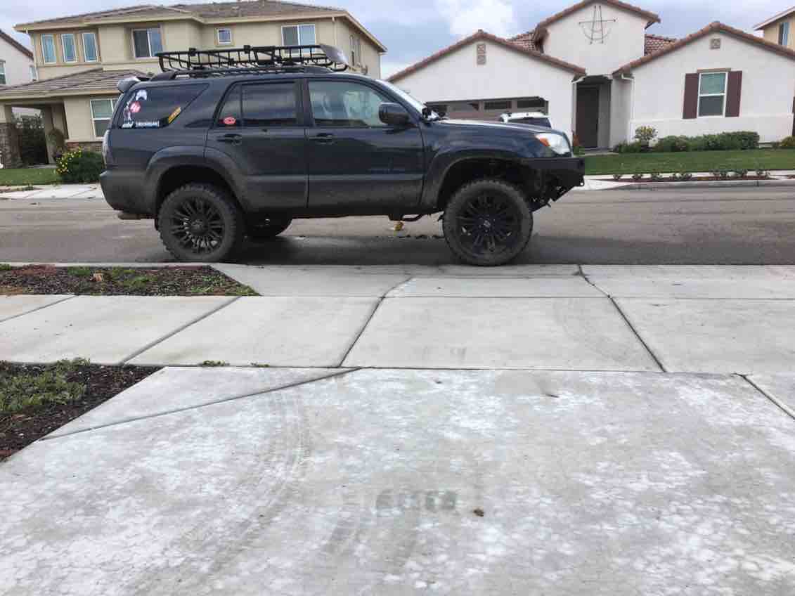

Yea, I've got the V8. Do you have the 886's? If so, what shocks do you have and do you have a front bumper? Would love to see some pics so I have an idea of what to expect.
Honestly, I have been slightly disappointed with the 5100 setup so far. The ride is definitely not as good as I was expecting when I purchased them, but they aren't too expensive so I can't complain much. I'm hoping that the ride and look will dramatically improve when I switch from OEM coils to aftermarket.
I'm running the 886 and 5100's also. Ride is kinda meh but I don't mind it. I'm currently cali leaning because I've yet to put in new rear springs and I'm running a front Demello Flat Top no winch yet.
The lean will be fixed when I put in the 3" Metaltech shocks in the rear next month

Here's a crappy pic of the front after I finished the install. Don't happen to have another :/
Yea that looks really good, I don't mind the rear being a tad lower than the front. Probably because mine is lower in the front right now but I want to try to get it as even as possible. Funny that you call it the Cali lean, down here it's called the "Carolina Squat".... lol Still can't believe that's actually a thing...

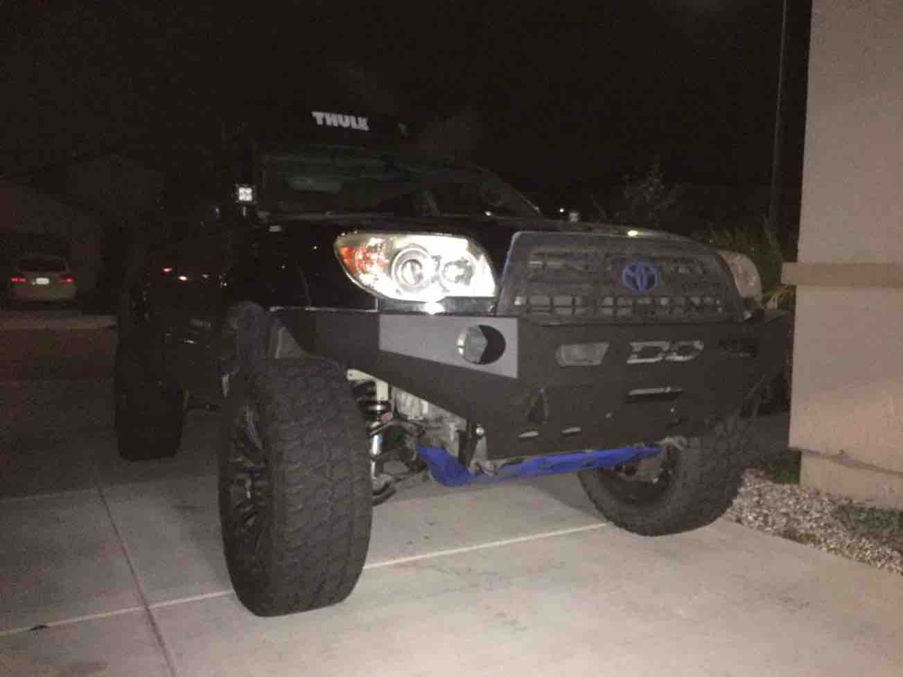

Finally had some time to post an update.

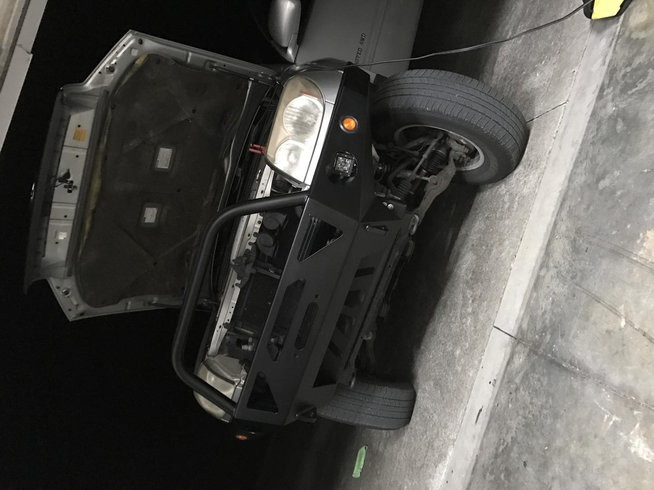

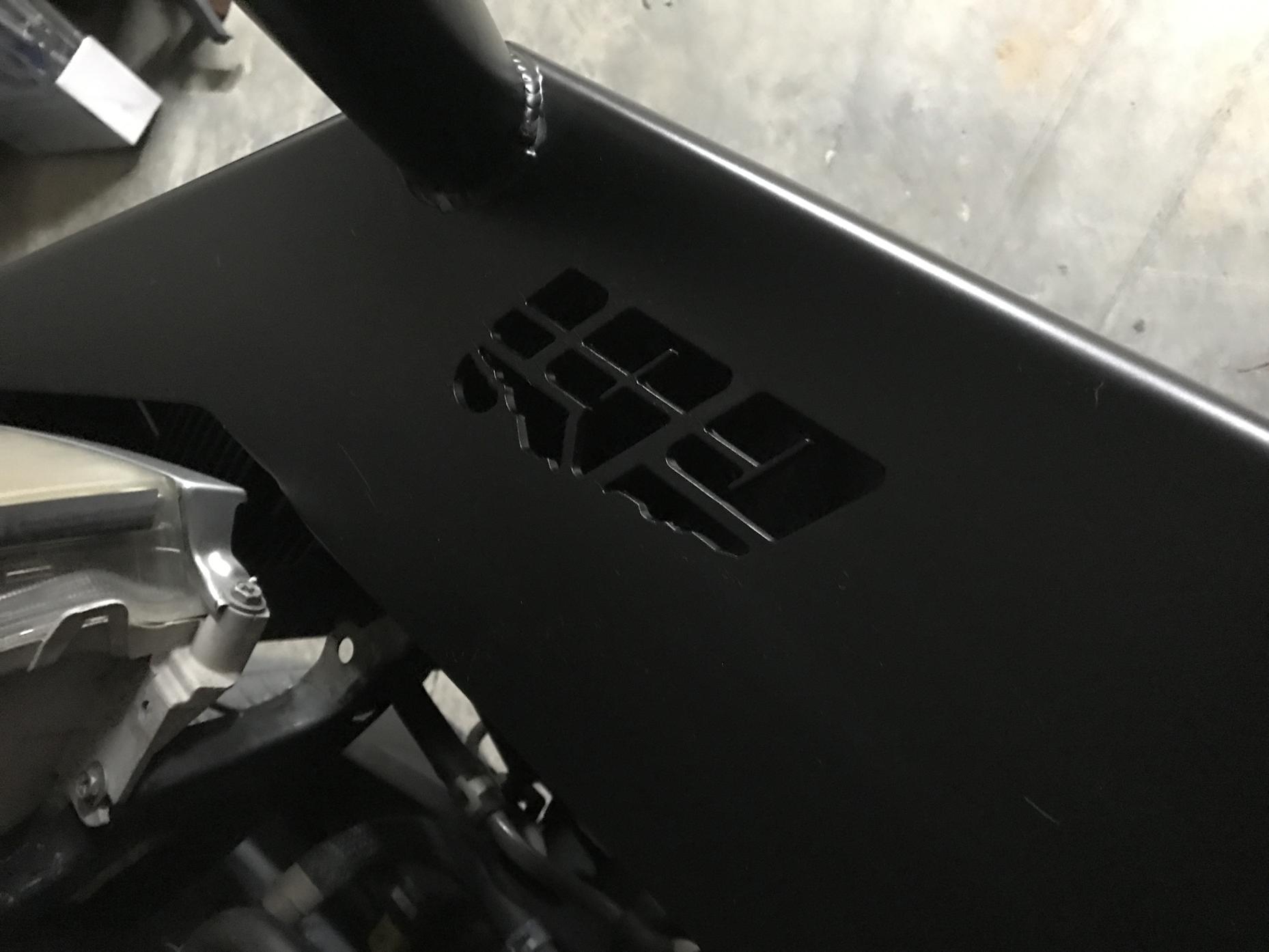

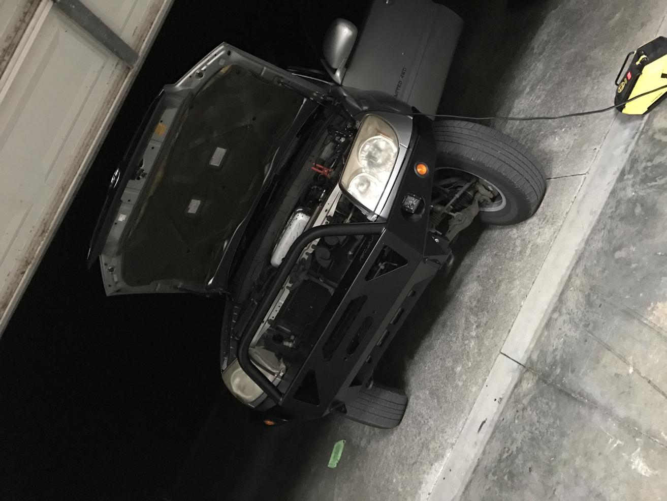

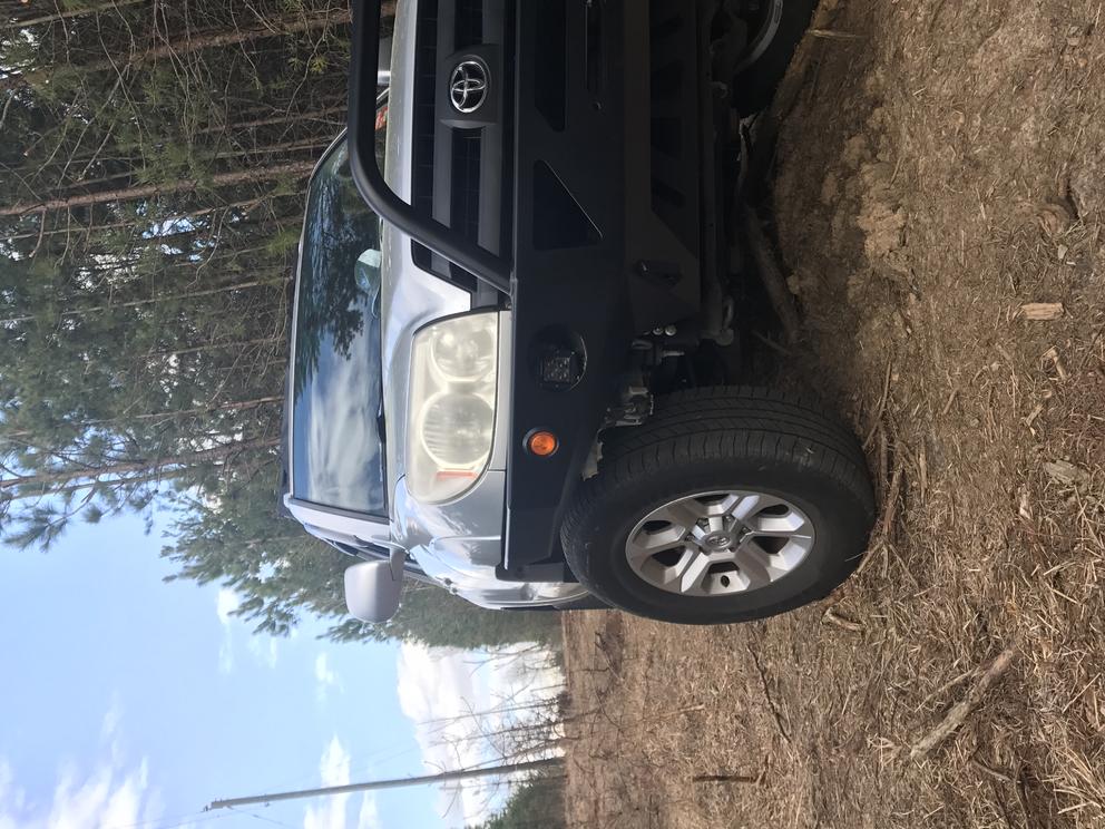

So, I recently received and installed a CBI Front Bumper, and am really happy with how it turned out. The only thing I will say is that the bumper protrudes out a little more than I was expecting.
To handle the additional weight from the bumper I went with OME 886s, and I am really glad I did. I was debating between those or the 885s and I think I would have been disappointed with the 885s. I installed the springs the day before the bumper and could not notice much difference between the height before the bumper and afterwards.

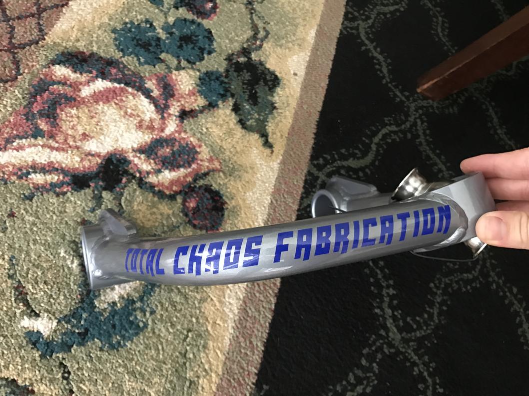

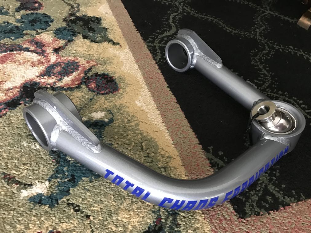

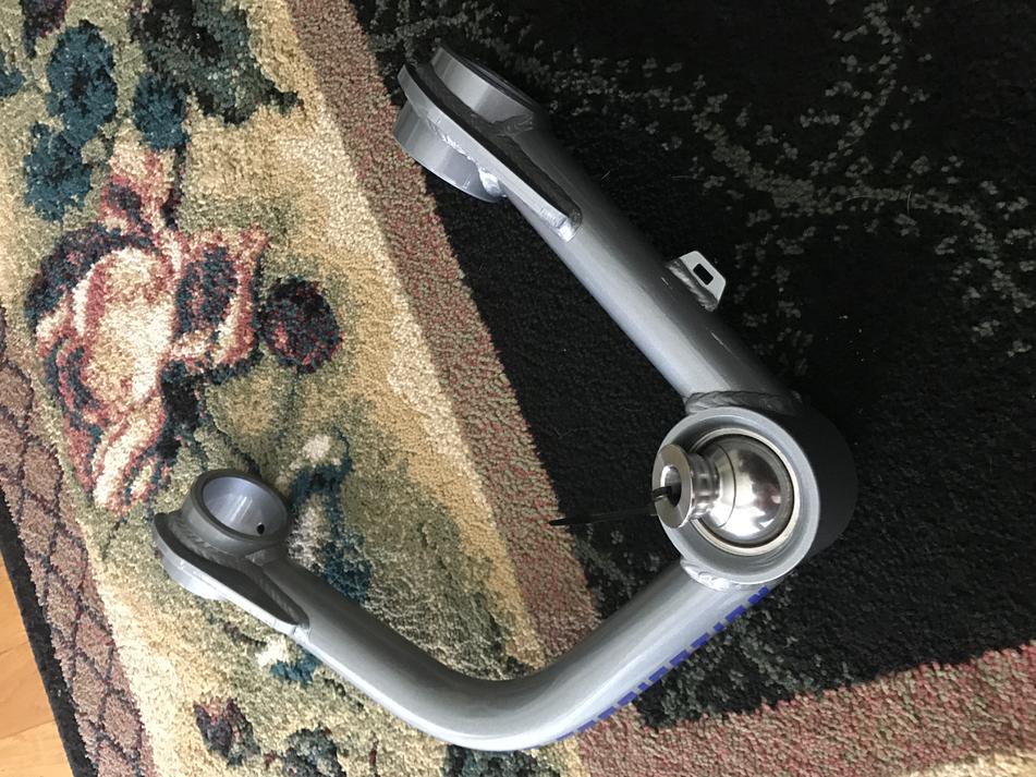

After installing the bumper and new springs I realized my upper control arms ball joints were completely shot, so I decided to just go ahead and replace the entire UCA. I figured with the 886's and front bumper I am in need of something a little beefier anyway.
I deliberated for a while on which set to go with; mostly between Total Chaos, Dirt King and SPC. I couldn't decide if I should save some money and go with the ball joint SPC set or go ahead and spring for a uniball set. After reading about the issues SPC had with earlier generations, the issues with squeaking, and how some people were still having to replace the BJ's every now & again, I decided I would bite the bullet and get a uniball set.
So I messaged Mike at Offroad Warehouse on here (great customer service, btw), and he was able to offer me a set of Total Chaos Uppers for $620 shipped!!! I couldn't refuse that deal!!
I also talked to a guy in one of our local T4R groups that owns an Overland store, because he usually price matches, and I try to keep my money local! But he wouldn't price match this time because - and I quote - "If that price is shipped, they are loosing about $40 a set." I definitely know who to go to next time I need the best deal on parts!

The Total Chaos UCA's came in, and let me tell you, these things are beefy! I spent a lot of time debating between these or SPC to save some money but I'm definitely glad that I went with TC. Now I've got to get the axles ordered from CVJ and hopefully I will be done fixing things so I can focus on protection.
