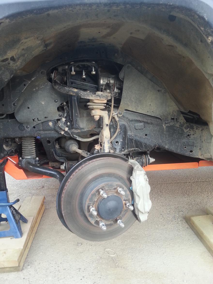

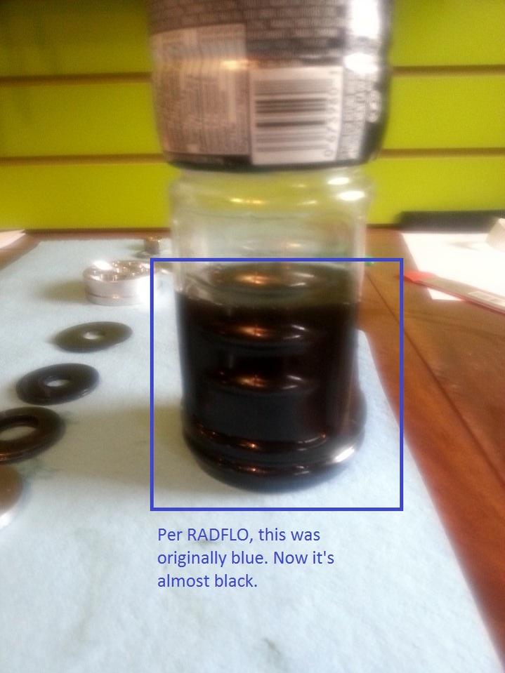

Last night I pulled out the radflo coilover assembly, which was pretty easy by the way. I tested the movement of the upper/lower control arms and as suspected there were no issues, thus narrowing down the issue. I put the spring compressors on and began disassembling the shock. I got to the point where my coil is removed and the nitrogen and hydraulic oil is drained. I couldn't get the top 'head' off which is required to remove the cylinder/shaft. I plan on calling radflo today for detailed instructions. The hydraulic oil was almost black in color, not yet sure if this is normal. Compressing the shock with no spring on it was 'choppy' and felt like it was catching or something. Right now I'm leaning toward a sticky valve. I plan on doing the rebuild myself. Only thing I'm concerned about is the nitrogen refill...i'm hoping somebody in town is willing to help. If not, I suppose I'll build my own kit.
The last time I spoke with radflo they told me that they do not use synthetic oil. I figure this is a big issue for me since -40degree weather in the winter here is not uncommon...definitely can explain my harsh ride in the winter and perhaps a busted valve? Maybe [MENTION=66316]1engineer[/MENTION] will chime in. Anyhow, more to come. I might start a new thread on the rebuild process since I can't find anything on the web specific to the radflos.

I'll be happy to help but let's see what Radflo sends you first. Hydraulic fluid coloring means nothing unless you know what color it was to start. Does it smell slightly burnt?
Synthetic fluid in a shock would be nice but due to a shock's duty cycle (continuous extension/retraction) standard fluid will heat up to nominal operating condition in just a few minutes. Also there are additive packages available for petroleum based fluids that are perfect for shock applications. The nitrogen precharge should be pretty easy to do but you have to know what the precharge pressure is and be able to charge precisely to that pressure. Let us know.

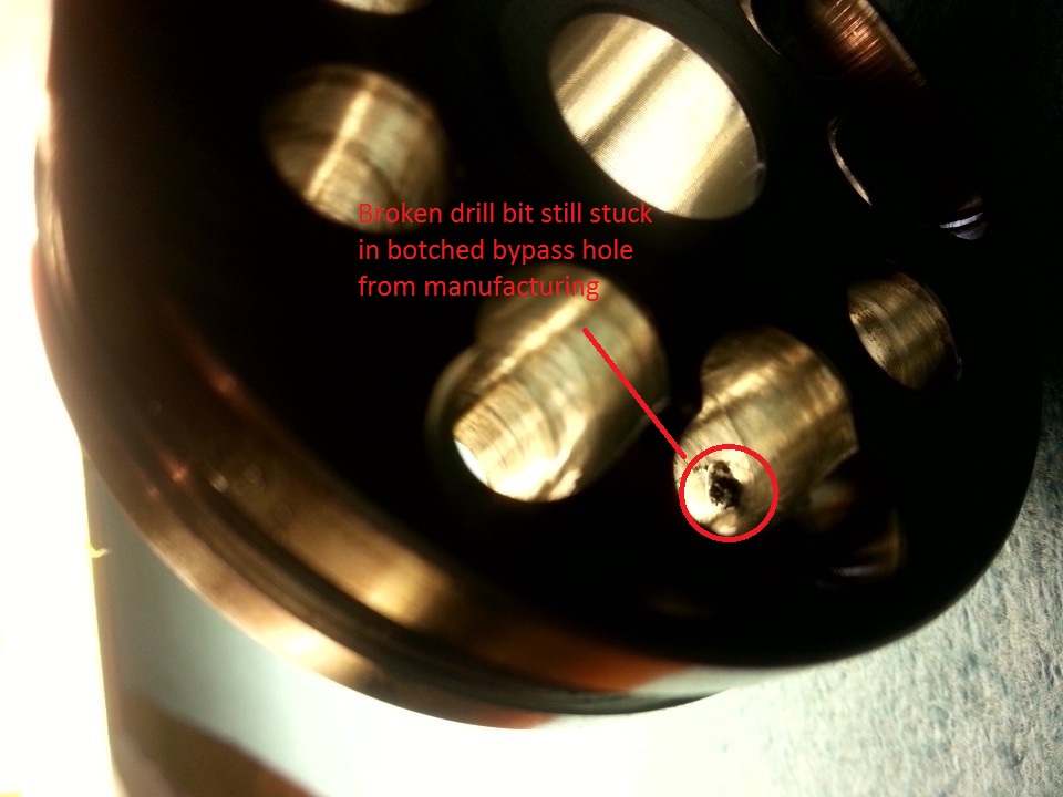

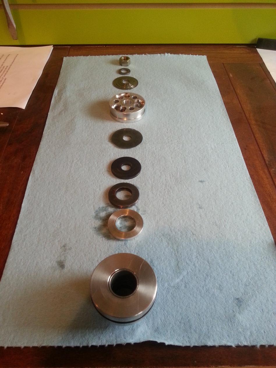

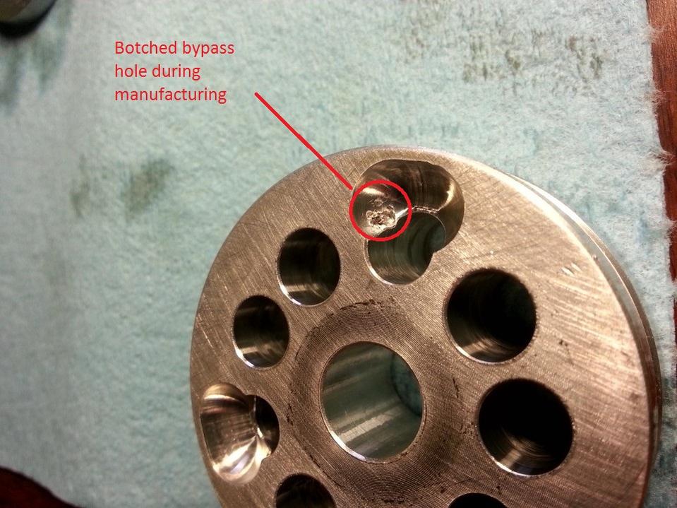

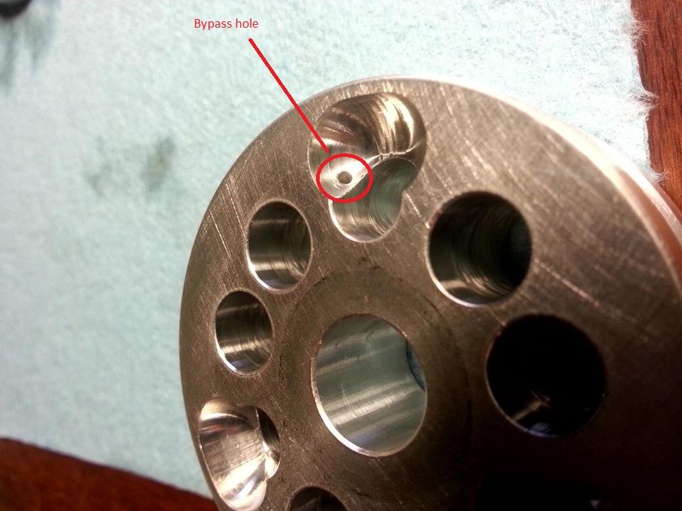

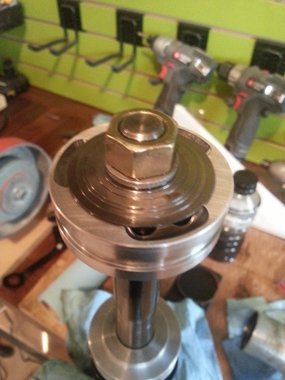

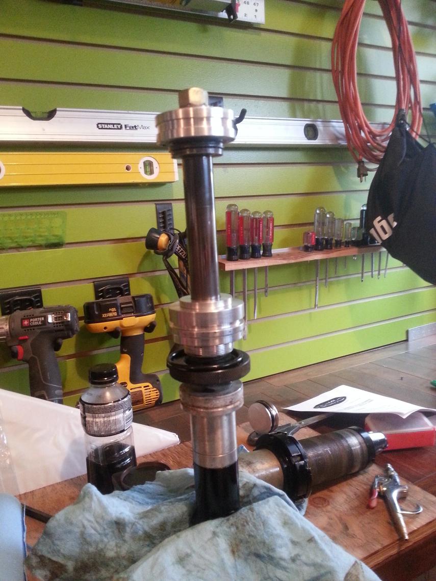

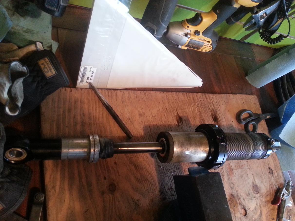

Ok, so after speaking with RADFLO today and getting them to send me the rebuild instructions, I was able to disassemble the entire shock with ease. Upon initial inspection everything looked ok.....until....

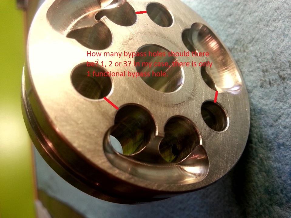

Take a look at the 'valves'. There are a couple, what I call, 'bypass holes' drilled between adjacent holes. One of them was completely botched during manufacture; they even left a broken drill bit tip in the hole! unbelievable.
Anyhow, I'll talk to RADFLO again tomorrow, but do you guys know if there are meant to be 1, 2 or 3 of those bypass holes?
The fluid has definitely changed colors. Per RADFLO, their fluid has always been blue in color.
Also, while my friend and I were working my friend had an epiphany. He remembered that when we released the nitrogen, hydraulic fluid came out of the release/fill port (actually all that fluid you see in the bottle). The way I understand it, the floating piston is meant to seal the hydraulic fluid from the nitrogen and there should be no intermixing between the two?
If I'm assuming correctly my thought is this: The botched manufacture of the valve perhaps over pressured the shock causing the hydraulic fluid to bypass the seals into the nitrogen chamber thus 'jamming' it up. What do you think?

Great pics and feedback. And excellent work with the shocks. I hope Radflo stands by their product and makes the replacement parts available to you ASAP.
I'll bet you want to pull the passenger side out now huh?
Yes but it will be dependant on a few factors. 1. How easy this rebuild ends up being. 2. How the newly rebuilt shocks feels in comparison to the passenger side shock. 3. Whether I feel like it or not.
I think you'll be surprised. The hard work is done.

I'd press radflo for a washer stack specific to your vehicle,

From what I understand, since these are the overland warehouse trim coilovers, they were specifically designed for modified 5th Gen 4runners.
Good find, sorry you had to go through all that work. Good write up tho. All the nonsense about KDSS...makes it funny it had nothing to do with it.
