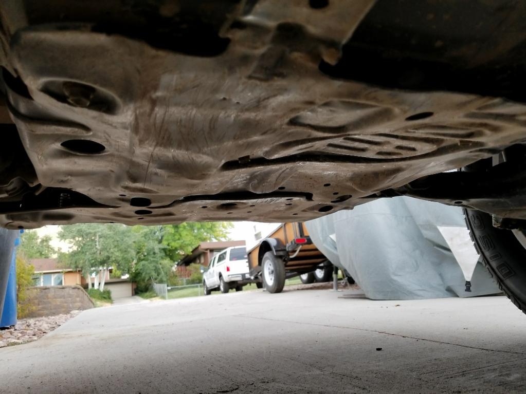

One thing I read after I purchased my ORP with kdss is that kdss equipped vehicles have lower ground clearance. Is this true? Clearly not advertised by Toyota. My manual still says 9.6”.
Is the only difference in ground clearance a lower skid plate at the front only, to accommodate the kdss pistons? I measured mine last night and at that point I measure 9” even. Not a huge difference, especially considerekng the wheel hubs are around 8” or so , and that’s for both kdss and non (doesn’t change).

No. Grab a tape measure. The TRD Pro skid fits over the KDSS sway bar (with side cutouts. You lose no ground clearance. It's an optical illusion because it sits further forward.
It's not the lowest part of the front suspension. It does reduce the approach angel relative to that front part of the suspension. So it does sometimes bang on stuff. But it fits under the TRD Pro skid, so in that comparison it's identical.
Here's a level picture of the OEM KDSS Skid. You'll note that from a level position it's the same as the rest of the front diff area.
20150530_131448.jpg~original
Here's a pic of the KDSS skid from the rear looking forward. (Yeah I beat the shit out of my skids. They work. I have switched to a TRD Pro front skid.) You be the judge of whether it reduces ground clearance.

doesn't the pro skid sit close enough to the sway bar that it has to be modified? the stock one has loads of space between the skid and the sway bar
You have to cut the sides out for where the bar passes. But it bolts in to the same spots in the same way. The lower part of the TRD Pro skid is the same. The original TRD Pro 4runners had KDSS, but it was dropped before production.

KDSS reduces your ground clearance by about 1". A friend of mine who I wheel with has a trail w/ KDSS and he is getting rid of it because of the ground clearance issues. If you dont go offroad, the KDSS will probably be a benefit, but its actually a limiting factor out in the dirt.
This is wrong. It's not a guess or opinion. Have you ever looked? It takes about 2seconds to look underneath and verify.
It's kinda remarkable you didn't even look up five comments to see pictures of the fact that it doesn't change ground clearance.
