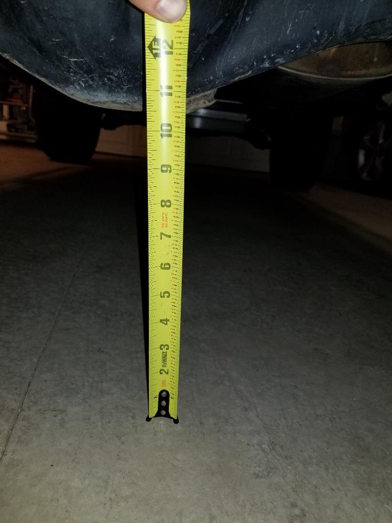

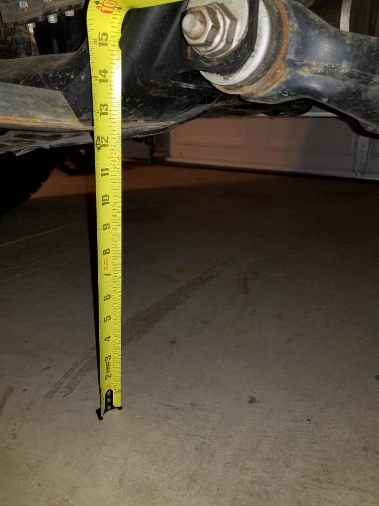

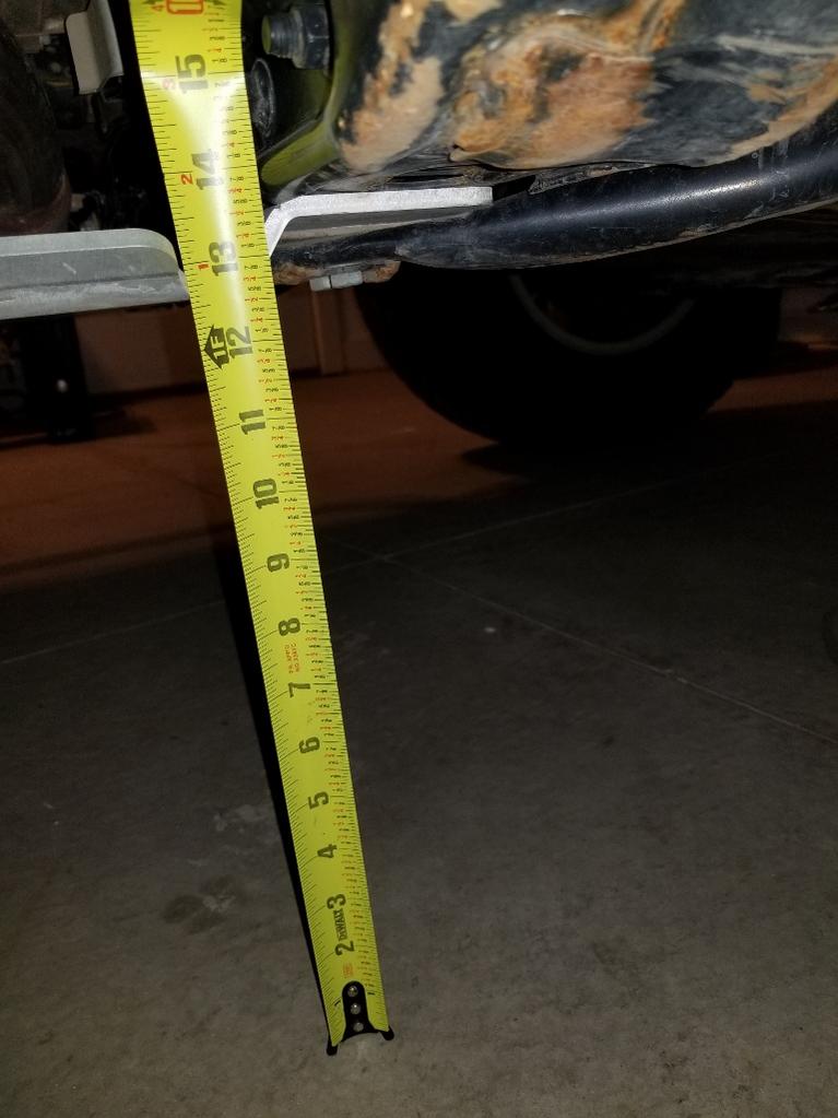

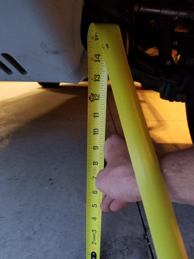

All you need to know is shown in the pics I already posted.
Unless your answers are different from mine - KDSS does not lower ground clearance. If they are - we need to investigate further because your 4runner must be a different model from mine.
But, just to further clear up any confusion, here's a few that should help. These are of my 4runner with ~ 2 inch lift and 34" tires. The photos show in order: Front TRD Skid (with KDSS), front IFS cross member at rear, transfer case skid lowest point, and rear differential. As you can see, the rear differential is the lowest point. And more importantly the KDSS is inside the TRD skid plate - which is also level with all the rest of the front end skid plates.

I agree in general. Everyone's setup is different. The pics were just for reference that the front skid is not the lowest point on most 4runners. The rear differential is.
With respect to disproving the claim that KDSS lowers clearance - you don't need to measure anything.
  • Ground clearance is a measurement from the ground to the lowest point.
  • Unless KDSS is the lowest point - or causes the lowest point be different from non KDSS models - it does not effect ground clearance.
  • KDSS fits above the TRD skid plate in the normal mounting position.
  • Therefore it does not change ground clearance.
It's an illusion because of where it sits slightly forward of the front IFS crossmember. I agree that if you go out to the dealer lot - it looks like it sits lower. But the KDSS skid is flat and level with cross members. It is the same as any other model in ground clearance. So if someone says they compared them, or measured them, and found a difference - it's only due to suspension setup or tires. Or they didn't look closer than a cursory glance.
Edit: yes, KDSS and non KDSS models do have a different front skid plate. The earlier picture I posted was of my OEM KDSS skid from the back side - showing that it is in fact level with the other engine skid. It just takes a quick look underneath to confirm that this is the case. It's level with the rest of the skids. That doesn't mean you won't bang in on stuff sometimes. It has a lesser effective approach angle relative to the tires, so occasionally there will be something you'd miss with the nonKDSS steel skid you'll hit with the KDSS skid. The TRD Pro skid actually extends even further forward than the KDSS steel skid at the same level - making it the worst of the bunch in this category. So if you were trying to swap 4runners as someone had mentioned earlier - going to a TRD Pro will make it worse. Only a non KDSS Trail or SR5 would offer some marginal improvement. But even a 1/2" lift or kicking your passengers out would make more difference than choosing another model. None of them have different distance to the ground.
