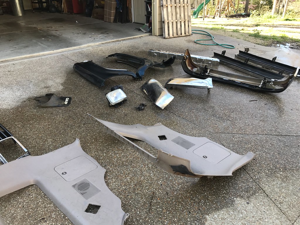

Cue my driveway with parts!

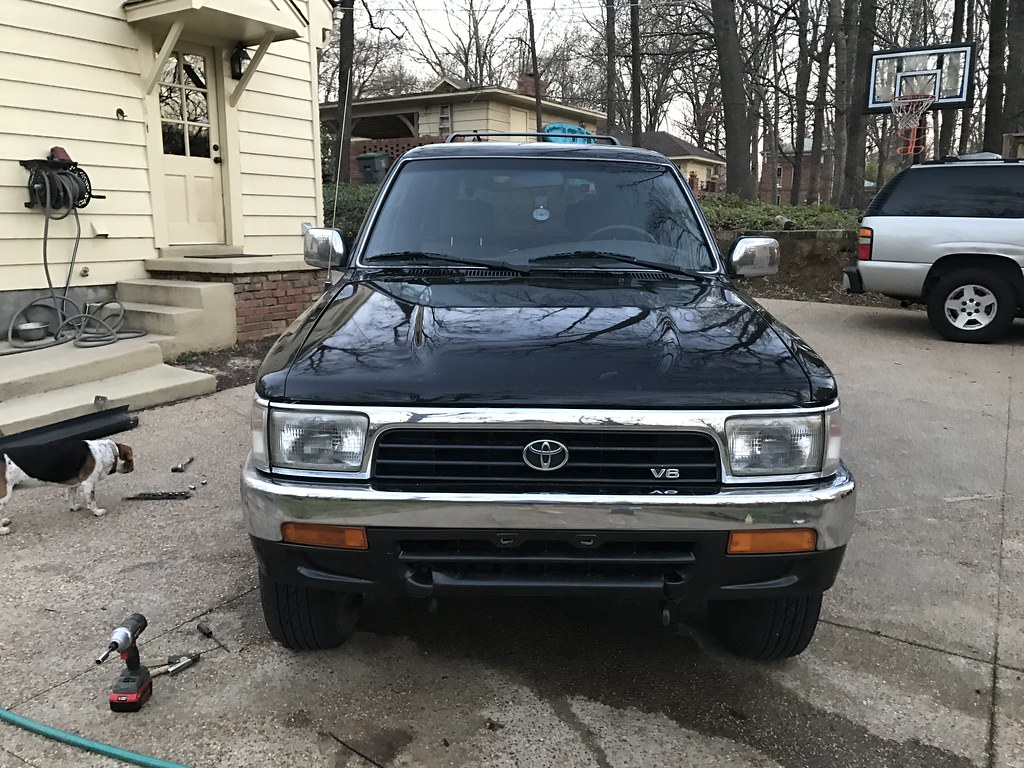

Before V6 grille, falling out (!!!) side indicators, and the floppy passenger side headlight:
After:

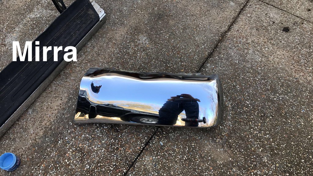

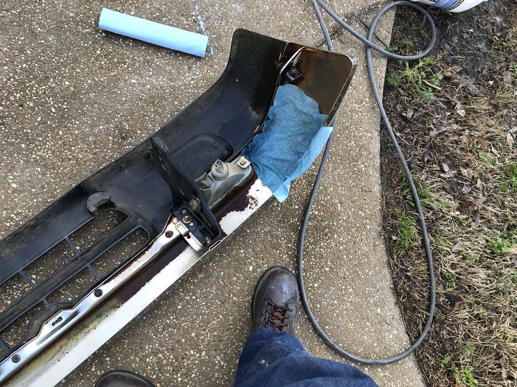

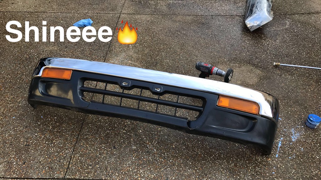

I then started work on the front bumper. I pressure washed all the crap off of it, and buffed the foggy spots:
And killing the rust behind it:
An hour later with the front bumper:
And with the rear bumper panel mine has had beat to death:
I did get that top dent out, thanks to a 2x4.

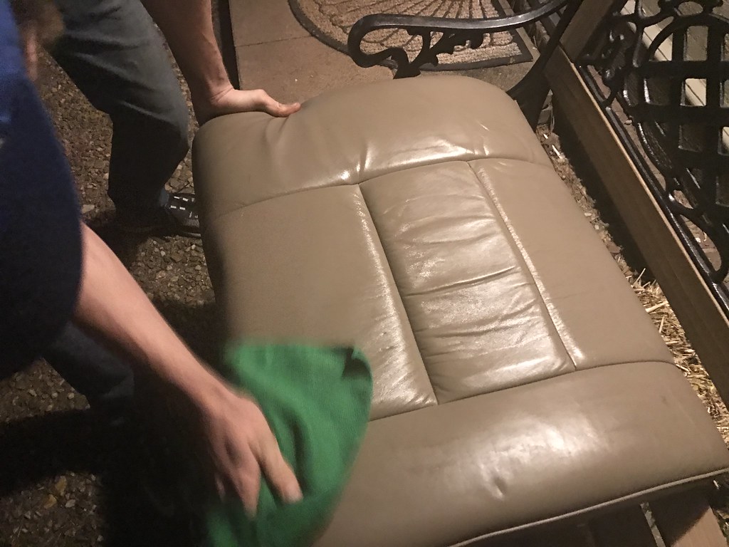

Also, from the parts vehicle, I got a nice set of rear leather seats:
Not sure how much I like them since the cloth is nice in the summer. If anyone close to the midsouth area wants some nice rear 2nd gen leather seats, shoot me an offer.

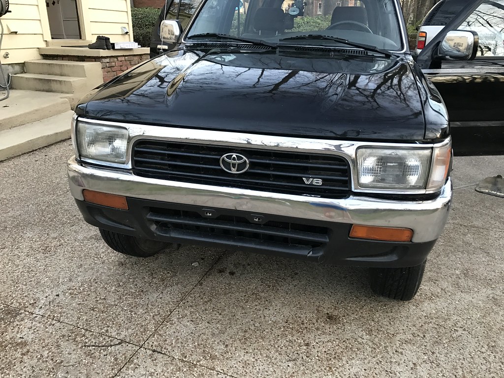

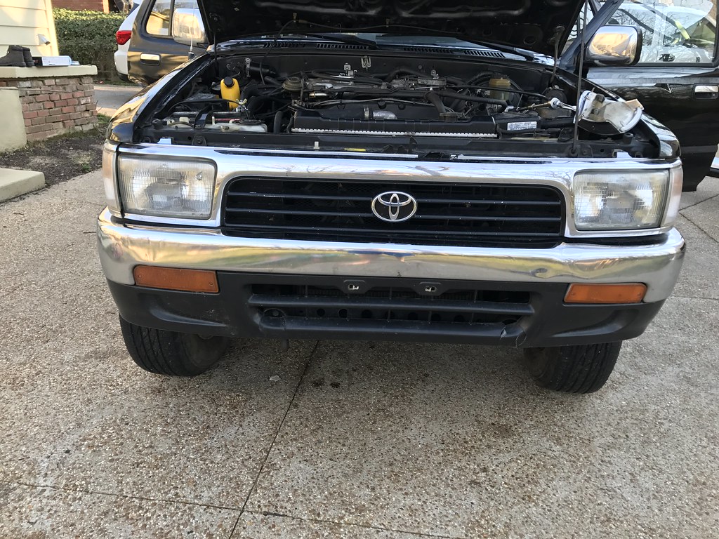

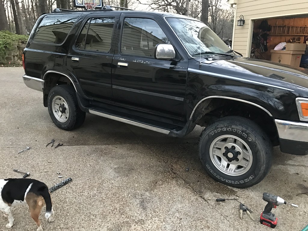

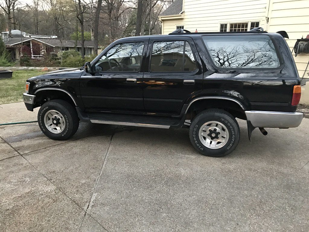

Finally! New bumper on. The passenger side mounts where pretty messed up, but a BFH changed their attitude. Plus, some extra pieces from the donor car helped where there were missing mounts (like the top most, rear bumper mount was gone!!)
Looks so much better:
There is still a small, bent section I need to fix on the bumper (compare blinkers). But, the top section where it meets the grille and side indicators is level, compared to my old bumper:

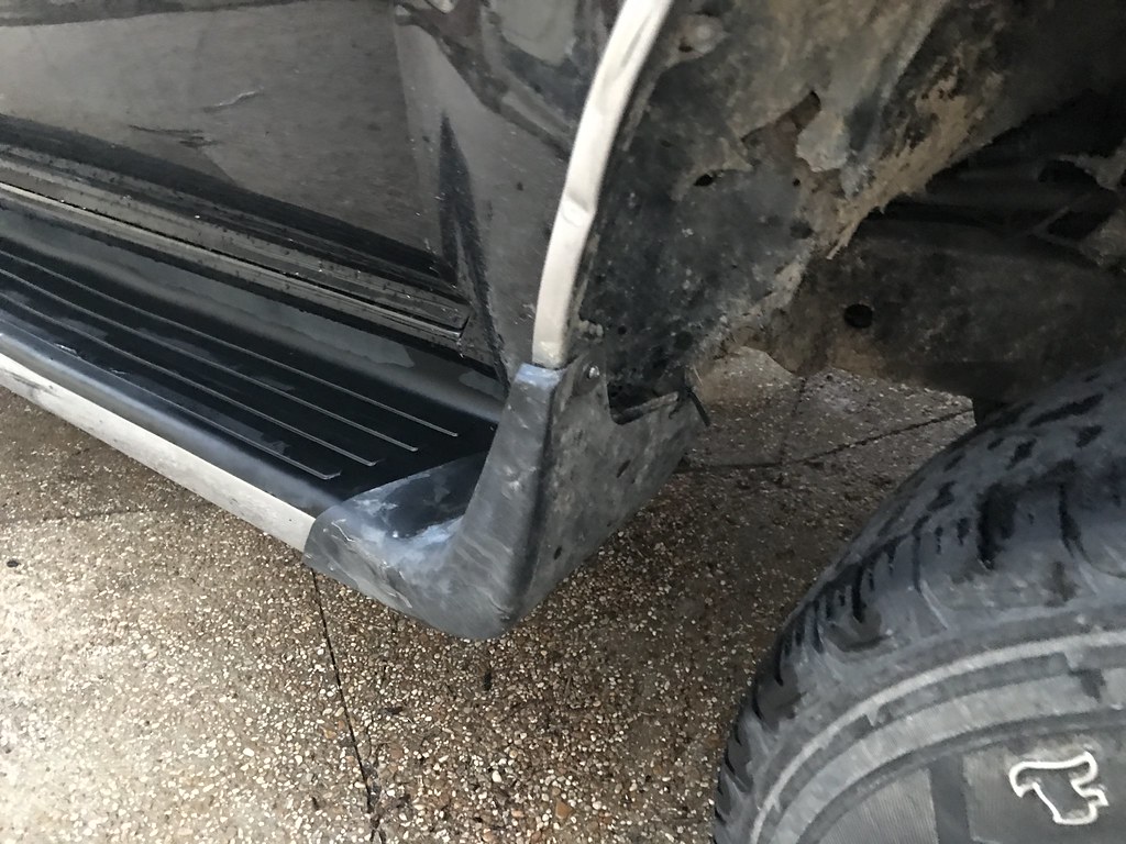

Also, new chrome running boards all around:
Used a toggle bolt, washers, and a ziptie to secure this trim piece until I repaint and install my new fenders:

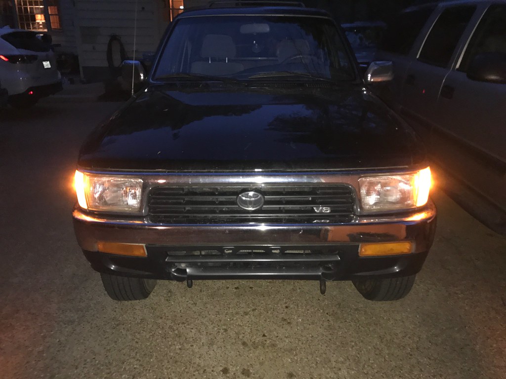

Long time no post! Nothing crazy here, I did replace the side markers bulbs with LEDs, and it made the car look much cooler at night:

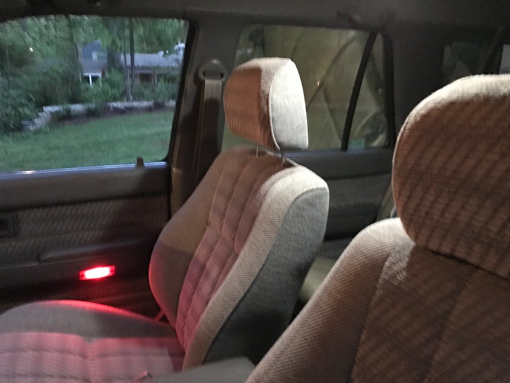

I did finally get my dome light working after a long time of it not working:

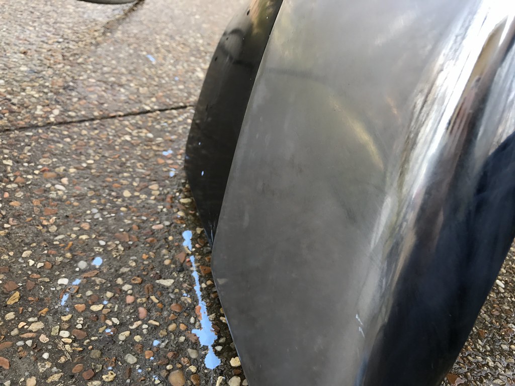

I just noticed that you did the body work yourself. Looks good.

Yeah, its just a bit off, the curve isn't quite right on the corner, but overall, its pretty good. That side was the side t-boned so I had the ability to get in there and fix some of their laziness.

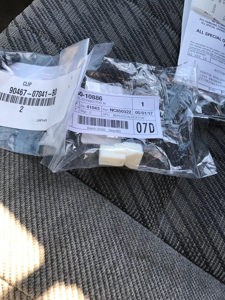

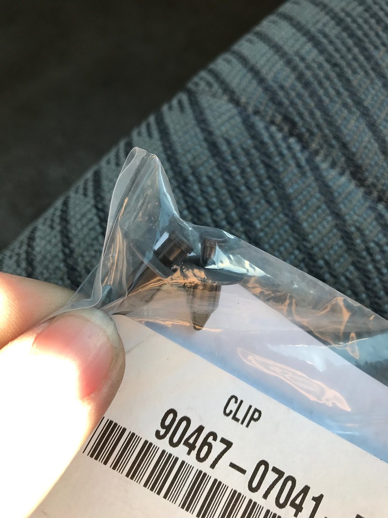

I love me some OEM parts. I love the parts guy at my Toyota house. He was asking me today when I'm graduating, and even asked about plans ahead (told him about my trip). All around solid dude. Got me a parts acct. so my VIN and part history is saved in the computer. A week ago I ordered the map pouch clips:
...and my Knock sensor wiring harness connector.

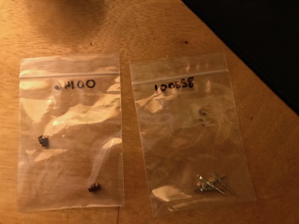

The dealership wanted $20 a piece for the wires coming out, so I said no and took a gamble building my own. I found the right pins and seals from Ballenger.
I put the connecters in and I heard the lovely *BEEP* from my multimeter confirming the pins made contact.

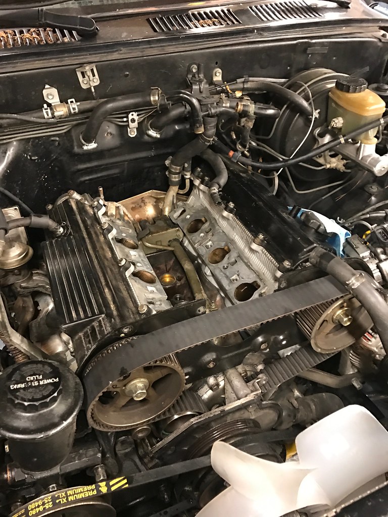

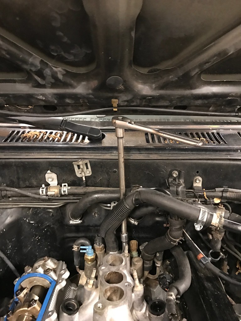

Began tearing it down today, and called it quits because my back was hurting and I was out of patience setting the timing belt stuff back up. Heres the two non-hose related pics:
Could NOT find my oil leak! Everywhere was dry!
Hopefully tomorrow it'll be all back together and working again!
