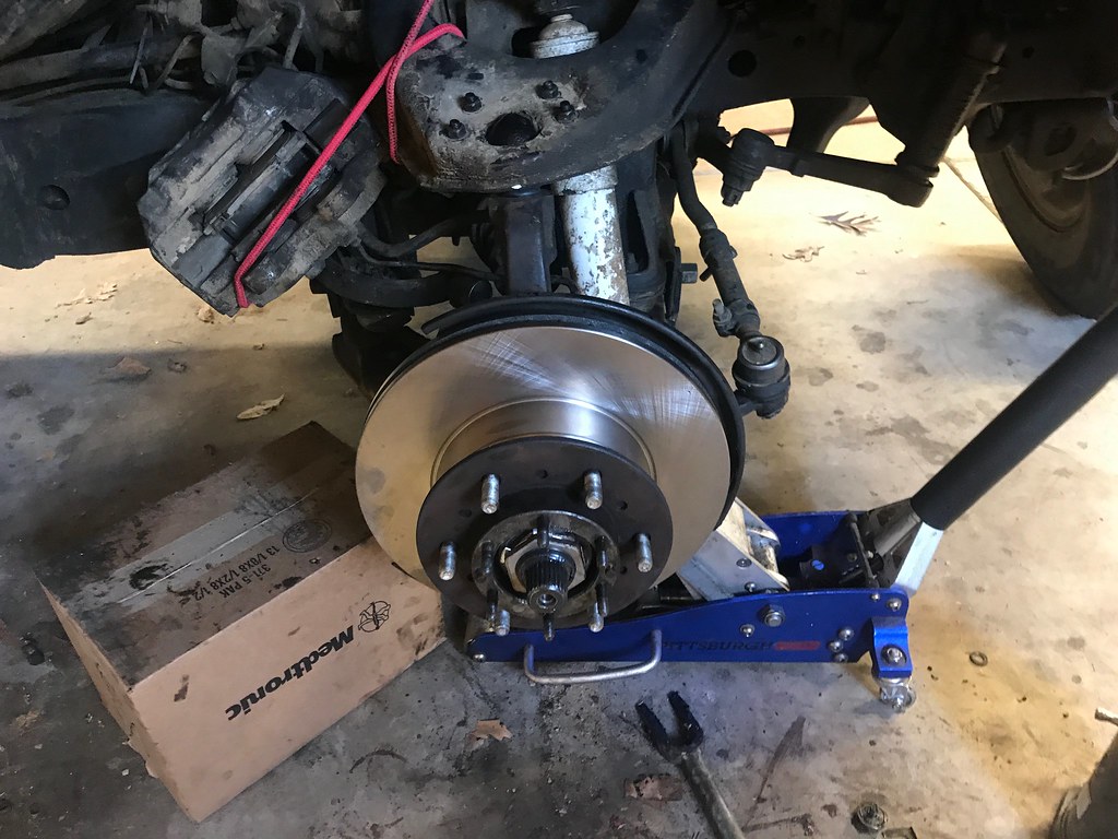

I replaced my rotors late last year (2016), now they are warped again. This weekend they are coming off to be turned, but it shook before that. Just about everything under the front end, aside from swaybar bushings/end-links, is new or replaced within the past two years. In addition, I do not feel the shaking strong in the steering either. You feel it in your butt :)

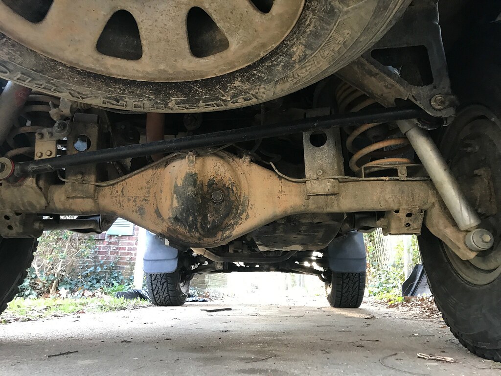

Really? Mine is stock and my bar is NOT horizontally aligned perfectly with the rear axle. Axle side is 15.5" off the ground and the frame side is 19.3" off the ground.
IMG_2347 by keaton.burleson, on Flickr
Photo makes it look a bit more extreme since the angle is a bit below the bar.

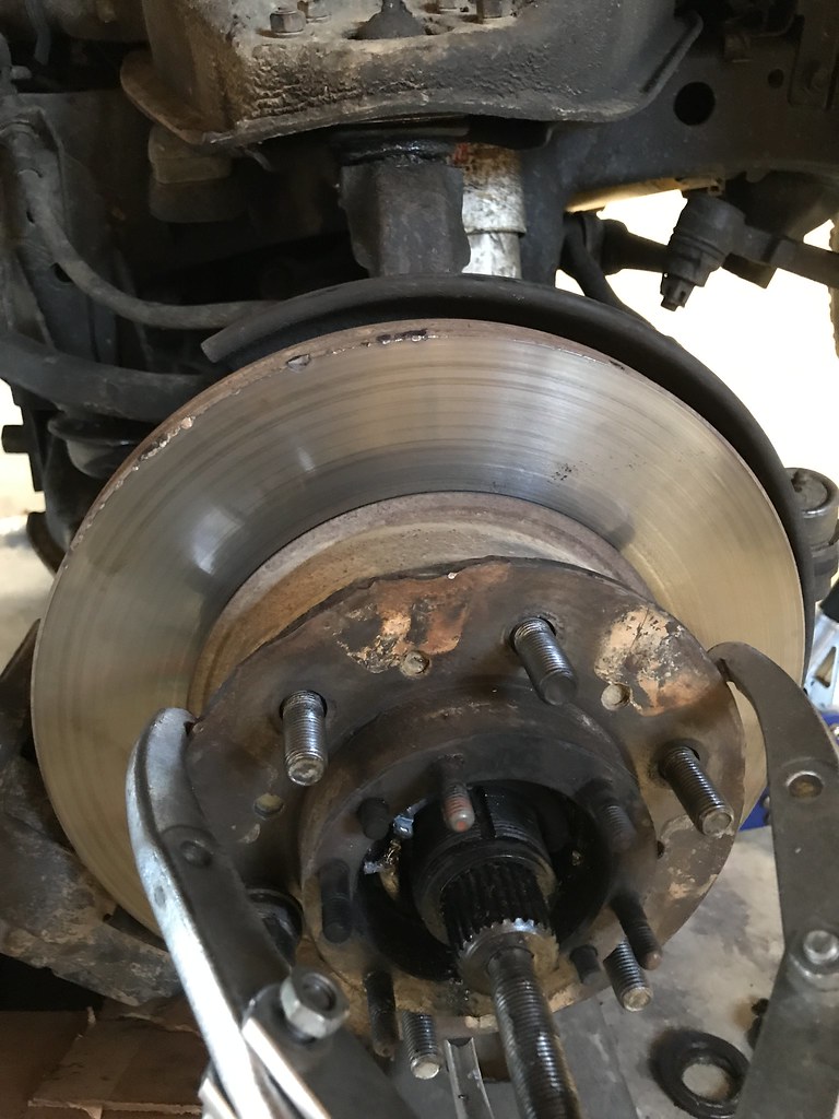

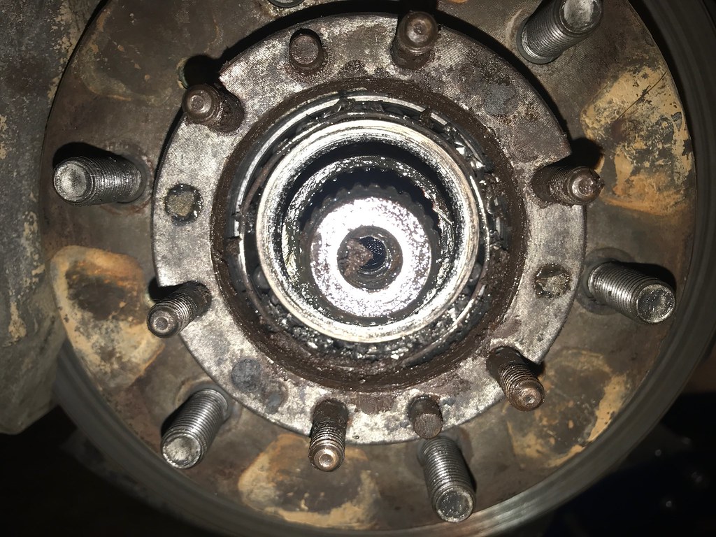

Uggggh. I was driving and I heard a loud growl and pulled to the right. Then it stopped and felt normal. Turns out my nice KOYO bearing exploded. :dammit:
I will have ~4 brands of wheel bearings on my truck now. KOYO, National, and (sigh) Duracrap. When I get my rotors turned I'll replace with KOYO again.
FML!!
Gotta love how friction works. Basically, my bearing welded itself to the spindle.
IMG_2384 by keaton.burleson, on Flickr

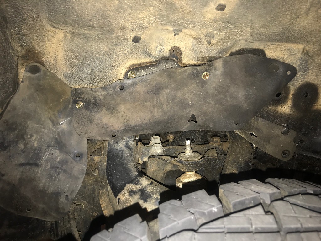

I found myself removing the lower control arms today.
On my 4runner (1993), I had to first unbolt the sway bar endlinks from the control arm. Same with the shock. Just unbolt it. Then I removed the four bolts holding the ball joint in. The arm just about swung down. Then, I took a picture of my alignment so I could get it roughly aligned when putting it back together. Now, the next part: pressing them out.
:censored: :censored: :censored:
You really need a proper press to do this, but its still pretty challenging even with the right tools. We ended up using a piece of pipe with a nut/bolt welded on the end and pressed through the bushings. Putting the new ones in should be easy, just use a mallet :). Install in reverse.
Waiting on RockAuto.com to send me my new ones

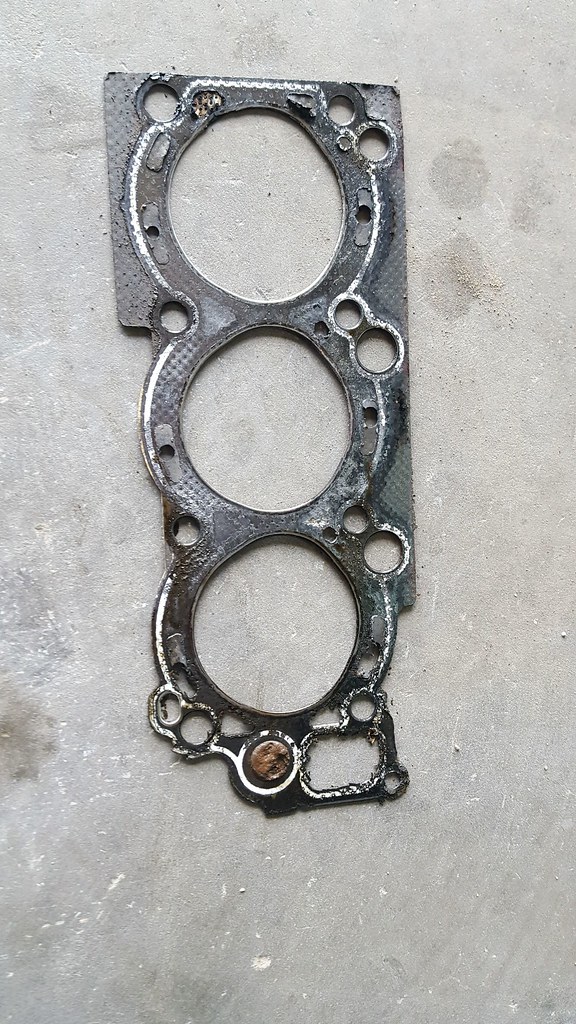

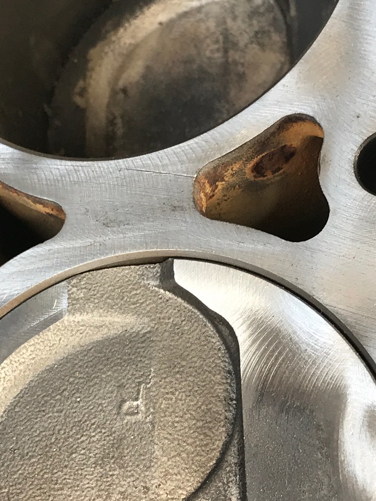

I pulled over to adjust timing and noticed it was blowing white smoke. Then it wouldn't turn over without pulling the plug. Radiator was dry. Did not overheat, but figured headgasket on driver's side was blown. Took it to a shop to have it done, and flew into Phoenix.
The next week, they checked both headgaskets. Turned out to not be a headgasket.
IMG_3017 by keaton.burleson, on Flickr
IMG_3078 by keaton.burleson, on Flickr
Block was cracked.
