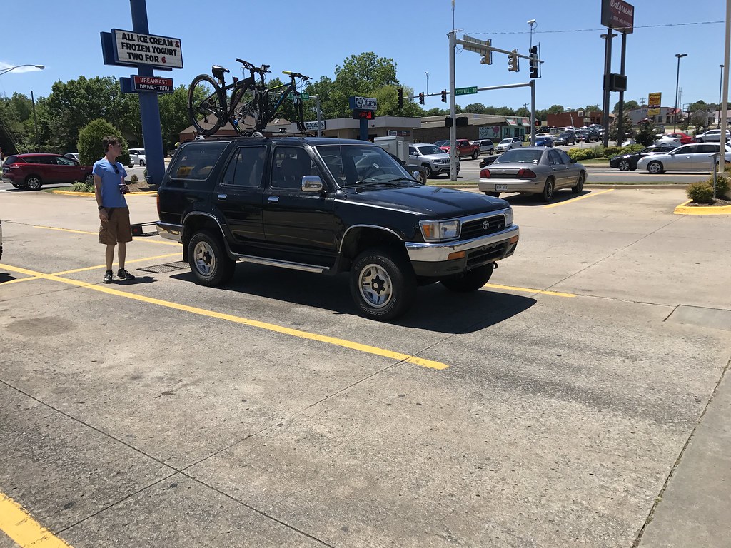

Van Buren, enjoying some Braums:
Photo May 25, 1 10 40 PM by keaton.burleson, on Flickr

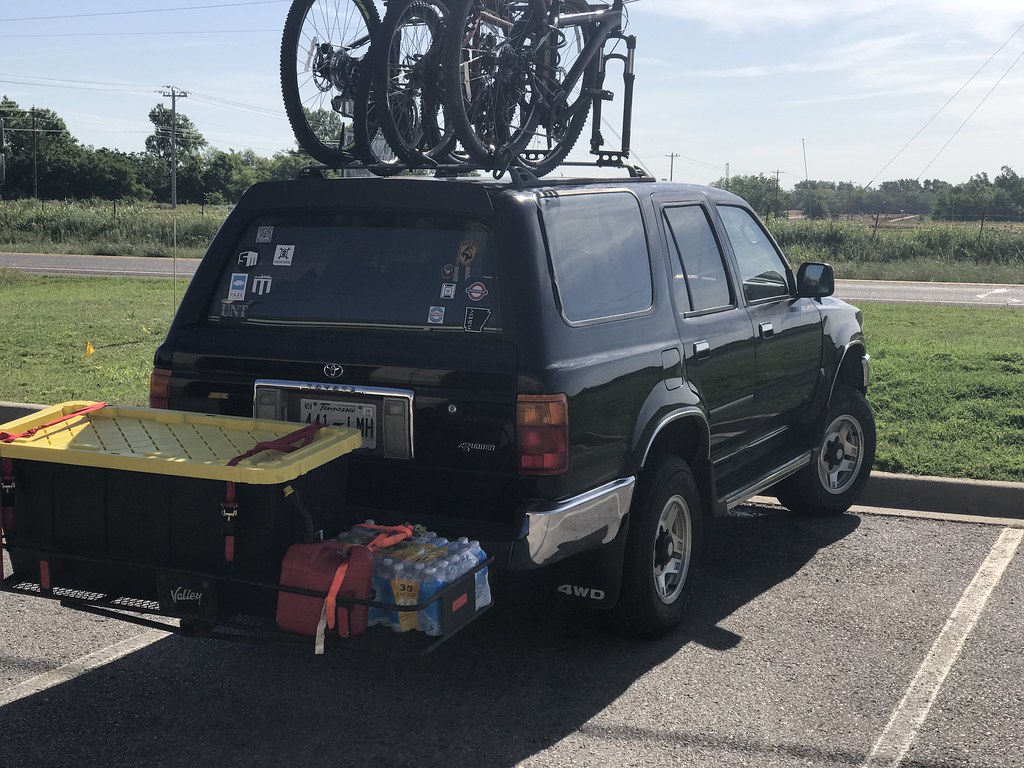

Checking some clearance at a bank ATM:
Photo May 25, 9 25 56 AM by keaton.burleson, on Flickr

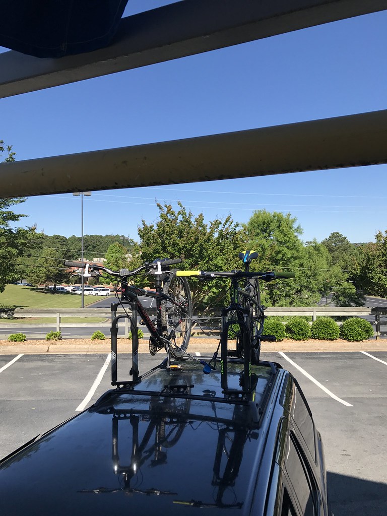

We did manage to lose two of the bolts that hold the front tire to the bike which blows, but in Amarillo we're stopping and finding a bike shop.
Onward! Shaking and all.

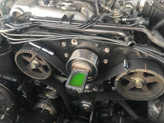

Oh jeez I kinda forgot this thread. :behindsofa: My bad. So I made it safe back from my trip. I had to get towed once because the fan bearing seized on top of the Grand Canyon.

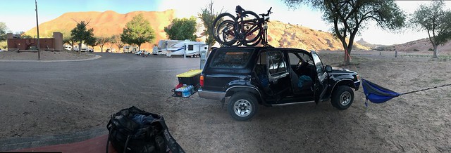

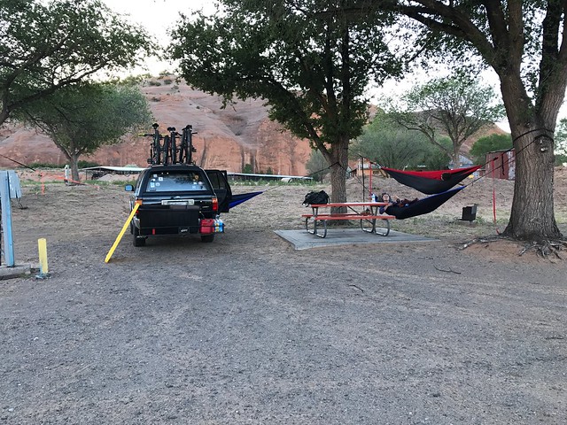

Camped in Red Rock, NM:
IMG_0094 by keaton.burleson, on Flickr
IMG_0095 by keaton.burleson, on Flickr

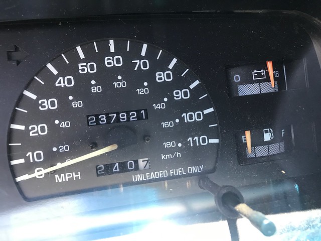

As we climbed our MPG dropped and so did our power. We had a lot of gear but it was frustrating having to stop and advance timing to get more power. Ugh it was slow. Is the Supra intake worth it?
This was our best MPG after we leveled out:
IMG_0237 by keaton.burleson, on Flickr

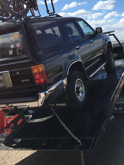

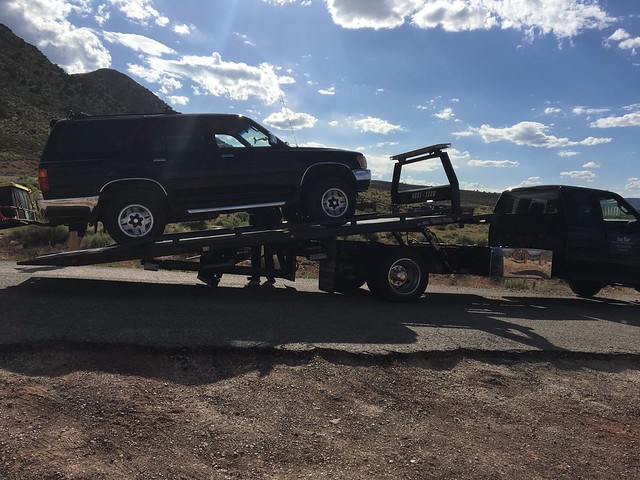

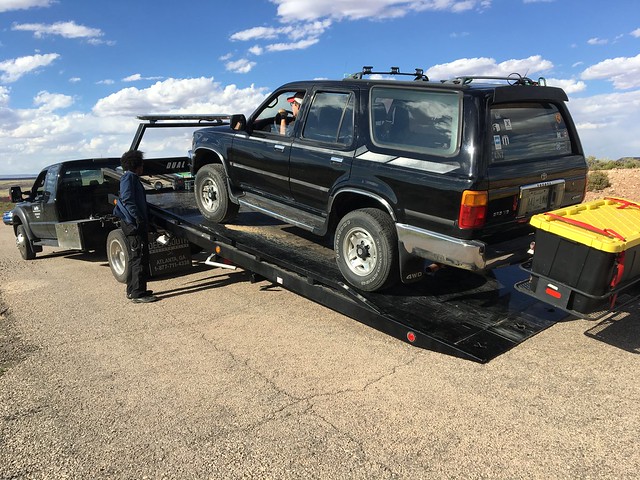

Unfortunately on the Grand Canyon we had to get towed:
IMG_1653 by keaton.burleson, on Flickr
IMG_1652 by keaton.burleson, on Flickr
IMG_1651 by keaton.burleson, on Flickr
About to put the tensioner + fan bearing bracket back on:
IMG_0175 by keaton.burleson, on Flickr

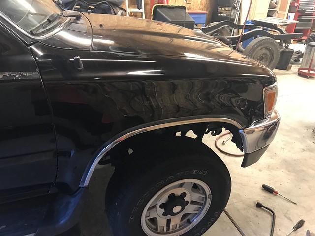

I did finally get my fender painted and replaced:
IMG_0787 by keaton.burleson, on Flickr

That was honestly the best milage I've seen out of this truck but it was slooow. What size tires are you running? Mine are so small my speedo is off and with my engine at 3.6k RPMs at 75MPH. :rant:
Yep, our trip wasn't nearly so cost effective, but we got to see a lot in 10 days. I'm running 31x10.5R15 tires currently. They are a fairly knobby off-brand tire. The previous owner told me he changed the diffs to 4.56 from 4.88. The door jamb indicates G144, which would be 4.88. My speedo is off about 5 MPH at highway speeds. When the GPS says it's doing 70 mph it's at about 2800 RPM and reading 65 mph on the speedometer. The diffs are also sporting fresh glossy black paint, so it all seems to correlate with what I was told. I'm calculating 14 mpg avg, but that's based on the mileage the odometer gives which should be low given the speedometer reading slower than actual.
You can replace the speedo gear and get the speedometer accurate.
I'm not sure I have one. My truck has a VSS at the output shaft of the transfer case and only electronic connections at the speedometer. I haven't done much digging on adjusting yet though.

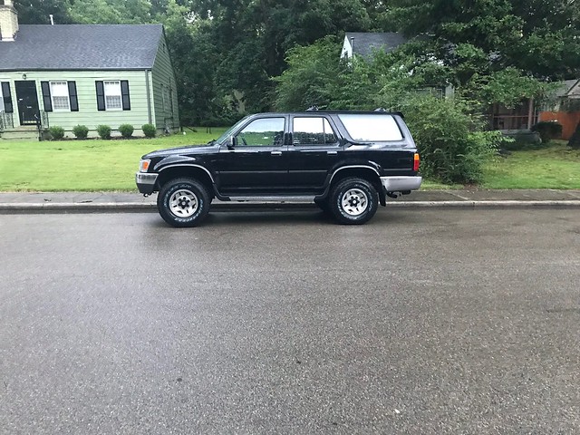

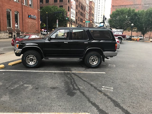

I will say, I really like the 31s:
IMG_0804 by keaton.burleson, on Flickr
After I finish chasing issues, I think I'll get a roof basket.

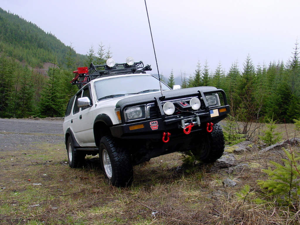

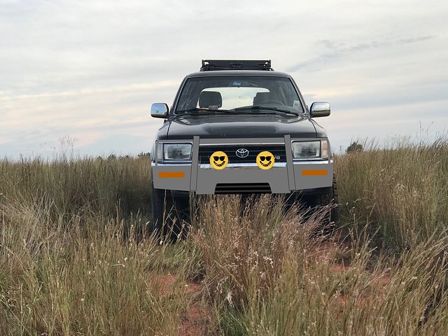

I'm kinda set on a new bumper, like the ARB:
but thats crazy $$$!! I might see if I could weld my own, something like this:
kinda like this? by keaton.burleson, on Flickr

I like the clean look of the ARB, the low-profile of the main bumper, and the extra protection from the bull-bar all the way to the corner.
Watching out for used ones on CL for my first-gen.
Yes. It also matches the style of our vehicles. Not a fan of most other ones, especially tube bumpers. The body lines work really well with it, and I believe that the 1st and 2nd gens have the _best_ body lines of any 4R. The 2nd gen looks like a spaceship imho.

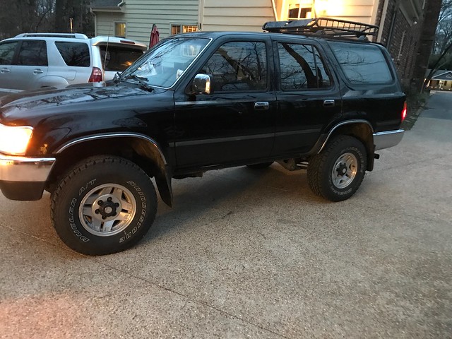

The mudflaps look great, through they don't fit "100%" well unfortunately.
IMG_2070 by keaton.burleson, on Flickr
Still looks awesome.

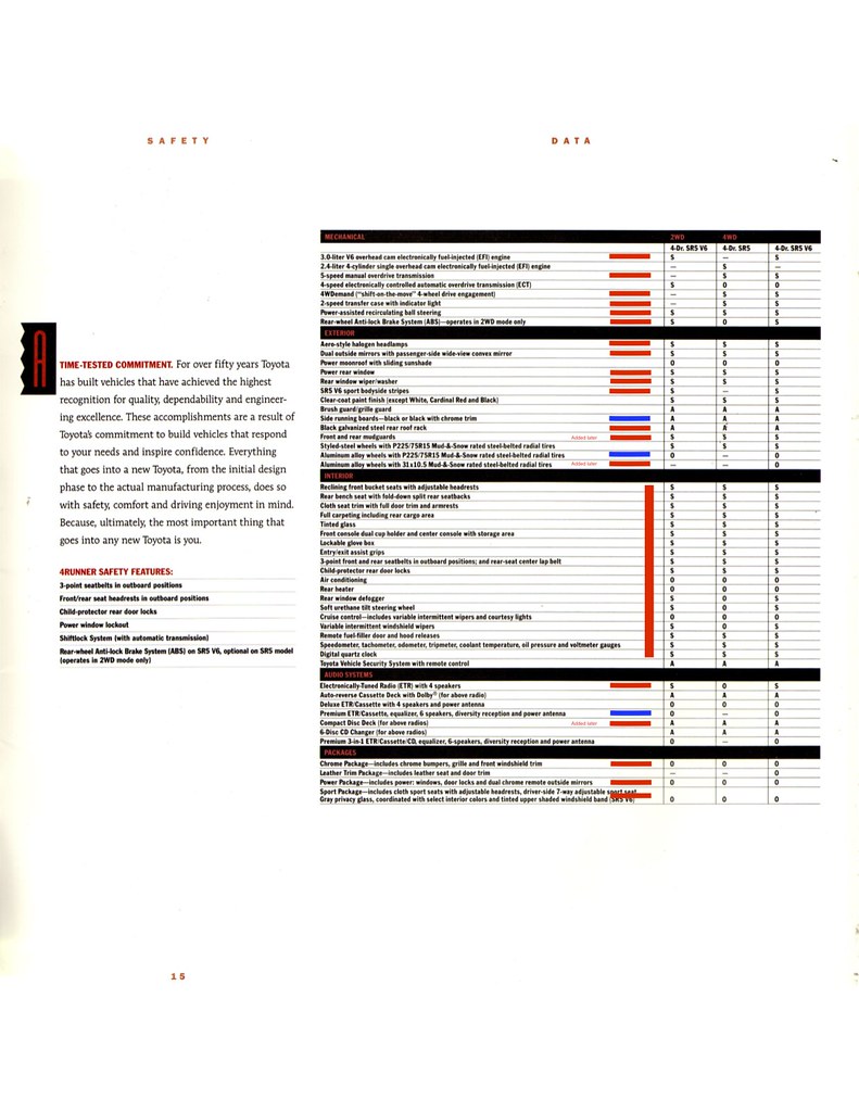

Below is the original sheet from the catalog:
features by
keaton.burleson
, on Flickr
Its kinda wacky but almost top trim at this point.
