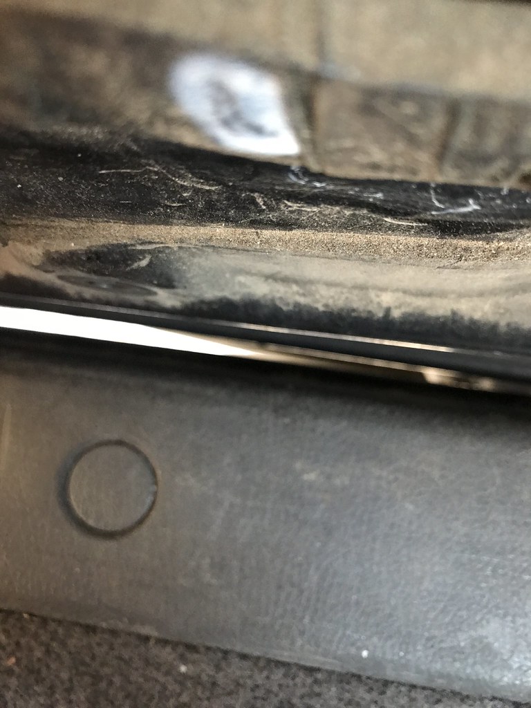

My tailgate frame has been bent from years of hauling things just a bit too long for the truck. Not to mention jumping, standing, etc on the tailgate has caused a gap between the trim and the tailgate making a ton of noise on the road. Basically a WOOOOSH plus the muffler. Terrible.
IMG_2072 by keaton.burleson, on Flickr
I got some automotive weather stripping from Home Depot and fixed it. Elegant? Not really. Fixed? Yes.

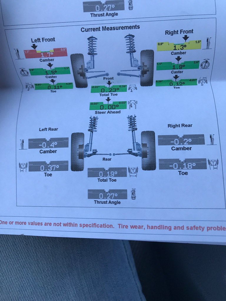

I've been pouring over everything that could be causing shaking and it feels like the rear is the cause for sure.
54283310829__CDFF4867-430D-4DB1-9842-13E9F6842C0F by keaton.burleson, on Flickr
Look at the rear alignment. Something has gotta be wrong based off the toe in/out on either side.
Can anyone else upload their alignment sheets? I'd love to compare!
