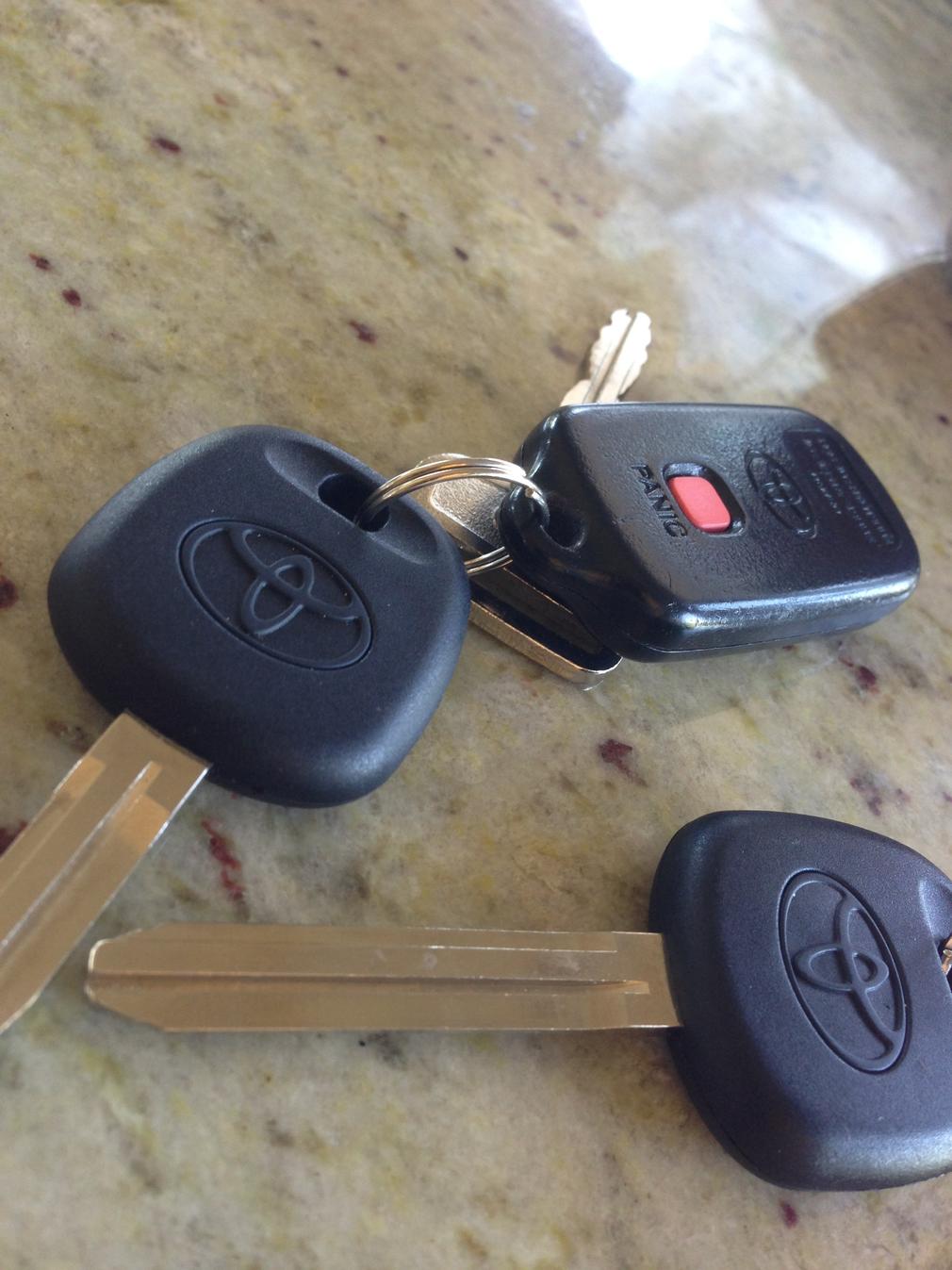

3rd gen chip key
none of the 3rd gens have chipped keys last i checked. the replacement should only be about $12 including cutting from the dealer. i believe chipped keys were introduced in the 4th gens.

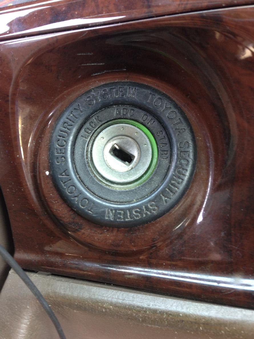

i have a 2002 and it has a chip key...
cutting it is easy.. getting it programmed is another story...
it will unlock car, fit in ignition, and turn, but the car won't start..
it just keeps trying to turn but never does...
anyone know the best way to DIY program or any success with anyone besides the stealership???

Sadly their is no way to DIY program a key, you need to have a computer that plugs into the OBDII plug that will reprogram the computer and those are a couple thousand bucks. It's not like programming the factory FOB where you unluck/lock open the door etc... Like mentioned earlier any locksmith can do this and usually charge less then the dealer end result are the same. And my personal opinion even though we drive toyotas everyone should have AAA, they will cover a percentage and sometimes all of a key make for you if you go through one of their certified mechanics. AAA is cheap and it works! Once a year I lose my keys on purpose because I never use my AAA for anything else so at least it pays for its self on key makes.
One other thing, buy the fobs used, I found mine on CL for $30 and DIY programmed it myself. That was 2 years ago and besides batteries it's still works no problem. If you buy new you are at least paying 100 at a locksmith and more at a dealer EBay is another option I don't know those prices.
