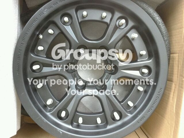

Well, I just spent A METRIC ASS TON OF MONEY. I just order a set of Hutchinson Rock Monster Double Beadlock Wheels in black. I feel guilt, guilt in the pit of my stomach for spending that much. I stared at the submit button for at least 10 minutes... But in the end, I clicked.
Not trying to name drop here but I ordered from Trail Worthy Fab because they were the only folks that didn't have a 3-6 month waiting list, the prices are better than most and they deal with Hutchinson all the time.
In Black-
In Silver-
I was going to go with Trail Ready Beadlock Wheels but I really wanted something I would never have to worry about again. So I went with the Double Beadlock. I will never have to worry about blowing a bead again. Another thing that sold me on these is they are DOT compliant. I don't expect to get hassled by law enforcement but now I will be 100% legit.

BTW I've been wanting hutchinson wheels for years now. They are definitely bad ass and they'll look awesome with those pitbulls.
Hopefully you saw this before you clicked submit...
KMC Enduro Beadlocks on CL
The ones you chose are better looking for sure but if you aren't picky about that then it could have been a deal.
I'm excited to see how you make those fit!
I'm pretty sure I've seen those on NW-Wheelers for sale. I wasn't really going for the looks. The reason I wanted Rock Monster Beadlocks was because it was a double beadlock versus a single. I figured that I only wanted to spend that much money on wheels once. So I figured I'd do it right the first time. Trail Ready, KMC, Walker Evans, Allied, and such are all great wheels. I just wanted the piece of mind knowing that no matter what, I would not loose a bead. And I also don't plan on running a spare.

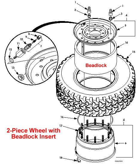

Here is how a single beadlock works.
Here is a diagram of a double beadlock wheel.
There are different kinds of beadlocks out there. From what I've seen I think the double beadlocks work the best.
Thanks for the info. I had just assumed that all beadlocks were double because why would you only want to lock the outer bead?
I learned something today :thumb3:

UPDATE! Beadlocks come in? You order the rockers yet?

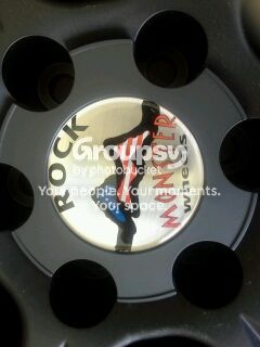

Yup, beadlocks are in. They are sitting in the shop waiting for me to get home so I can pet them and hold them and hug them and love them. My wife was kind enough to send me a picture.
Rockers are on order and they shipped 2 days ago. Hope to get them next week. I will be ordering 5.29s and an ARB Air Locker in the front in a couple weeks.

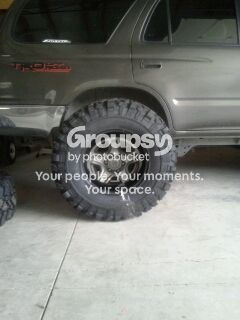

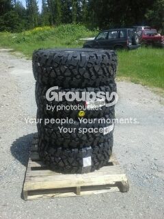

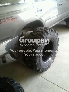

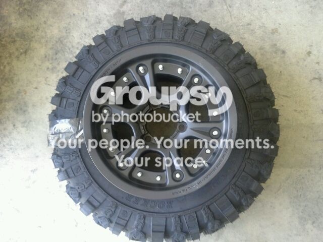

Tires were delivered today. The wife sent some courtesy pictures. Maybe, to be nice, maybe, just to taunt me. Probably taunt.
I can't wait to go wheelin'.
Those are going to be awesome on the trail, your wife seems pretty cool to always send you updates on your purchases!
