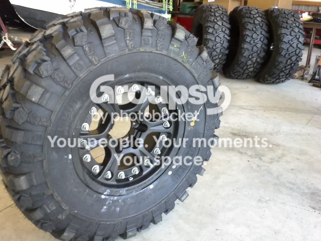

I wanted to share a little about why I picked the wheels/tires/gears that I did.
35" Pitbull Rocker:
It took me about a year to decide what tires I wanted in 35s. I originally started with KM2s, Good Year MTRS and maybe Pitbulls as a possibility. Here's the list of must haves:
At least a true 35" tire.
Good in deep snow.
Decent road manners
I heard KM2s don't do as well in the snow as some other tires. This for me is a deal breaker because I LOVE to snow wheel. It is my favorite. MTRs are not known for their road manners in the 35" size. I don't daily drive my '97 4Runner but I do drive it to the trail and around in the mountains. I needed the tire to be stable. I had 38" Super Swampers TSLs on my '94 Toyota Pickup, they were Bias Ply, they were awful on the road. I've seen Pitbulls in action in 6 feet of snow or so and they were awesome. I've heard great things about the Rockers so I decided to give them a try.
17" Rock Monster Double Beadlock Wheels:
I wanted a double beadlock because, again, I LOVE to snow wheel. These are also DOT compliant wheels and by Washington State standards, are legal. The company that makes them is the same company that makes the Military HMMWV beadlock wheels, Hutchinsons. They are very well known for their quality.

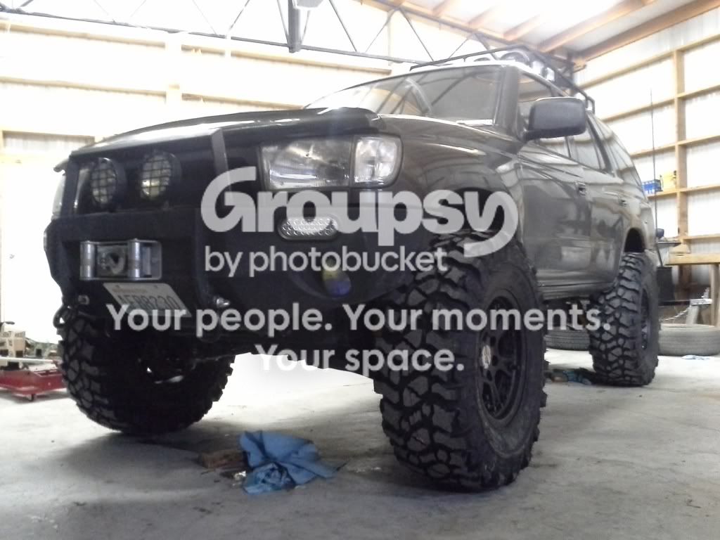

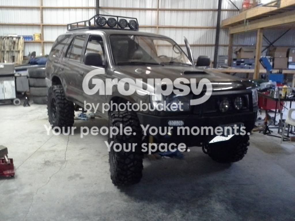

Well, I've been busy in the shop. Wheels and tires are put together, but still need to be balanced. 35s are on. New diffs are installed. 5.29, E-locker rear, and ARB up front. I tested everything last night and it seems to work great. I still have to start the break in procedure for the gears but I can't do that until I can actually turn the wheels.

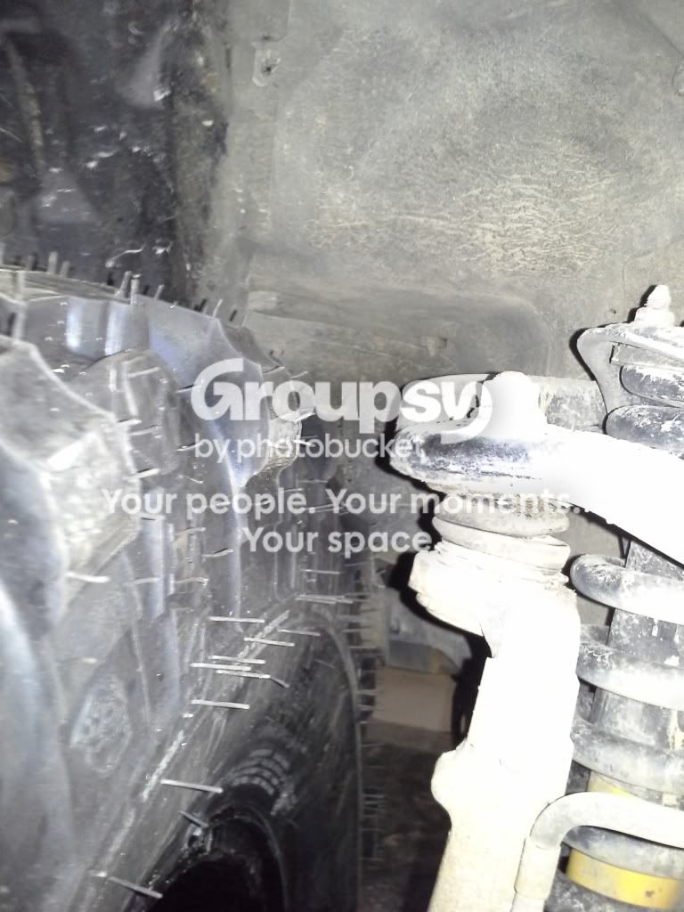

There is tons of rubbing. I'm going to start cutting today but it is going to take me a few days to do this right.

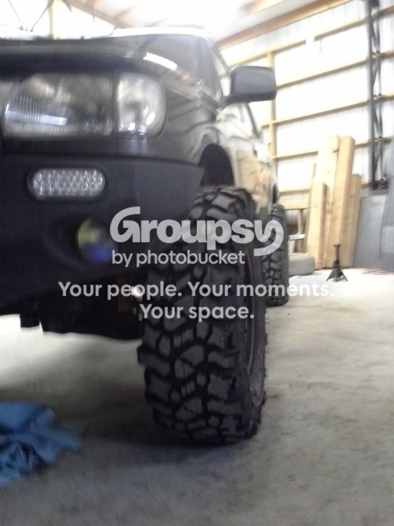

Good UCA clearance with 1.25" Spidertrax Spacers. Wheels are 4.5" backspacing.
The tires stick out a few inches. I don't want to be hassled by law enforcement. I bought a set of Limited flares with the door cladding a few months ago in preparation for this. I plan on painted them with bed liner.

Looks good man, what made you paint all the nuts and bolts black? I thought the silver shine of them gave some bad ass contrast to the flat black.
They are actually caps that came with the wheels. I didn't want to leave them off and open to the elements. I am hoping it will protect them a little. They they take a couple good whacks with a rubber mallet to get them seated. I am not looking forward to the day I have to pull these wheels apart.
I cut the bumper for clearance. And started on the fenders. But for now I'm off to enjoy some 4th of July festivities. I'll start up again tomorrow. I have lots of time off right now so it all shop time!
