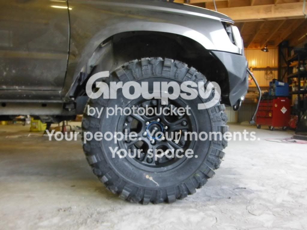

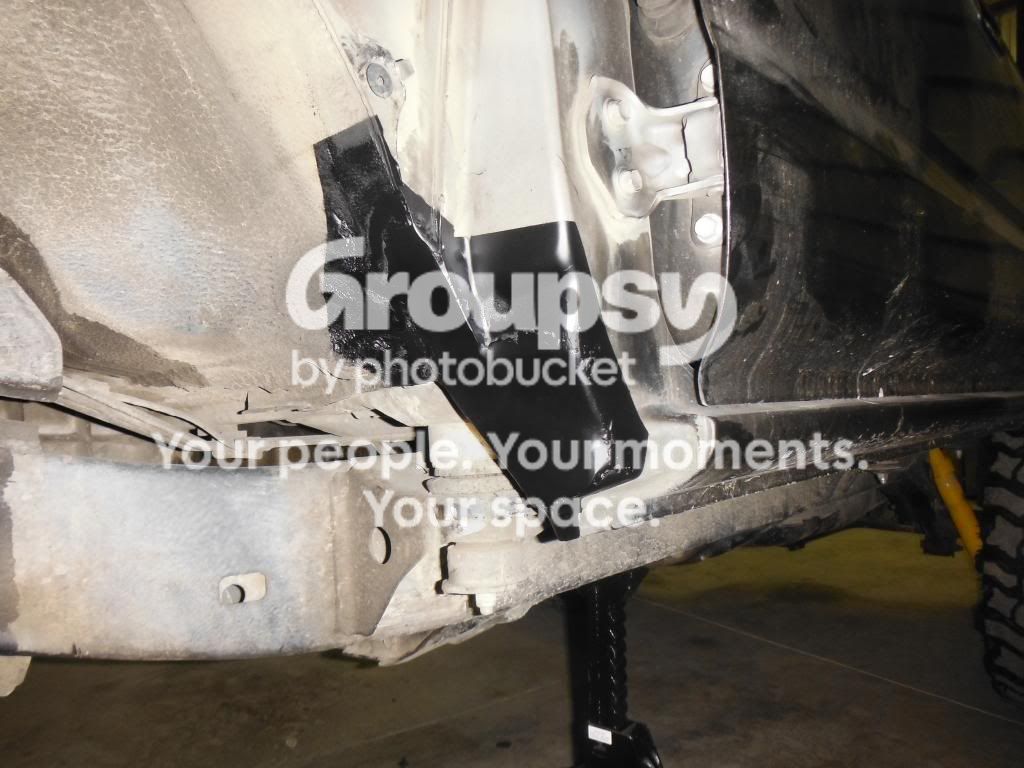

I've been working on my clearance issues. I got the front done. Starting the rear this morning.

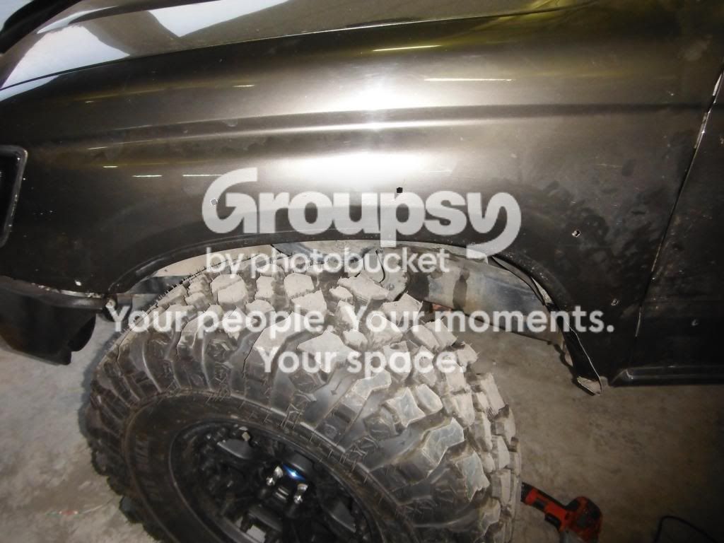

Before:
After:

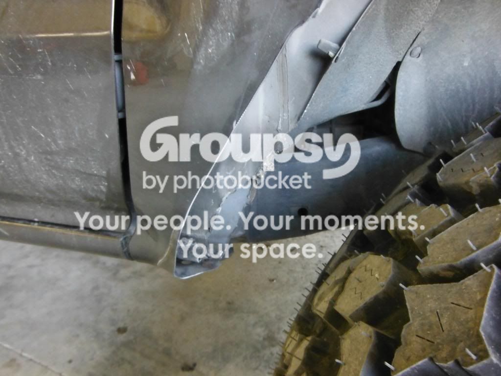

I had to tub into the floorboard of the truck. Shouldn't have any clearance issues after this.
Welds looks like ass because my welder has a minimum and maximum setting and the minimum is still too much. It's a cheapo but I will be getting a new one as some point in the future.

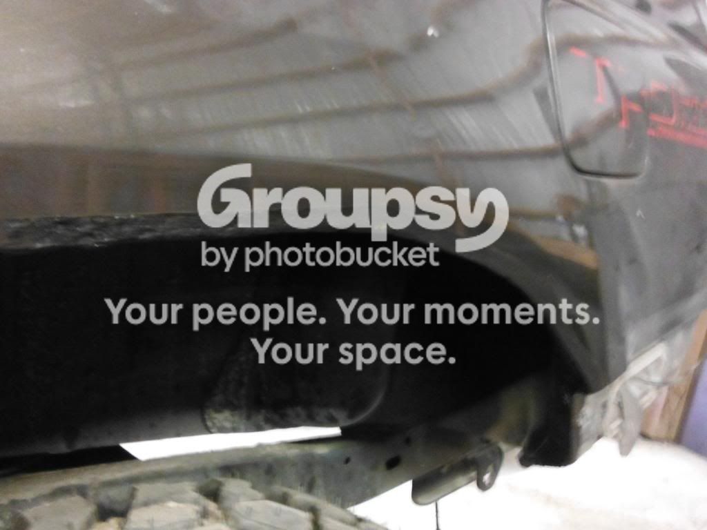

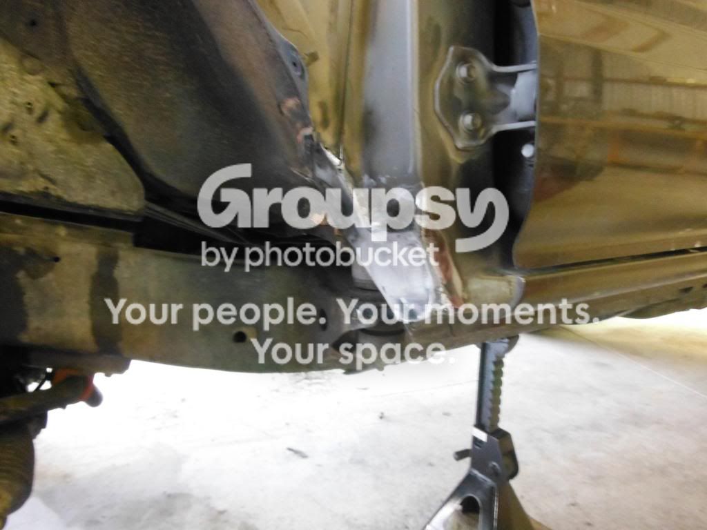

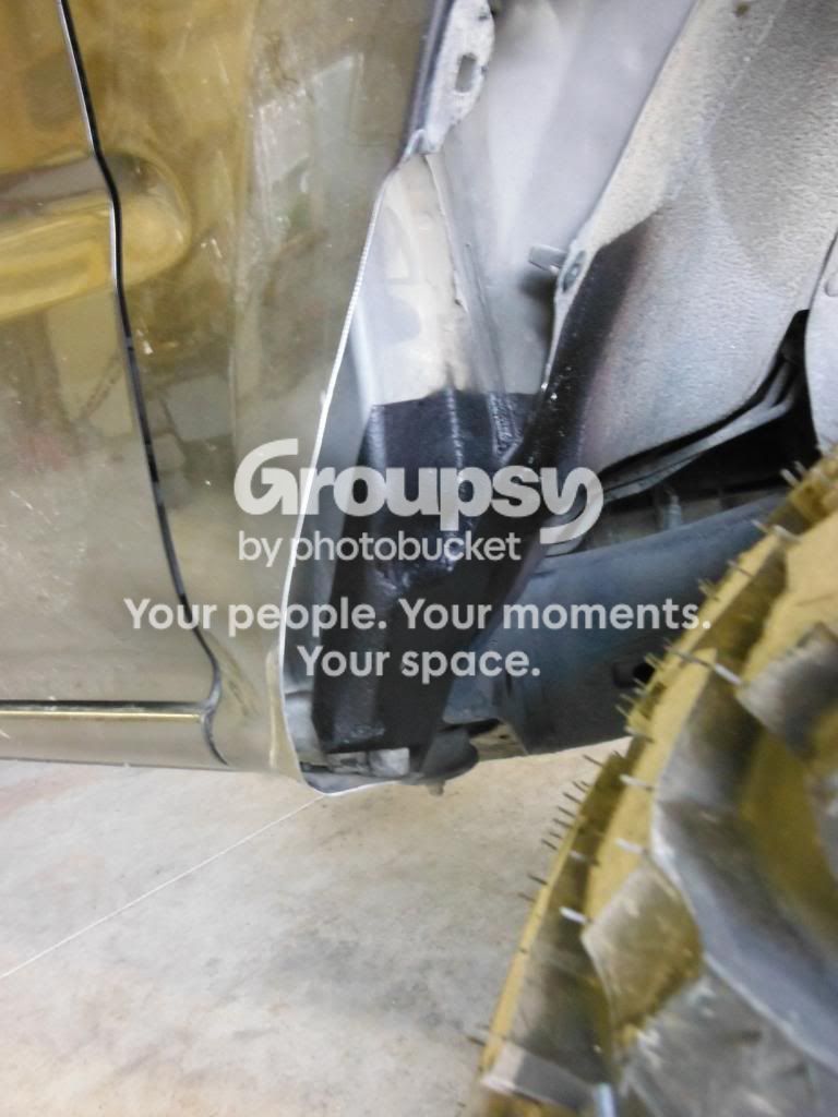

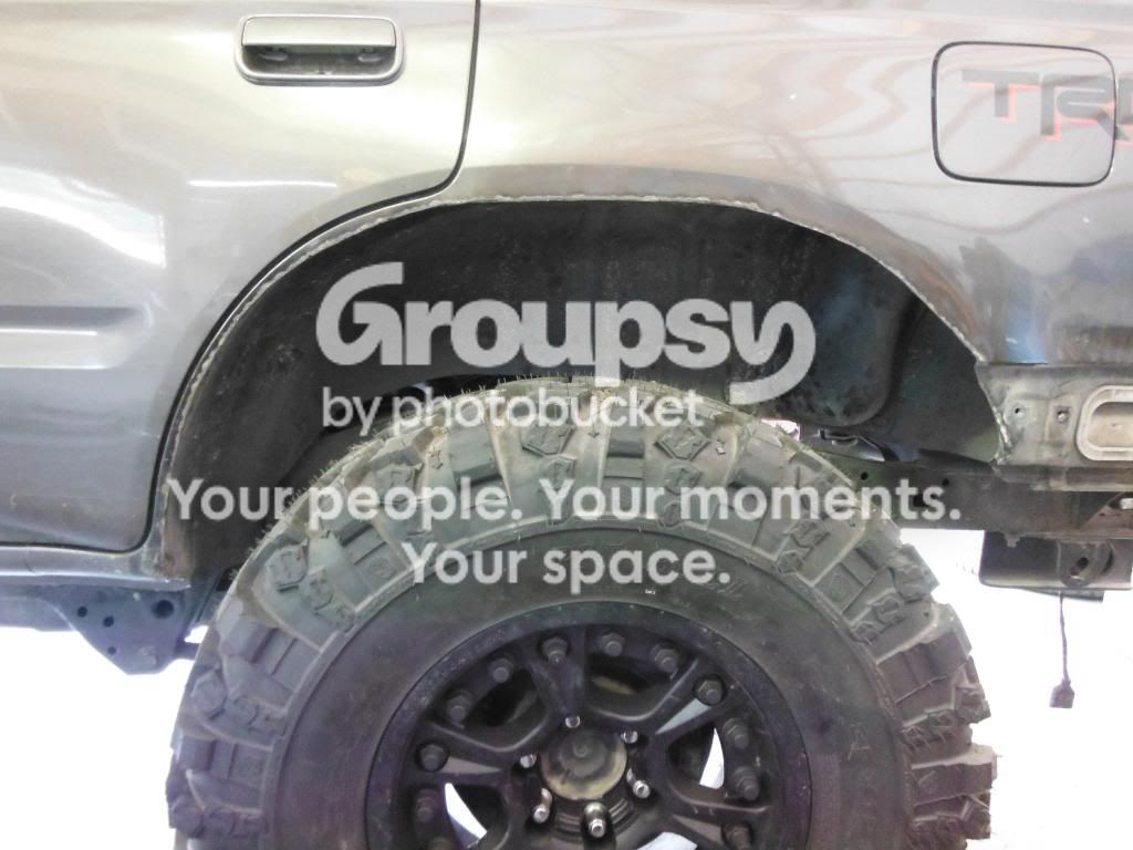

More today. Got the rear clearance issues fixed. It took forever. Trimmed the rear and welded the 2 panels together so debris and snow doesn't get stuffed in there.

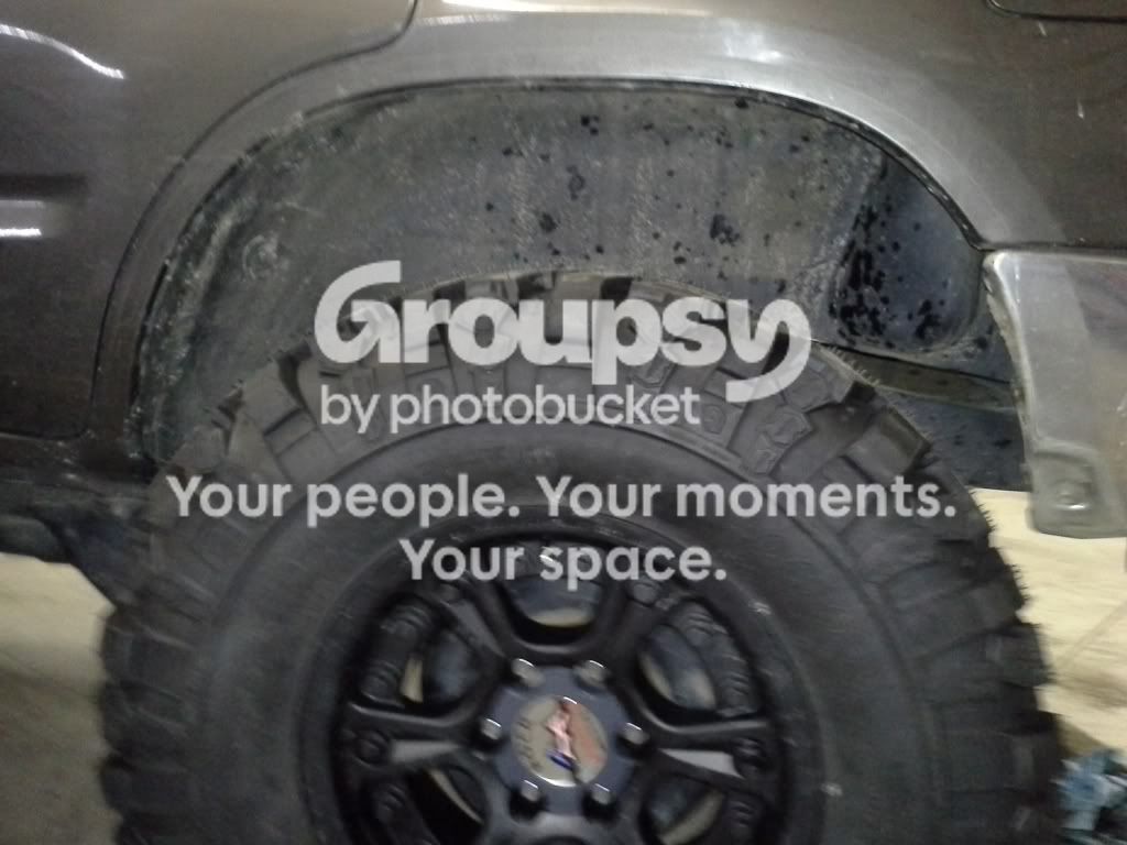

Before:

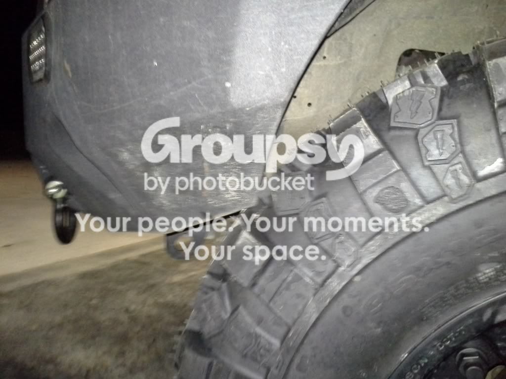

After:
To keep corrosion at bay I used a Rubberized Coating Spray. Looks like un-wiped ass but the flares will cover it up anyway.

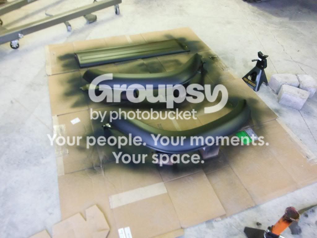

Limited flares:

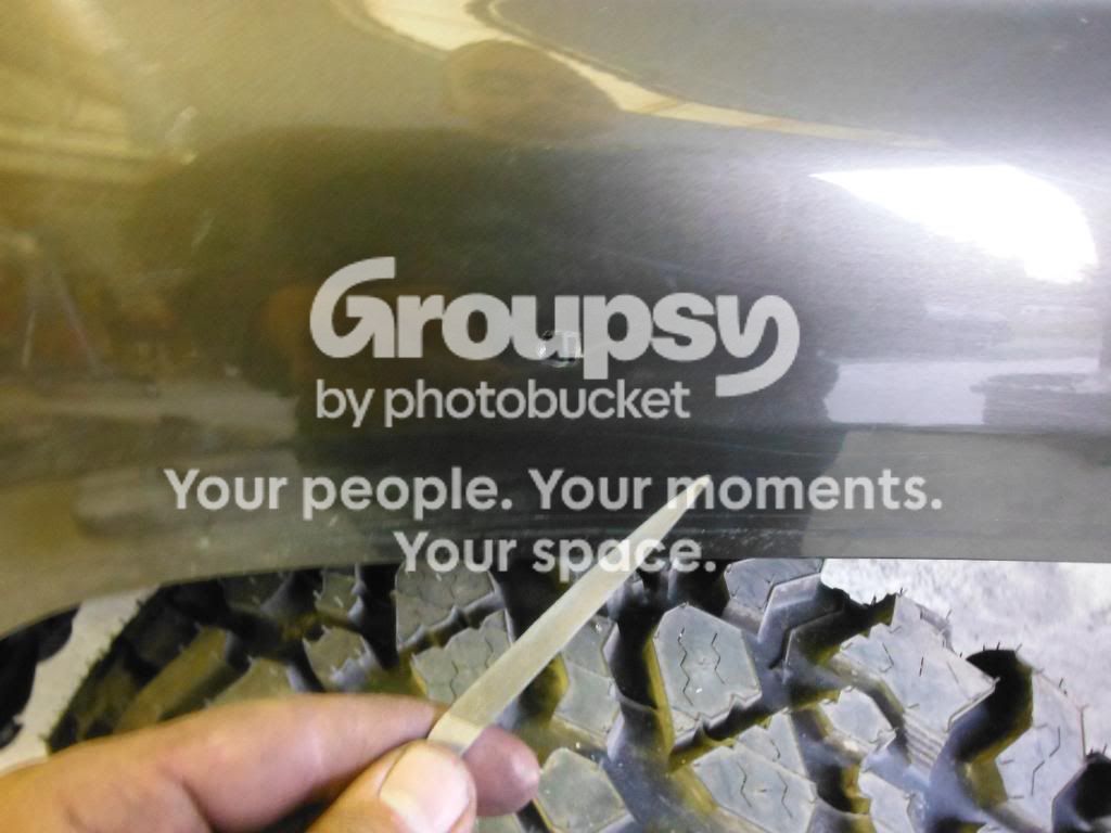

Well, I don't have a square drill bit so a drill and file will have to do. Lots of "TLAR" (That Looks About Right) method here.
Driver's door and both front fenders and prepped for install. I painted the flares with Duplicolor Bedliner. I'll be able to finish the flares early this week pending what ECGS says tomorrow.

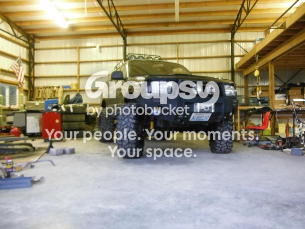

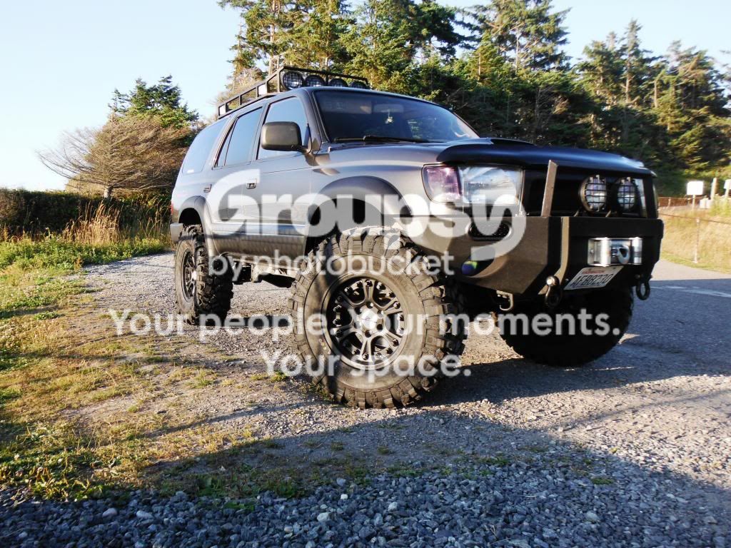

Here is how she sits.
Badass!!!
Will be watching and waiting for your review of wheel/tire combo :snacker:
Sorry if I missed it, but any idea what the weight of the wheel is?

I didn't weight the wheels but the specs online say 60lbs. The tire and the wheel is quite the heavy package. I'll be sure to keep everyone posted about the wheels and tires.

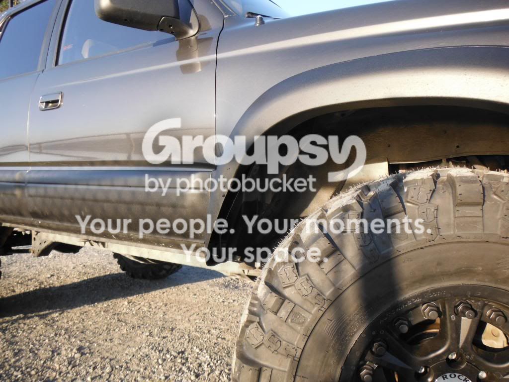

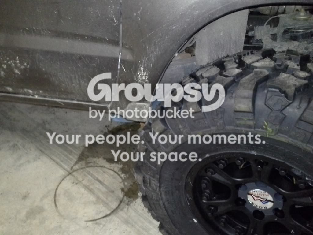

I got most of the truck buttoned up today. I got the wheels/tires balanced. The most took 10oz and the least took 4oz. For now I painted my rear bumper with bedliner until I can build a bumper. It would have been awful as the only chrome item on the truck. I was able to get the truck on the road today and start the break in procedure for the gears. I got a few pics for you guys.
I've heard that Rockers are a lot quieter than most people think but I was still shocked. Don't get me wrong, they are a mud terrain style tire so there is noise but certainly not what I thought they would be.
I did notice a wobble in the steering from 35-50MPH-ish. According to the shop the wheels/tires spin fine. It's not an insane bias ply death wobble but it is enough to annoy me. Realistically, I have no experience with double beadlocks or Rockers driven on the road so I am not sure what to expect. If this is just as good as it gets then I'll deal with it and drive accordingly.
