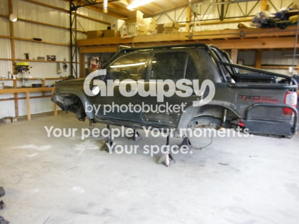

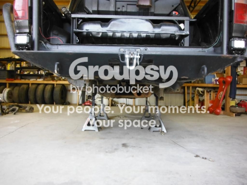

I order a 4 speed Atlas last weekend should be here in another 3 weeks. So I did this today:
So much more room of activities...
This round will consist of TWF Double Bead Lock H1 Wheels, 39.5 Bias PBRs, 14"/16" ORIs, D60/14B, ARBs FR/RR, 5.38s, 35 Spline Stubs/Drive Slugs, Artec arms, and a 4 Speed Atlas. (Insert mad scientist laugh here.)

oh my sweet baby jesus... This is going to become a monster truck. First the cage now the bottom half. Cant wait to see it all done!
When I am done the scary part will be finding out what goes boom when I stomp on it. But it should be a monster and pretty bullet proof.
Don't hold out, I want to see regular updates on this!
I'll do my best. It will be a slow build. I haven't even ordered tires/wheels or ORIs. So it will be shop art for a while. I am hoping to have back on the trail by mid summer. Making the Atlas case and sticks fit like I want it to is going to be challenging.

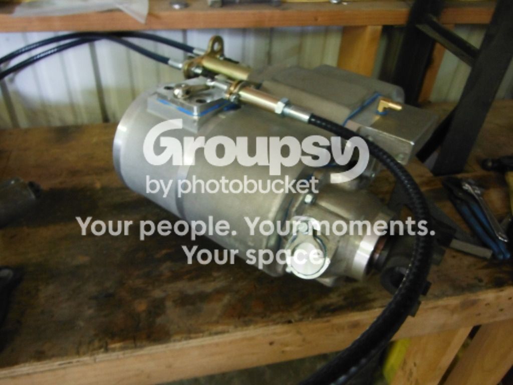

Cutting things off and ordering parts. ORIs should be on order next week. I received the Atlas and wheels and tires should be here in a couple weeks. Had to bump down to a 37" tire because I still wanted to run PBR but the only 39.5/40ish tire they run is a 16.5" wide which is insane.

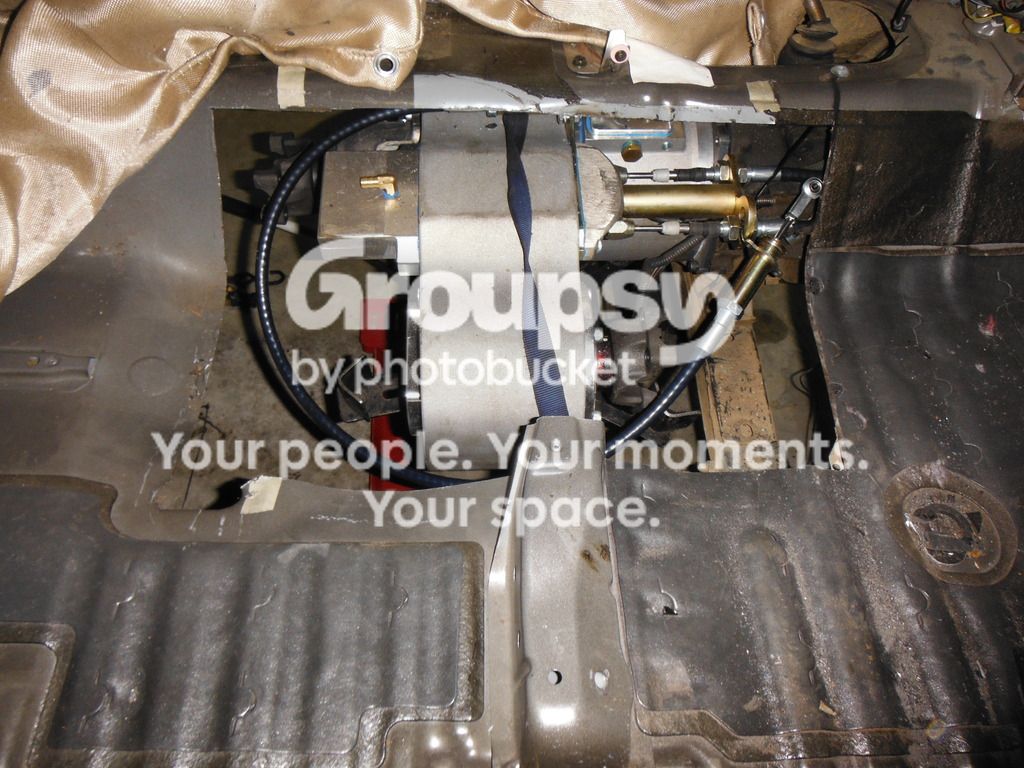

T-case is a 4 speed Atlas with the 11.7:1 ratio. Again, it's slow going but it will be on the trail again eventually.

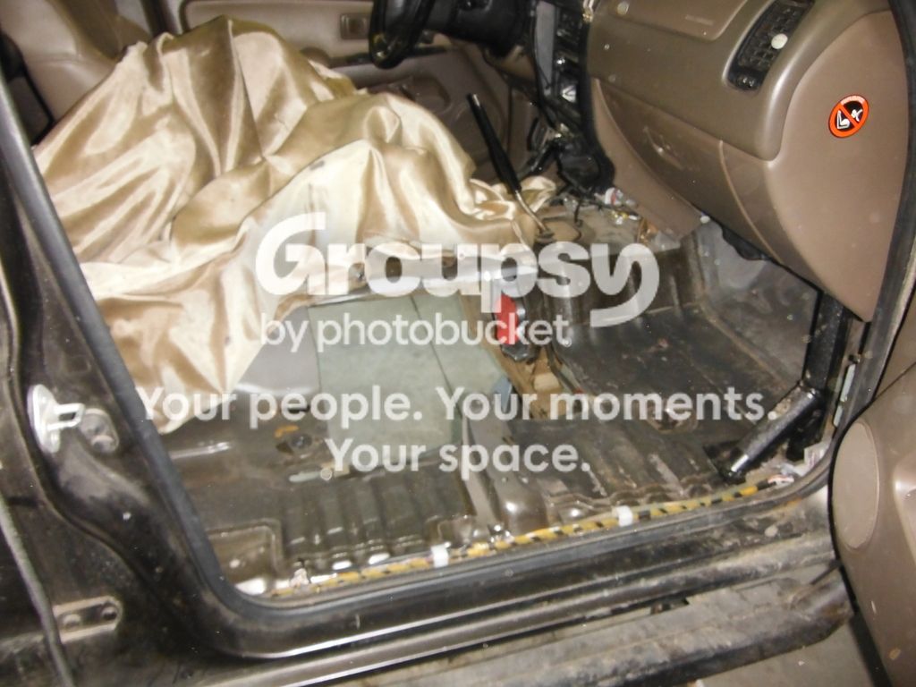

This can't stay.

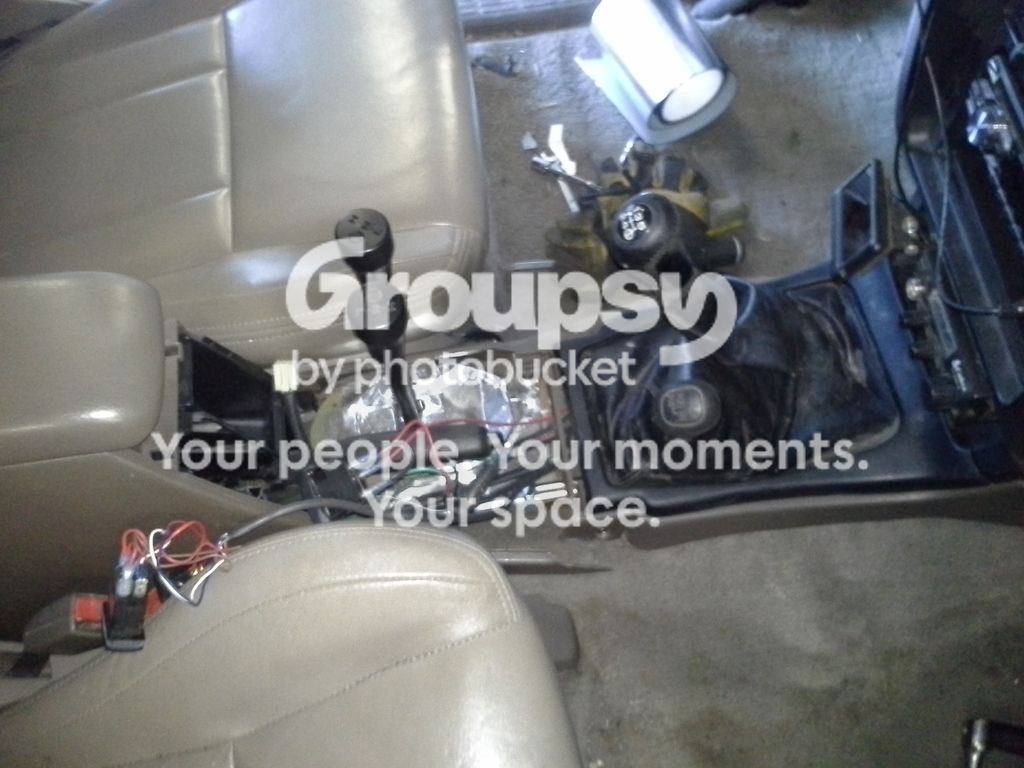

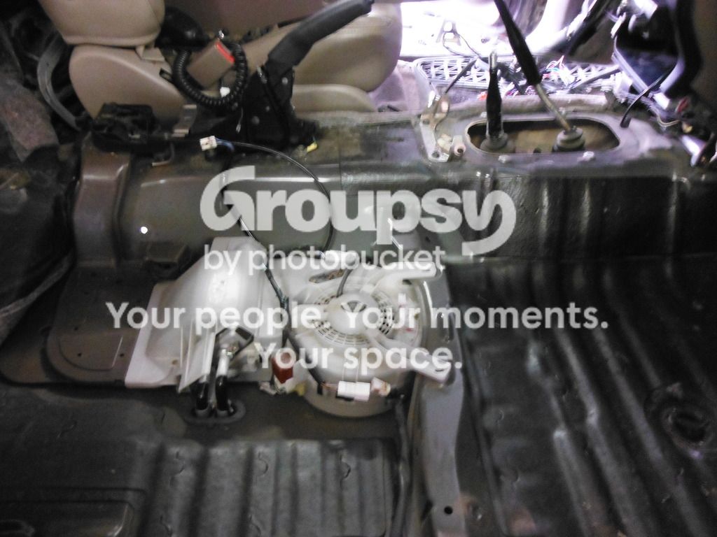

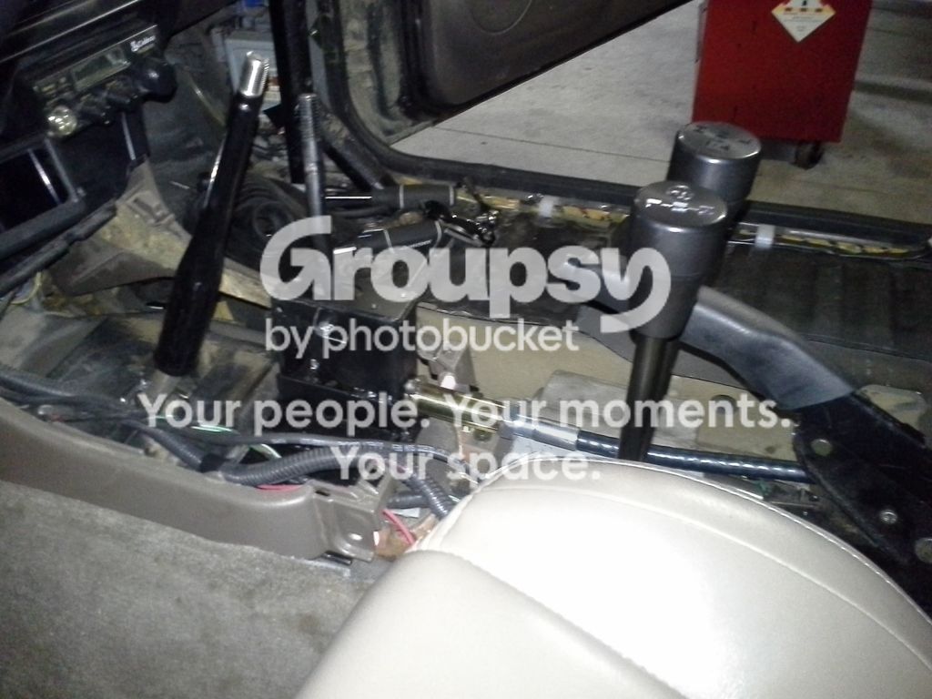

Had to do cable shifters since the hard mounted shifters would of came through the floorboard too far forward.
Going to have to build new mounts for the passenger seat.

The t-case is in for good now. The floor it patched up. I just used some random steel I had laying around the shop and then covered it in Home Depot's roofing repair to keep is water and rust proof. It won't do much for noise at this point.
I also go the shifters mounted and most of the center console back together. It was a pain in the ass to make everything fit. I wanted the center console to go back together a much as possible so I ended up playing with it a bucnh of different ways. I switched over to a 99+ center console to help make room as I want to keep my E-brake. I put the crawl box lever where the stock 4WD stick was and even swapped over the shift knob because, well....why not? It's going to confuse the shit out of whoever tries to steal my truck. 14/16" ORIs are on order and I still waiting on wheels and tires.
