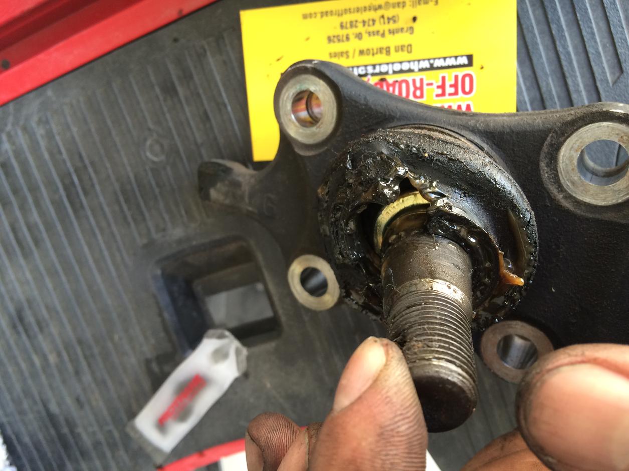

I just did mine and before i took the LBJ's off I felt absolutely zero play in either wheel. Once i took them off and inspected closer, I detected slop in one of the joints. In the end I am glad I did mine! Also both boots were torn and inside was filled with dirt.
