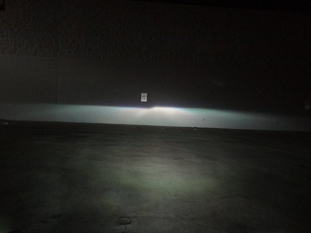

yeah sure
this is what my setup would be
projectors - infiniti-g37-s
bulbs - morimoto-xb35-d2s-
ballasts - first choice fast-bright-amp-ballasts
second choice (more expensive) morimoto-xb55-amp
and adapters for the bulbs to work with those ballasts - amp-d2s-ballast-adapter
the result
(this pic is from when I was working on the retrofit for my wife's prius - only one light on)
g37 - 55w by Roman G, on Flickr
