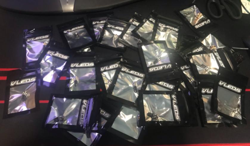

after reading a lot of negative reviews about the superbrightled's I decided to pony up the extra cash and get some VLED's instead. They are on the way so once they get here and I wire them up I'll post a review. Even with a 15% discount they were ~ 3x as much per bulb though. I've bought brake and reverse lights from them and they are amazing, but they are also priced significantly higher than just about anything else on the market, so I guess you get what you pay for.
Yep. Superbrightleds is Chinese garbage. They work, yes. But it's a gamble if they'll start flickering on you in 1-2yrs time. And they do not disperse light as a high quality bulb does.
Using an actual high quality bulb, like a Samsung, in the dash makes a massive difference. They're like $6 EACH though, which sucks.
