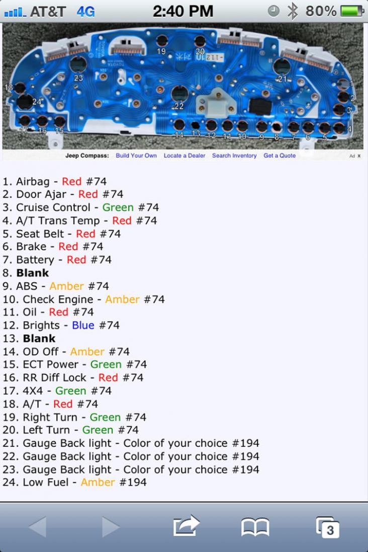

This oughta get you started.

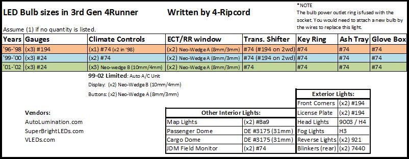

Are there any lights to replace for the Passenger Seatbelt Warning Lights and the Hazard Lights?
All the other lights came out awesome, (thanks OP) but the hazard being out has been driving me crazy. I spent the last hour or so scanning through this thread and a few others and it appears the hazard light is called NEO3-xHP LED Bulb on superbrightleds. Should be the same as on the rear window & ECT/defroster. I have 3 on order (screwed up the bulb on the ECT before so I'm going to get an extra just in case.)

Instrument Panel Gauge Dashboard Colored Led Bulbs Lights Lamps
Samsung #24 5630 6X
PCB Base: 8mm dia. x 19mm overall Base thickness = 1.6mm
Plastic Base: 8mm dia. x 25mm overall
270 degree beam angle
You'll need 3 for the instrument cluster.
Hoping a Samsung name brand quality bulb does better than the cheap ones. These feel and look much higher quality

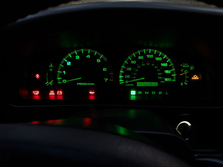

Green Gauges, Cool White Everything Else

These are the #24 bulbs from superbrightleds, they do hotspot a bit.
