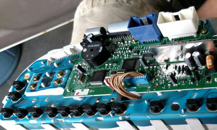

How do you get to the middle bulb in the gauge cluster? AFTER removing the screws that hold the board
I found it easiest to utilize the FPC connectors that are located above the black cylinder (pictured below). You will see two silver ribbon cables going into black terminals. Push down on one side of the terminal with a small screwdriver and gently pull up on the ribbon wire until they pull free. There are two of these, one larger than the other. Once free, and with the screws removed, you can hinge the board out of the way for access to the middle bulb. Reassembly is the inverse operation-- push the ribbon cable into the FPC connector and pull up on the half of the terminal to lock. Hope this helps.

Thank you for that. Impatience beat me and I got in there with some plyers, twisted it off and did the reverse to get in.

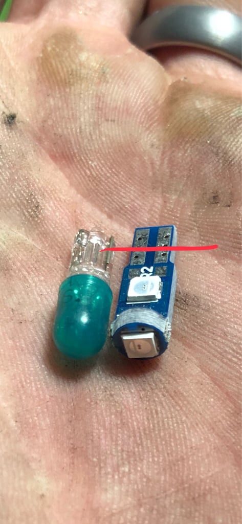

This is super sketchy, but I couldn't replace that bulb either. I was putting white LED's in my dash to brighten it up and get rid of that awful green. I realized that some bulbs just had a green plastic cap on them, so I busted out a blue sharpie and painted the bulb a few times, letting it dry in between. Put it back in and it's no longer a green or yellow light, but the same color as the rest of my white LED's and no one knows the difference but me (and now you lol). Worked great!

If you're using LED's they are polarity sensitive.
If the don't work try rotating it 180 degrees.

Thanks! I have light now. :cheers:
based on what you told me i decided to sharpie one side of the light so i know what direction i've already tried. I think i kept putting them in the wrong direction over and over :ybrick:
