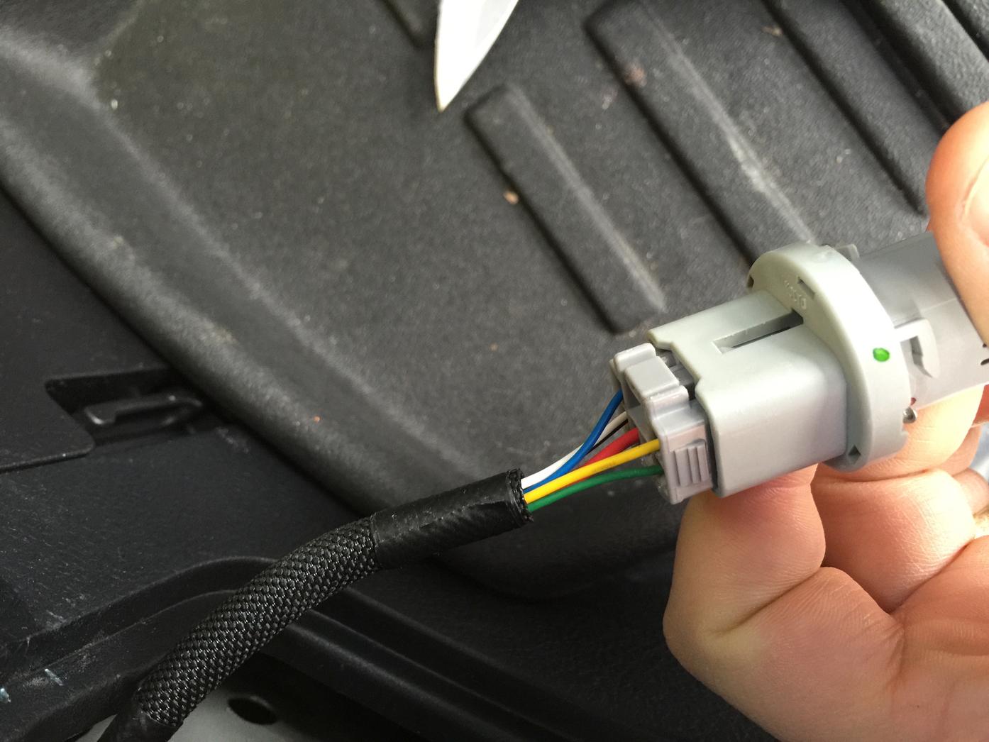

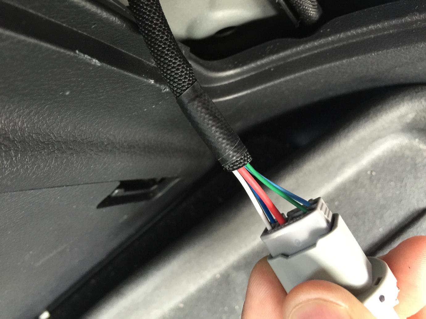

the plug on the 4Runner has 5 wires attached that's why I asked so I can see which wires to go after.
You're going to have to do both sides. I don't recall if the positive wires are the same on both sides. Hopefully you have a test light or a meter. It'll be easy from there. If you don't have one, its worth the investment especially if you ever plan to do ANYTHING electrical on your truck.
And four resistors if you're doing all four signals. I only did the front two in the ARB signal housings and got resistors from superbrightleds.com that have vampire taps. Just put the wires in and squeeze with a pair of pliers. Takes about 5 minutes to install both.
https://www.superbrightleds.com/moreinfo/flashers-load-resistors/marker-lamp-load-resistor/191/832/
I did same. Passenger side is blue for power and white with black line/dots is ground. Driver side is green power and white with black is ground. Took a min or two to put the resistors in.
