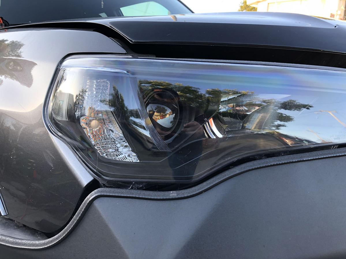

I'm running 7443 Lasfit in the 2014+ housing from the 2010-2013 DRL/turn wiring, 90075-60028 socket, and I'm overheating in DRL. They seem fine if just used as turns.
I also burned the sockets and sylvania halogen bulbs running the DRL function...
Would adding in load resistors help? Any other ideas?
pic for reference:

1. I don’t understand your DRL setup. Doesn’t your rig use the high beam bulb as the OEM DRL function? Did you change something? If you did, see below.
2. You cannot run these particular Lasfit LEDs constantly On. They are designed for occasional use as turn signals. They take a lot of current and are very bright. They incorporate “CANBUS” resistors across the 12v lines which prevent the hyperflash, but the whole bulb gets really hot after a while, even with their best effort to heat sink the bulb. They apparently incorporate a thermal fuse which opens up the resistor path when they get too hot and they go into a hyperflash mode. I notice this with mine if I put the emergency flashers On for several minutes.
From the Lasfit website:
“Since these bulbs built-in Intelligent Temperature Control, if you use for a long time (a few vehicles maybe 2-5 minutes, it depends on year/make/model and temperature) may happen hyper flash, please turn off and cool 1-2 minutes, they will work properly again.”
3. If your setup is getting too hot you are doing something wrong. Wrong bulb for the application.

Looking at your post again. If I understand this correctly you updated your 2010 SR5 with the headlight assembly from a 2014 model. If several different bulbs are overheating in your setup and burning or charring the socket, maybe you have a bad socket. Perhaps the bulb doesn’t fit in the socket correctly, and socket electrical contacts don’t grip the bulb contacts properly and it acts like a high resistance and overheats.
In fact, looking on the Olathe Toyota site, the front turn signal socket part number you listed (90075-60028) does not seem to be correct for the 2014 4R model or even the 2010 model. (That part number is meant for a Scion, Prius, or Tacoma). The site lists the part number for the 2014 4R to be 90075-60083. Not sure what the physical difference would be, maybe the gasket or how it threads and seats itself into the housing, providing some way to dissipate heat. Or maybe the contacts are positioned differently. Something to check into. Let us know how you resolve this, good luck.

The 90075-60083 socket does not fit the 2010-2013 harness
The 2010-2013 DRL/Turn utilizes the 1156NA

OK. I think this may be the problem. According to the thread you followed the 90075-60083 socket was used and modified:
“ The reason for this is the socket I used is not for a 4Runner. The 2014+ 4Runners use a 3-prong socket, and the previous models use a 2-prong socket. Rather than try to mess with re-wiring a perfectly good harness, I chose to just get a 2-prong socket and slightly modify it to fit.“
The 2014+ 4Runners use a 3-prong socket because they use a 7443 dual filament bulb. The low wattage filament is On when the stalk is switched to Park or headlights On. The high wattage filament is On when the turn signal switch is On (blinker relay controlled).
I suspect that since the mod is for a 2-wire system it was wired to use the high wattage filament prongs on the socket. I”m guessing that the way it works for you is that the bulb is On bright all the time (“DRL” mode). And when the turn signals blink the bulb output is bright-off-bright etc. If this is the case then you are running this Lasfit bulb constantly and it will get too hot for the socket.
As [MENTION=119582]Jeffy[/MENTION] recommended, try lower power LEDs that can run constantly. If you need to add resistors to prevent hyperflash, use high wattage ones and mount them on a metal surface. They will get quite warm if powered On all the time. Or go back to a standard 7443 incandescent bulb.
