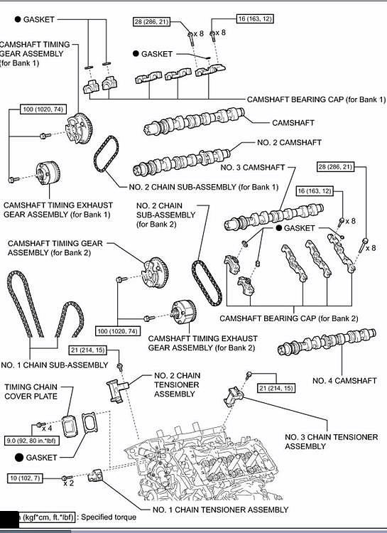

Maybe buy or find someone that has a Electronic Stethoscope: Automotive or Mechanic's Stethoscope to help pinpoint the noise to engine or transmission. These dual vvt-i engines do have 3 timing chains and 4 timing gears that will probably whine some with wear over time. That doesn't necessarily mean there is anything wrong with them though and they might whine as they loosen up with chain/ gear wear.
Definately get a stethoscope and check timing cover, valve covers, and externally visible pumps.
Only cams I have known to whine were all straight gear driven, and always whine. Usually when a timing chain tensioner wears out, you get a clacking noise at a certain RPM range.

Hmmm. If it were my truck, I would get a new timing chain and water pump installed. You are getting close to the mileage anyway and you are the definition of "severe duty" haha! The good thing about doing it now is:
1. You will see if either of these is the culprit
2. You can check other items closer while doing this service
3. You gotta do it anyway soon
The bad thing is cost. Bottom line though if you are hearing a whine that was not there before and you did not install a new custom cut differential, supercharger or blower then it's usually a warning sign! Good luck Ben and Scott!
