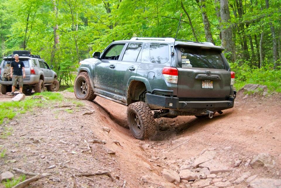

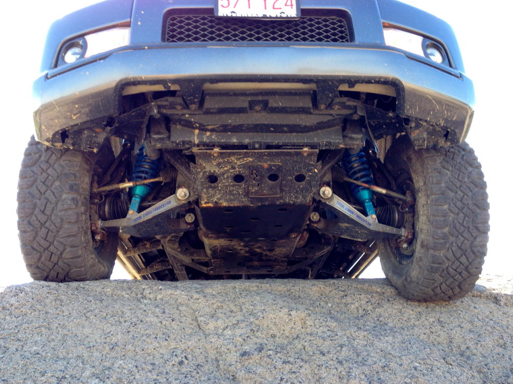

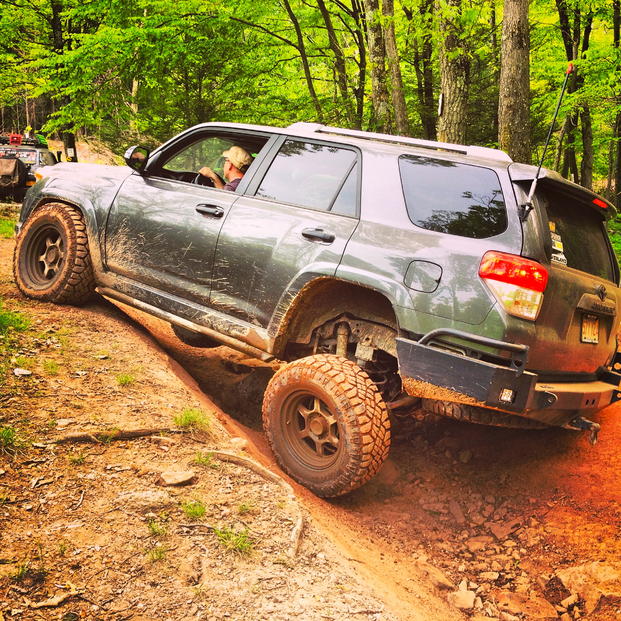

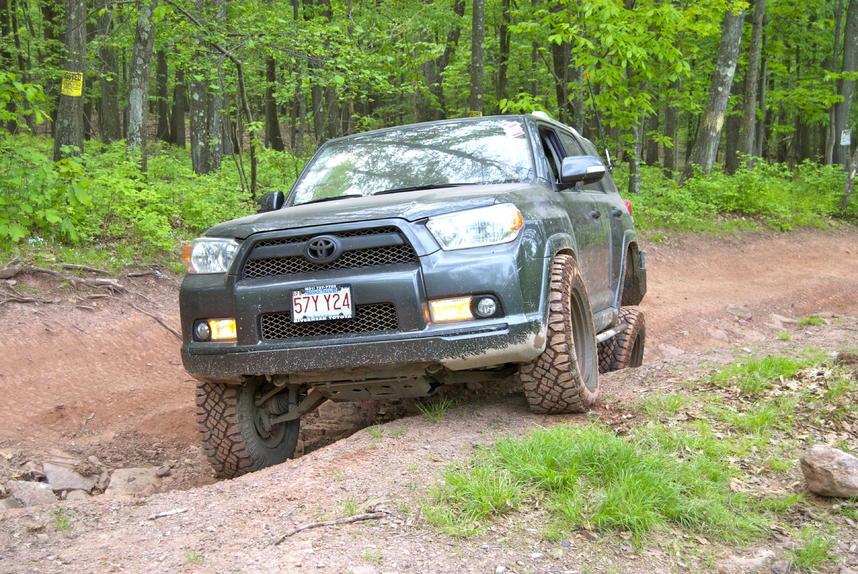

Right now I'm running the stock fenders with no cutting. The tire size is a 285/70/17. There's a small gap at almost full compression. My kit included a bump stop spacer but I have been looking at some real bump stops to replace these. Still need to put the cam tabs on but haven't had any issues without them yet. I will be cutting the fenders when the 35s go on. Been talking to one of my body guys about it. Here's some photos for those who haven't viewed my build thread.

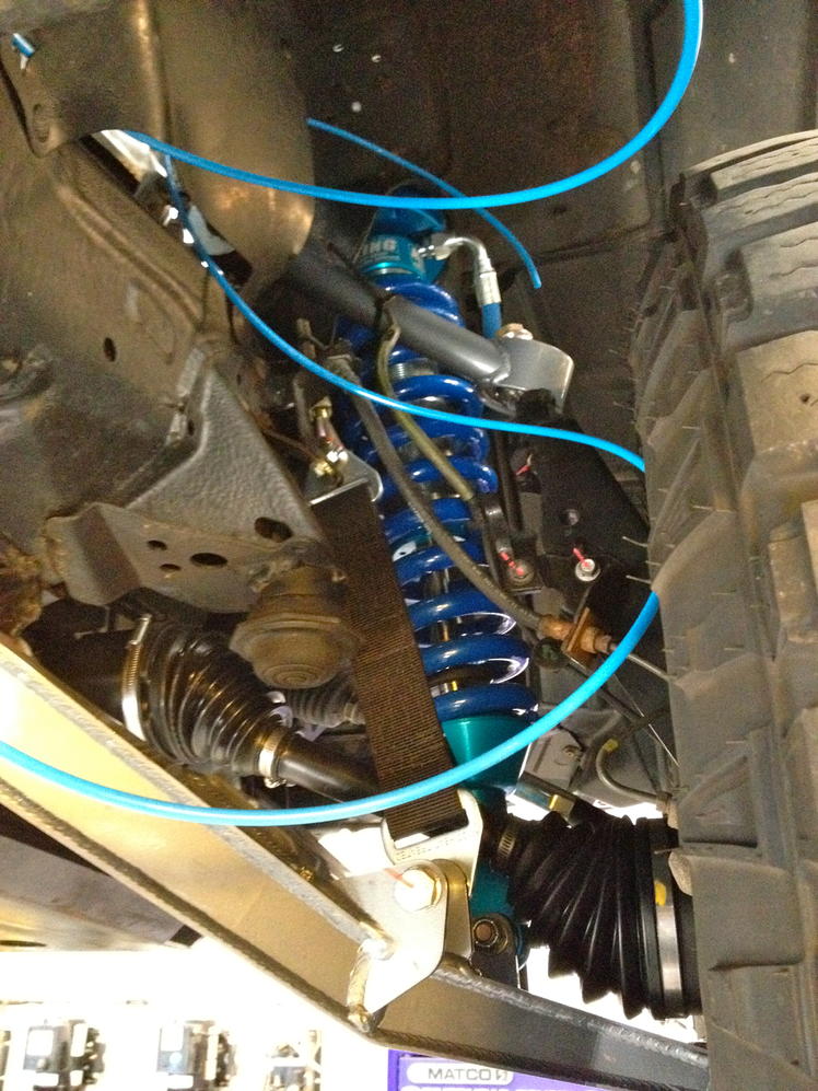

Limit straps are needed on an LT kit so your shocks don't over extend and destroy your axles (4wd application) or over extend the shock itself.

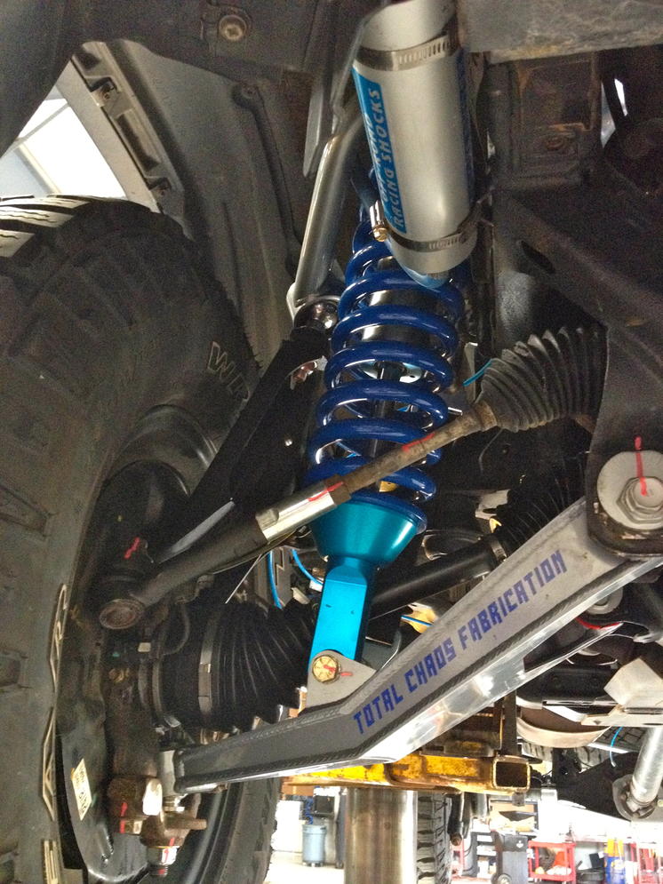

I have run MT setups and LT setups on a 2006 Tacoma and 2012 Tacoma. The front suspension concepts are the same. I ran a 3.5" TC kit with just a King coilover for years with great results. I added a bypass later to help absorb big hits at speed. I also crawled very well in the rocks with a 3.5" kit.
I recommend that you go with a TC 3.5" kit. I have run their kits on my last three trucks with great results. They have supported me and taught me a ton over the past 9 years that I have run their products. I recommend King but Icons are great as well. You don't need a bypass unless your going fast. Tailor your coilover valving and spring rate to your truck/driving style and enjoy!!
