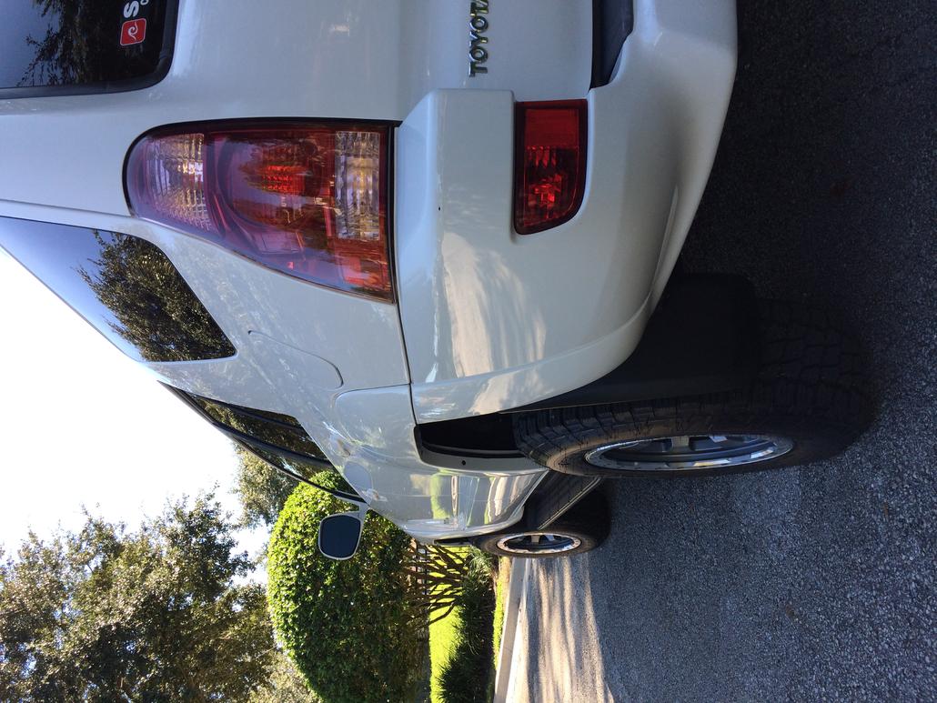

Just wanted to post some additional pics for those of you who are curious about how far out non-factory rims will stick out from the fenders. These are 265/70/17 Nitto TerraGrappler G2 tires on 17" x 9" AE Alloys 023 Series wheels. Offset is -5mm. Backspace is 4.75". These are installed on a 2005 T4R with ICON Stage I 3/2 lift.

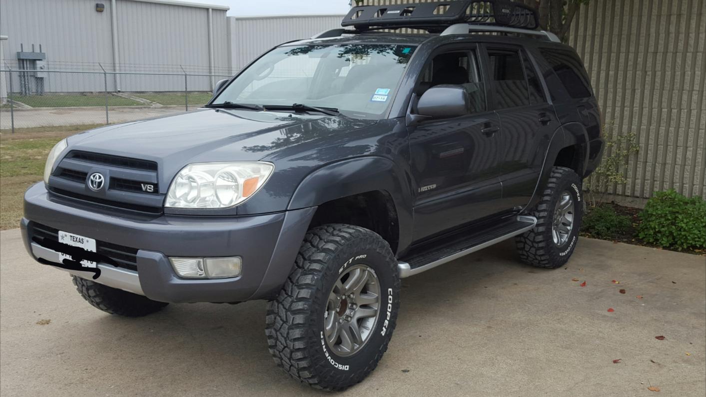

Wheels are 17x9 tires are 285/70/17 bfg ko2

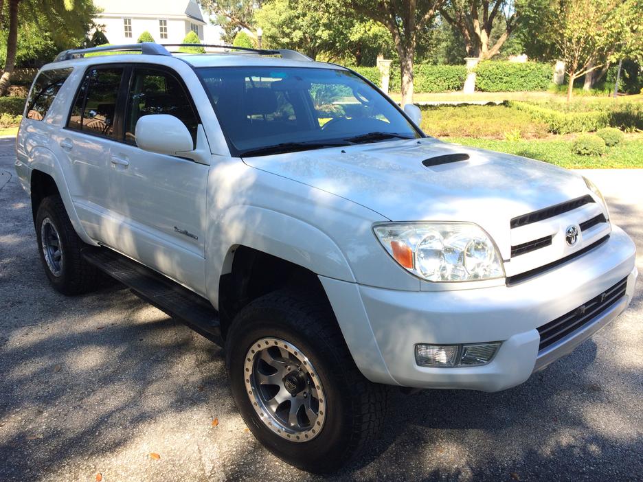

FJ springs front and rear, Daystar leveling kit, spidertraxx 1.25 front and rear, 275/70/17 Mickey Thompson Baja STZ (trimming required!) with Fuel offroad wheels. I LOVE IT!!!
What are your wheel offsets are those? What exactly did you trim? Removed the wheel well plastics or ? Thanks.
