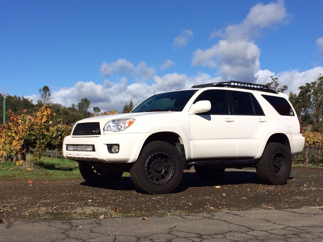

Toyo ATII Fox Racing 2.5 w/res
Toyo ATII 275/65-18 supporting front Fox Racing 2.5 adjustable with remotes, Icon tubular ucas. Rear Fox 2.5 with adj remotes OME 889-E 1.5" driver side 20mm spacer.

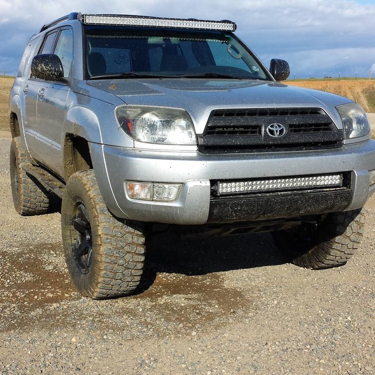

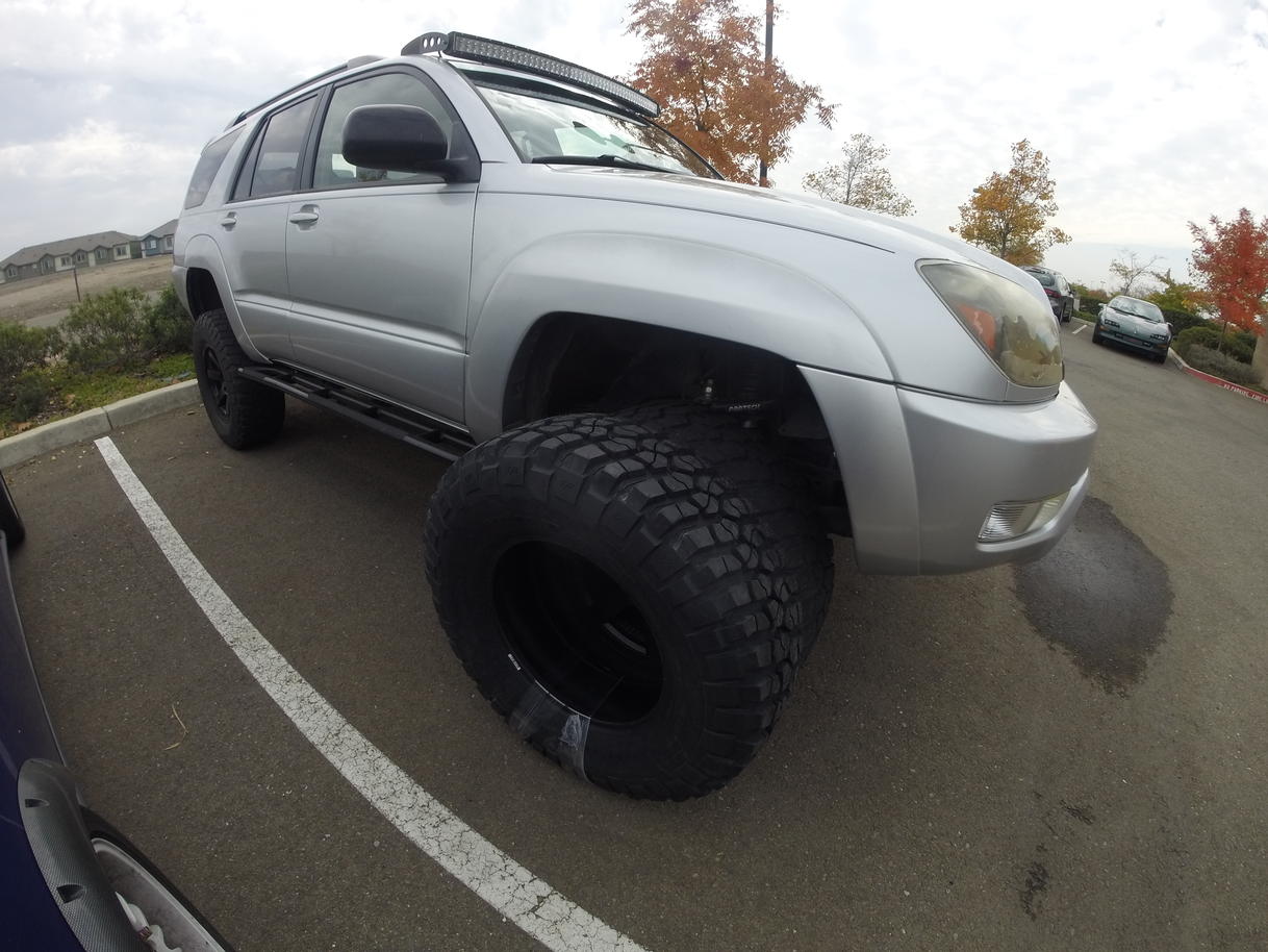

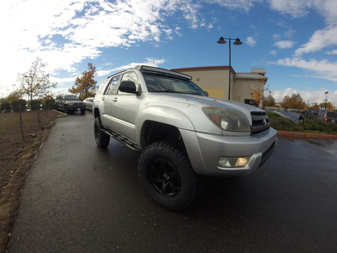

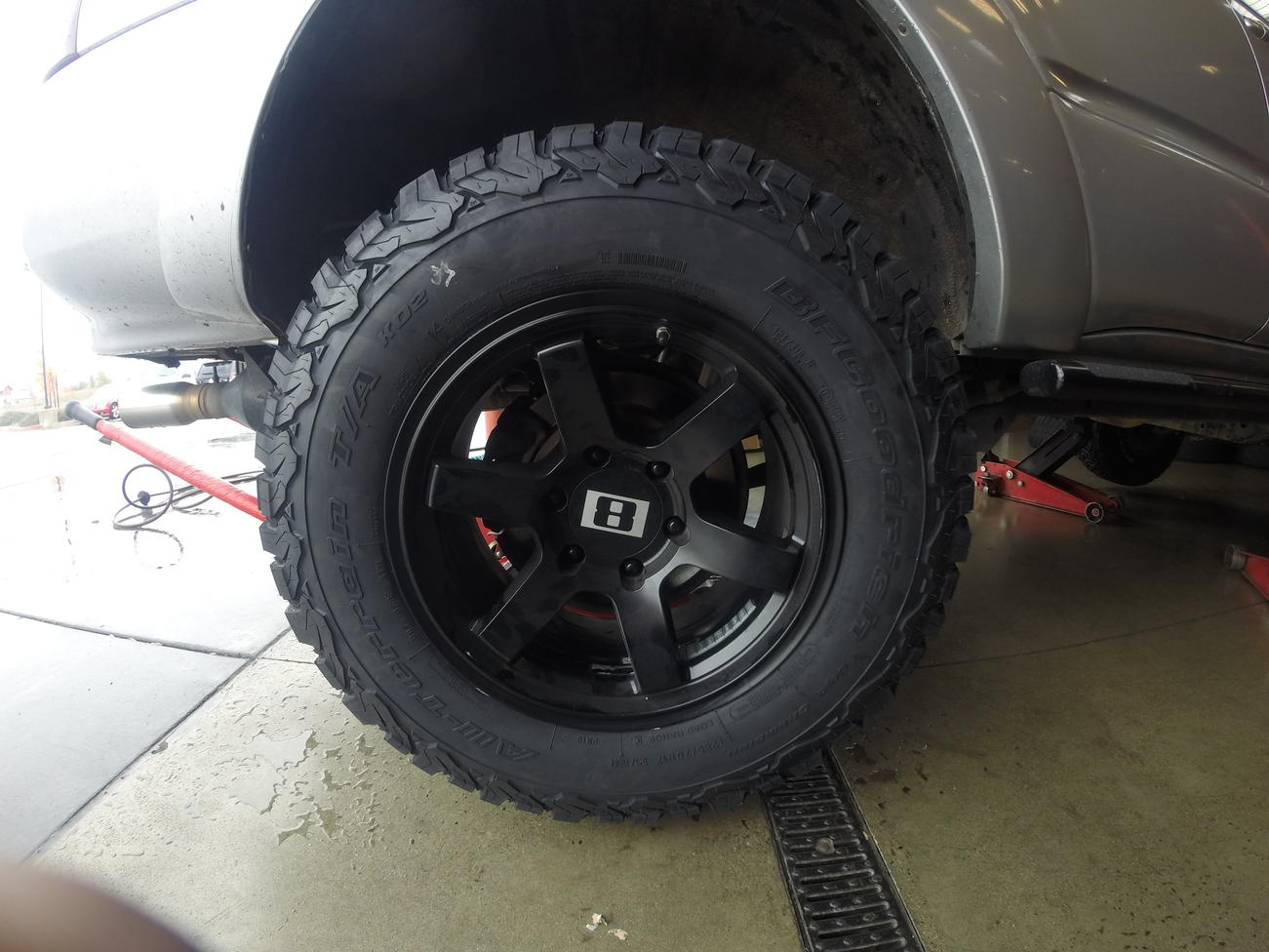

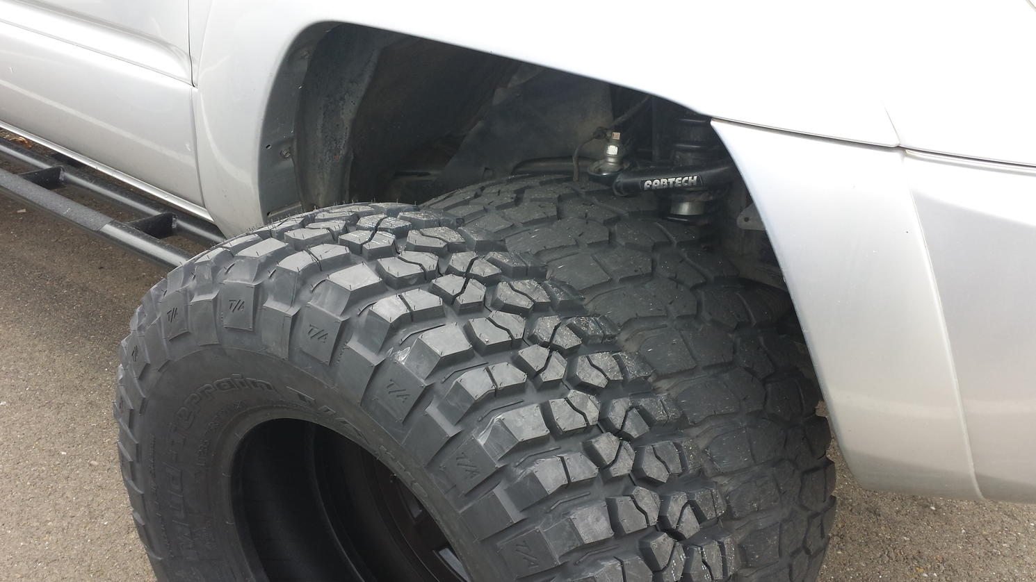

I just installed some KO2s in a 285/70-17. I took off 305/65-17 KM2s and was trying to fit 285/75-17 KM2s but they we're less then a 1/4" from my sliders so there is no way they would work. I already have the body mount chopped but the sliders are welded in 4 places down the Fram so they're there to stay. I'm not entirely sure I like the way it looks with 285s but they don't rub. The 1st pic is with the old tires, the two pics with the tires standing next to the truck are the 285/75-17. They looked fantastic on the rig, just weren't gonna work.
