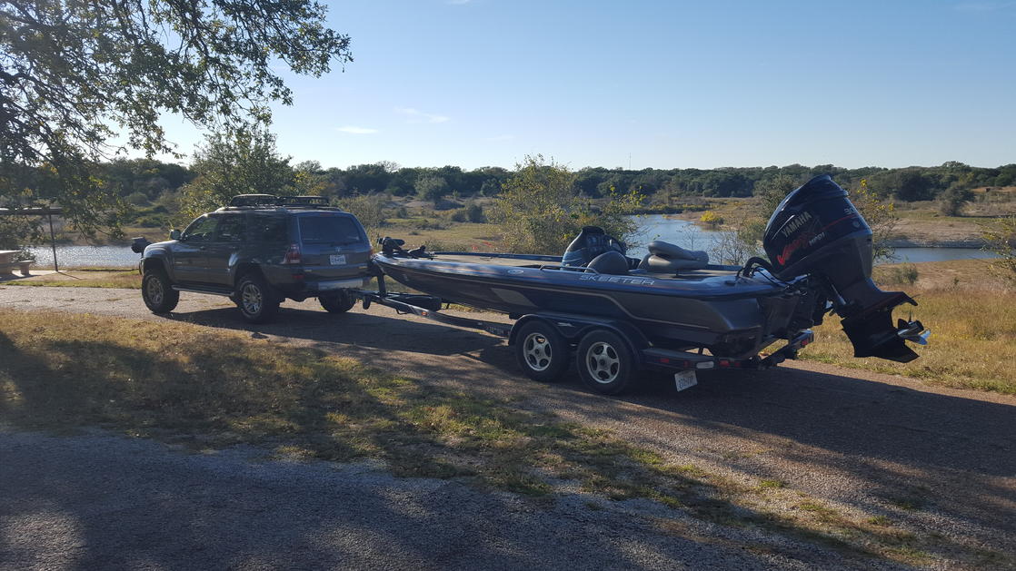

Front
Bilsteins 5100 set to .75'' of lift
Maxtrac 4'' lift spindles
Stock springs (because once I put the Toytech front springs on and had the 5100's set to 2.5'' of lift and then took it off the lift I had gained 12'' from where I started.)
Rear
Bilsteins 5100
2'' All-pro springs
I ended up with a ground to bottom of fender measurement of 40'' all the way around within a quarter of an inch.
Love the way it rides and sits now. Its a brand new truck!
Even with the boat on it the rear didn't sag hardly at all.
